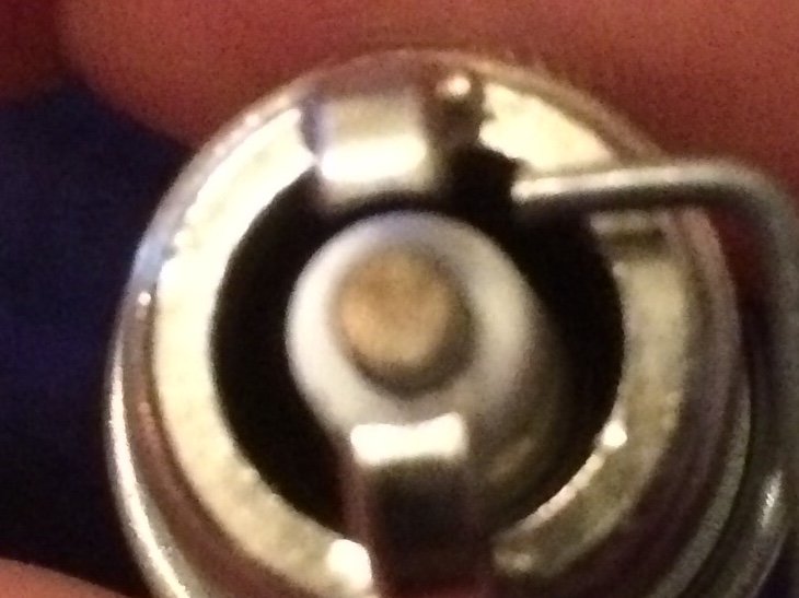

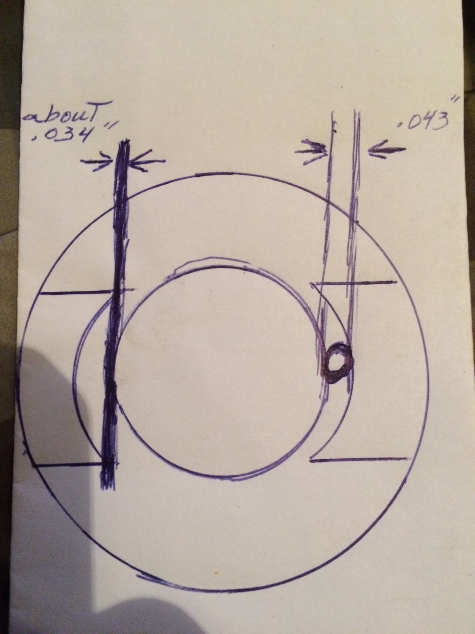

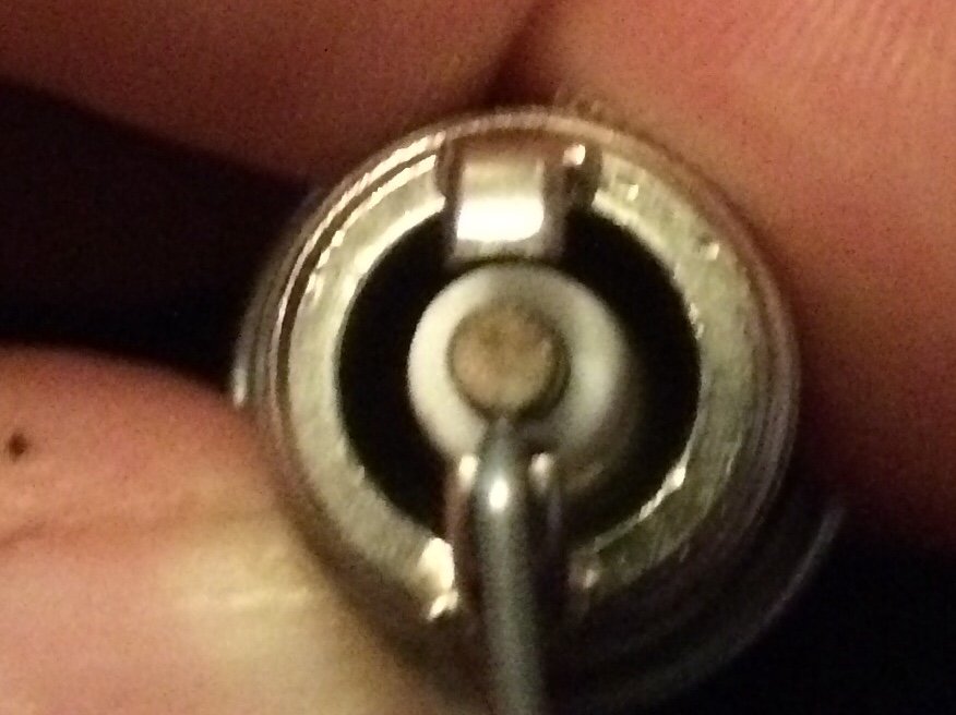

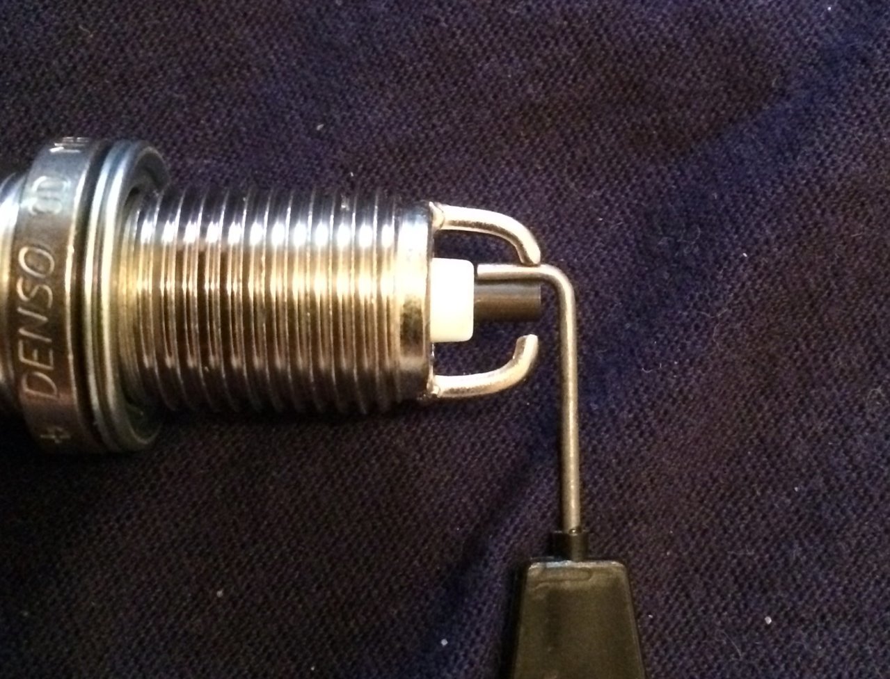

    On the subject of plug gap. I got into the habit of checking plug gaps when I was a kid on my gokart and my first car. I also look at plugs with a magnifying glass sometimes just to see if they have any imperfections like cracks or bad quality and no I don't have a pocket protector on my shirt. I've played around with side gapping spark plugs and heat ranges on some of my engines. Well I was just checking the gap on my plugs for the Tacoma and checked this forum for specs and saw all the to gap or not to gap and people seeing small gaps out of the box and yes mine looked small also. I took a look through my magnifying glass and noticed the side eletrodes are machined or cut to match the round center electrode. It was a huh check that out moment. So if you are running the Denso dual side electrode plugs you might just want to run them right out of the box unless you see something real obvious. I added a crewed drawing and some pictures of how you could get a different gap measuring straight across and not in the middle with a wire feeler gauge. DON"T USE THAT ROUND KEY CHAIN GAUGE !!! This forum has great info and great members and I hope this helps someone.

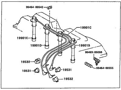

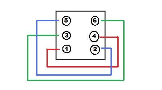

    Stupid question but why are there only 4 spark plug wires when there are 6 spark plugs?

    Are you looking at the 4cyl diagram?

    Hey Cutter
    I believe they are firing those coil packs twice which means that if it's firing number one on the compression stroke or power stroke it's firing number four on the exhaust stroke. I'm sure you know that all the coil packs are on the passenger side of the engine. It helps clean up emissions but if you have a bad coil pack you lose two cylinders and have one dirty running engine. I've noticed this engine is a lot like my old 82 Yamaha motorcycle. Four cylinders two coils and if you look at the valve adjustment they use valve shims like my Yamaha a total motorcycle thing. So that's my thought and I hope it helps.

    Spark plug gap spec = 0.043
    Most spark plug wire vapored only have 0.040
    Is that “good enough?” I figure the 0.003” difference is probably somewhere in the tolerance range of the tool or electrode itself.
    Or better yet does anyone know where to get a wire gap tool with 0.043? @scocar has one (saw a pic of it in a thread somewhere) but he has no idea where he got it from :)

    Correct, I have no idea where I got it from.
    I just searched the F out of it 15 different ways and the closest I ever saw was .044, but I think it was for the wire hoop type, not the L type.
    I found a Denso too in the UK, but it didn't' even provide the spec on it!
    So I say use the L types that are easier to find with .040 and that is close enough.

    Oh man, I'm so glad to see this info. I discovered this same exact thing yesterday, when I got curious about whether or not the plugs i got from my local dealer were, in fact, pre-gapped. The round gauge was producing numbers that I didn't like, and long story short after looking at how the dual ground was shaped, I ended up at Oreilly's for a different style of gauge. Issue solved! So nice to have my pocket-protector-wearing journey into spark plug gapping confirmed by your post. And so glad you posted this here, to finally bring some clarity about The Great Gapping Dilemma to this awesome thread, even if it did take 8 pages to get there, hahaha! Nice work. :cheers:
