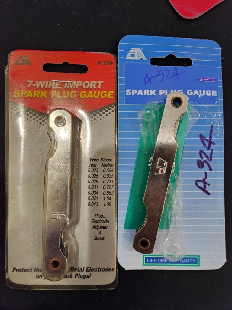

    These 2 tools will get you every spark plug gap out there. These are the wire type required for double ground plugs. The one with 1st gen specs is CTA A329, just search that on ebay. The seller Barry has a nice stock of vintage tools.
    EDIT: after using these and checking them with calipers they are not that accurate and some wires were oval shaped. The one I needed 0.043" was closer to 0.044 so i just made it a snug fit when gapping the spark plugs.
