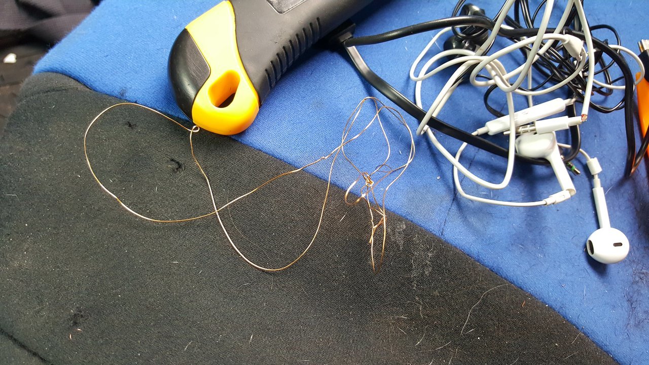

    Ha, I ended up using this Xmas decoration wire I found lying around in my ex wife house. The twist tie was too springy.

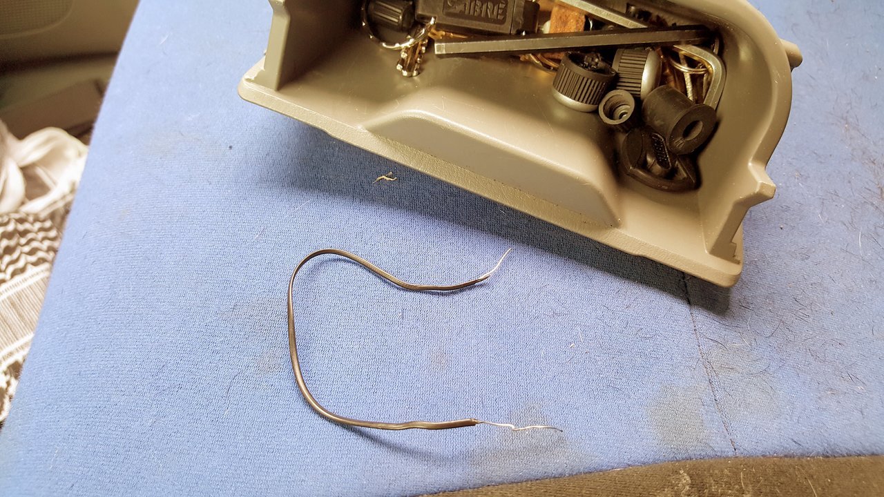

    My VSC light stayed on after the procedure, so I went through the steps again, this time very carefully. I used an alligator clip jumper wire. I cut it in half and stripped a half inch off, then taped the ends into/onto the slots to make sure they didn't lose contact during the process. This made it easier to observe the dashboard. Now the VSC light is no longer on. Success!! I think before I jostled the truck or it wasn't perfectly level, or one of my connections at the OBD wasnt good. Either way, it appears to have worked this time.:):):)20180213_172326.jpg 20180213_172932.jpg
