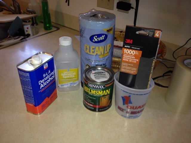

    Things you'll need.
    1 roll of scotts blue paper towel.
    Wet Sand paper- I used 3m 800,1000 and 2000.

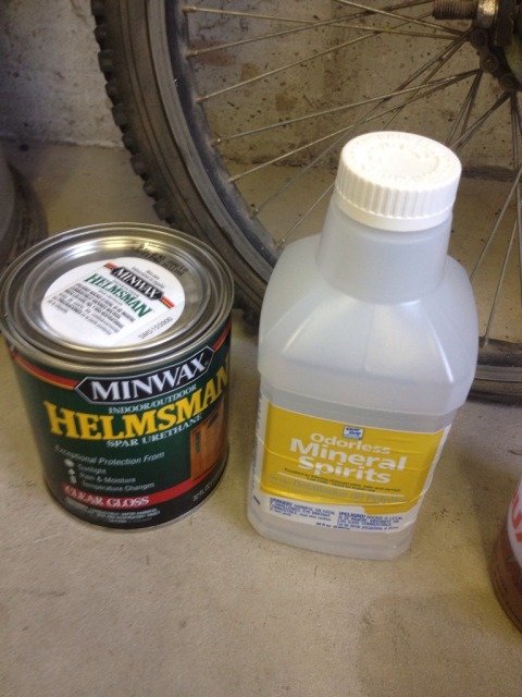

    Helmsman gloss spar urethane.
    Mineral spirits.
    Mixing cup and stick.
    Denatured Alcohol.
    Rubbing compound.
    some sort of soft pad for a drill or polisher.

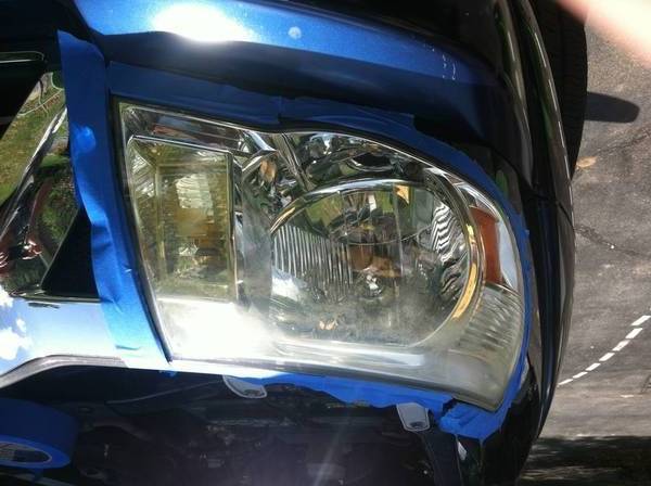

    1- Masking off your fenders and bumper. I pulled my grille out and took the spacers between the headlight and bumper out.
    2- Wet Sand your headlight to remove the oxidation. I started with 800 grit and worked my way up to 2000 grit.

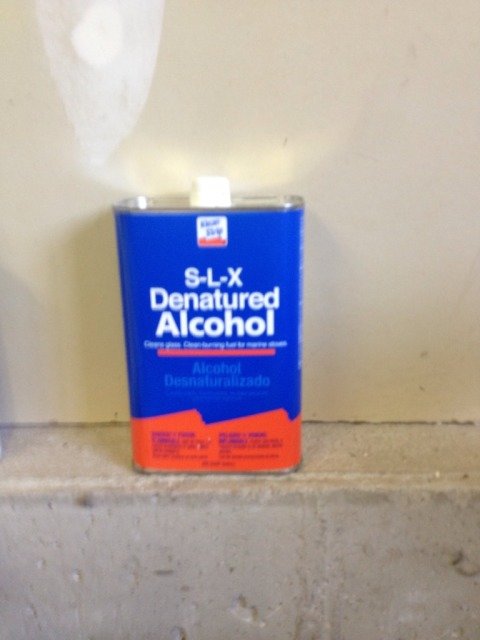

    4- When your headlight is polished as good as you can get it. Then use Denatured Alcohol to remove all the leftover rubbing compound.
    This is what I used.
    5-Now you'll want to mix up your UV clear coat. Its a 50/50 mix. I used a cheap Walmart mixing cup. I mixed 4oz of spar and 4oz of mineral spirits. (This is way more than you'll need)

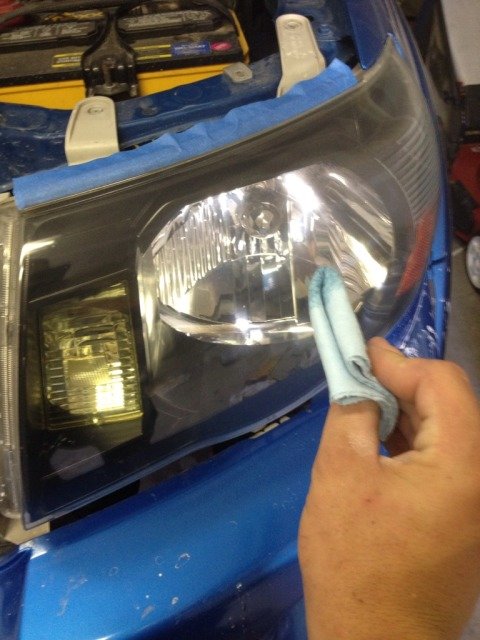

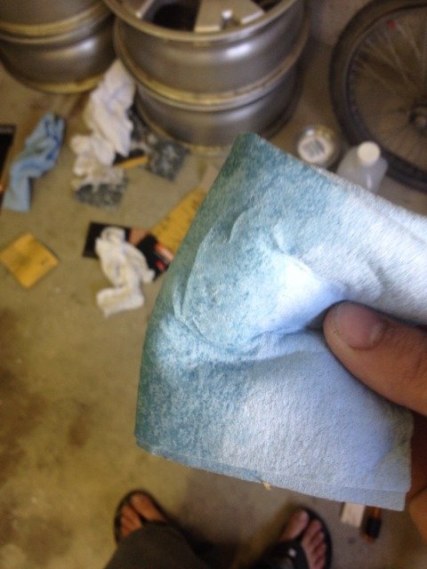

    6- Once your clear is mixed take two sheets of scotts blue paper towel and fold it to look like this. This will be your clear applicator.
    7- Then dip it in your clear and apply in a back and forth motion from top to bottom. No need for a ton of clear as it will run.
    8- After you applied your clear let it dry for 20-30 minutes before reassemble/removing masking tape.
    The pictures dont do justice. They look almost as if they came from the factory.

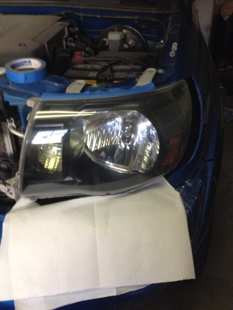

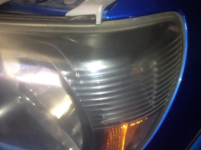

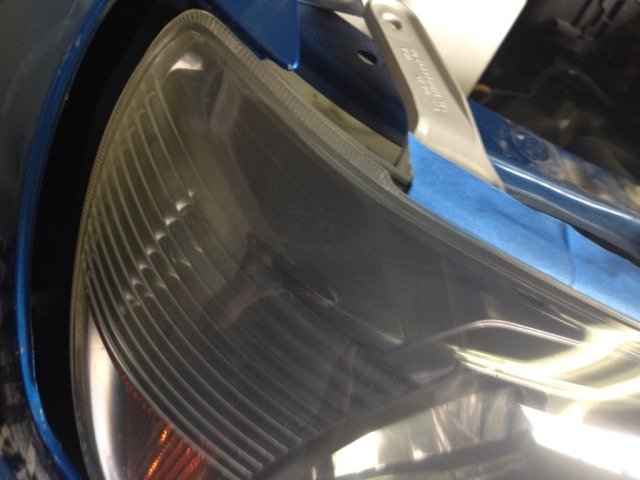

    Before.

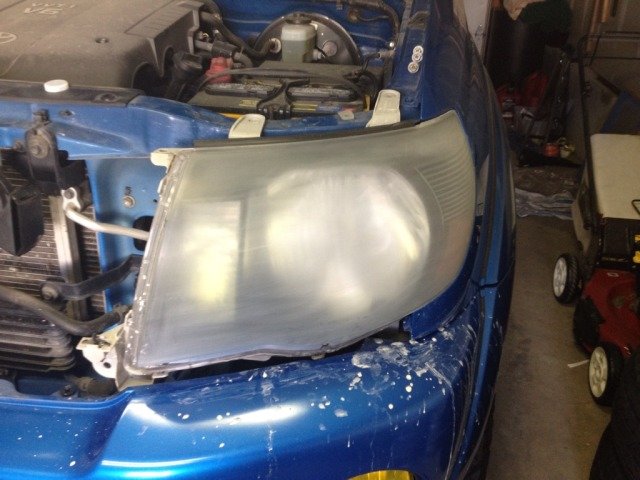

    After.
    Good Luck and don't be afraid to post your results.

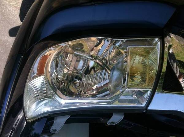

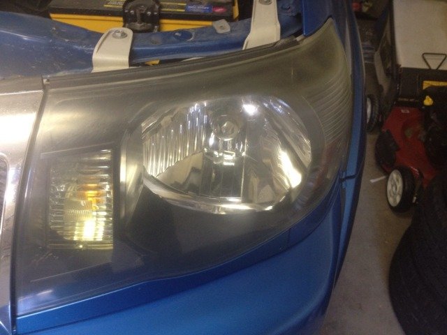

    I did this as well. It works really well. Went all the way up to 3000 grit and wetsanded with each grit # of sand paper. Also I used a foam applicator instead of a blue rag.
    Before
    After

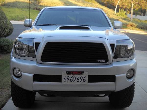

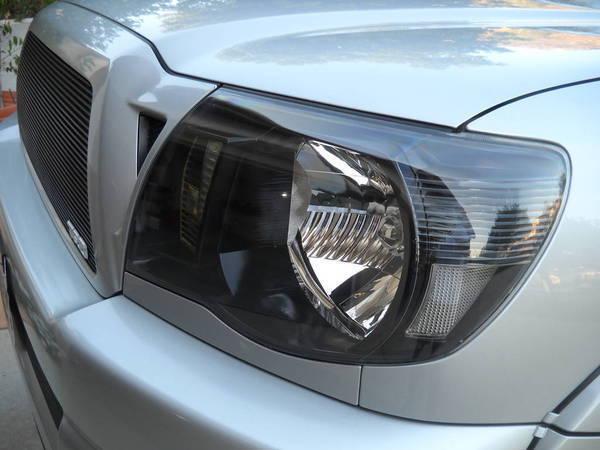

    So had a extra set of headlights I bought last year from another local TW member that I did the bhlm on and had not put back together as I was planning on a retro when I had the $...never did the retro so I slapped em back together and did this restore this past weekend. Could not believe the results!:eek: Super easy and they look brand new. Hope the finish will last. Pics.........
    Before:
    After:
