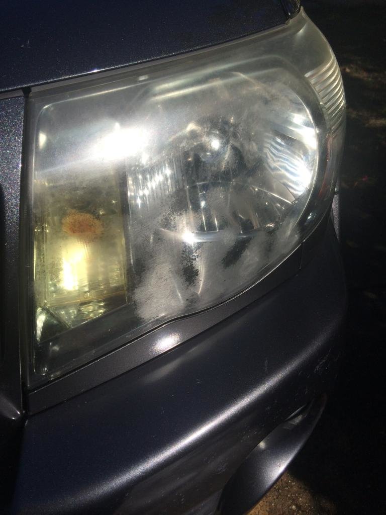

    Not going to be easy to wipe away the runs... :spy:
    but seriously, you may need to wait for it to dry and repeat the process only you could start w/ a 2 or 3k grit wetsanding. No need to redo the whole process.

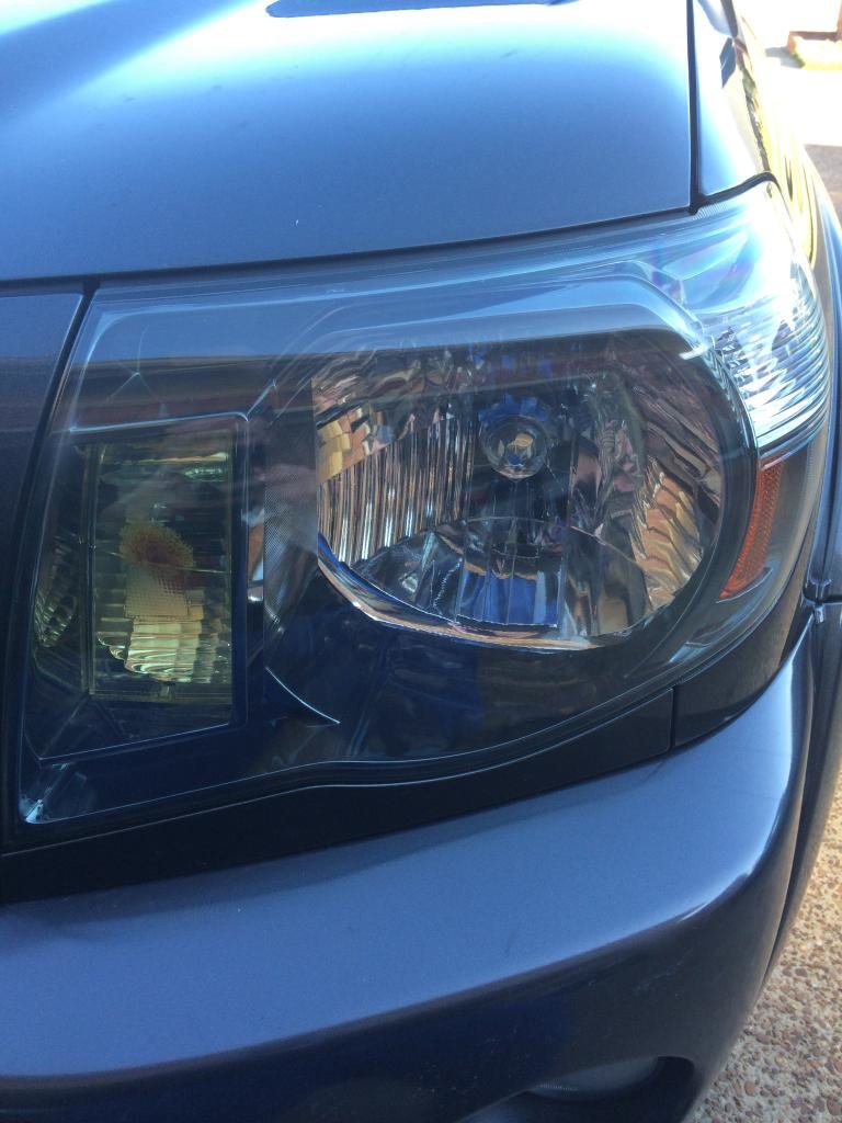

    I have tried all sorts of the stuff they sell at the auto parts store to restore headlights, and all of them have fogged and yellowed within a month or two, even with using a UV protectant. I tried this DIY this past week, and I have to say, the initial results are promising. The headlights appear perfectly clear...it really is the best of everything I have tried. I will update as time progresses and add pics when I get some! Definitely recommend!

    So here is my update...I started to see the top coat getting a little darker after about a year and a half. I just wet sanded them with 3000 and reapplied the top coat again. Super simple and they look brand new again. Totally worth doing this mod in my book. As for putting a coat on brand new head lights... I would just wait until they get bad to the point it bothers you and do this mod then.
