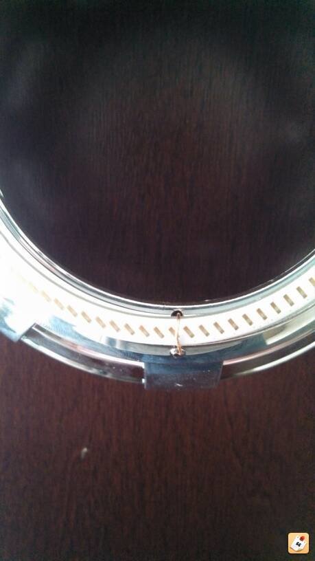

    Well right now I used copper wire as a Mach up but I don't think the copper could handle the heat well (waiting to get some .020 steel wire) drilling was a pain for me. Don't have the best drill and the smallest bit I had broke and scratched the shroud but its getting painted so I'm not really worried and that's what I was thinking and having the shroud side with wires down. So it'll be hard to see

    Gives you an idea of what I did
    I also thought about cutting the wires and drilling just a big enough hole to out the wires thru

    Well I can tell you IMO I don't trust silicone with the heat from the projector. Well I got my cooper from my job (af aircraft mechanic) but I know hobby lobby has hanging wire that thin. Or any hobby store. I plan on using steel wire tho

    Ya I can understand that but I'd be happier knowing its held in there tight with some steel.

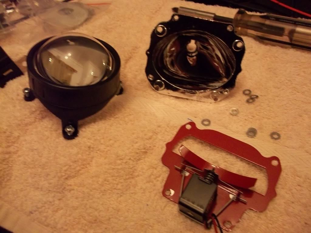

    Its a start at least. Tomorrow I'll be getting the paint for the demon eye. These the three parts to paintrujybyne_a43fef0dade9559fe4ac40729d1827a4ea37981e.jpg

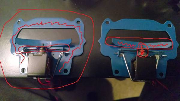

    I don't think you want to paint the actual shield on the right, I might be wrong though. I think I read it messes up the cutoff. Leave it that color and paint the piece on the bottom left for sure

    Ya Asian Ant sent me a pic and it had 2 of the 3 pieces he paints. Idk either.lol

    Yeah, I was curious about this. Ant sent me this in a PM that we were talking about demon eyes
    The original image was from HIDP and he circled what else to paint for the best demon eye

    Honestly I'd just paint the whole shield so you don't have to worry about it. It's what a lot of people do over at hidplanet... I'm painting mine black because it gives off a smoked black look and supposedly improves the cutoff line as well as reduces the rainbow effect.
    http://www.hidplanet.com/forums/showthread.php?33357-cutoff-shield-painting
    This is what painting the whole thing red makes it look like
