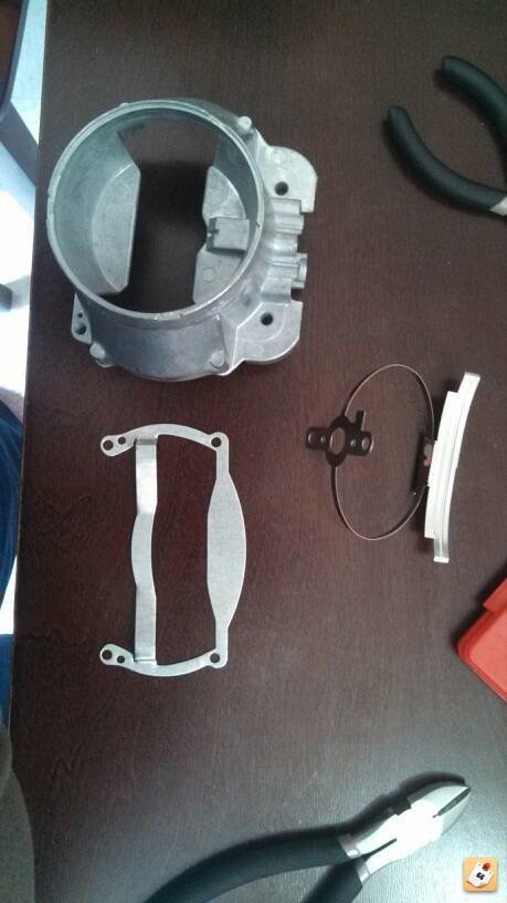

    I believe the VHT stuff doesn't require a primer. That's what I'm using, rated to 2000 degrees.
    What do you guys think about painting the spring and plunger too? Ant said it's a good idea because you can see that stuff through the lens and I agree - I think I'm gonna tape off the sides of the solenoid, paint the front and the spring and plunger and maybe activate it a few times while the paint is drying to prevent sticking. very light coats of course

    You only see it at certain angles. Paint flakes from the moving spring and plunger could cause your beams to stick. I do not advise.

    So your opinion would be what's in the picturey2yjy9ep_0a306edd259399632a9dcfc5b5d24d46bfb7ddd0.jpg

    True. Maybe I'll paint a piece of foil and put it on the front of the solenoid

    yeah im definitely gonna cut/resplice and use the existing holes in the shroud, use some heat shrink to make the exposed part black to match.
    painting the shields voids the warranty so im a little nervous to do it
