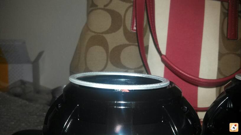

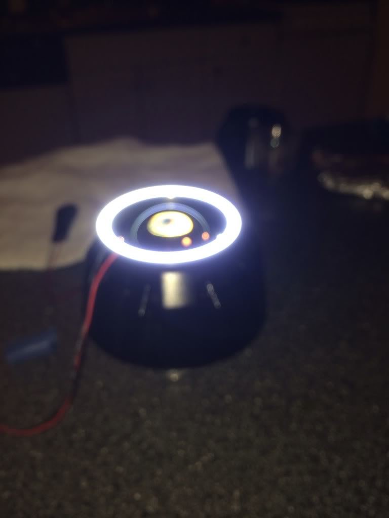

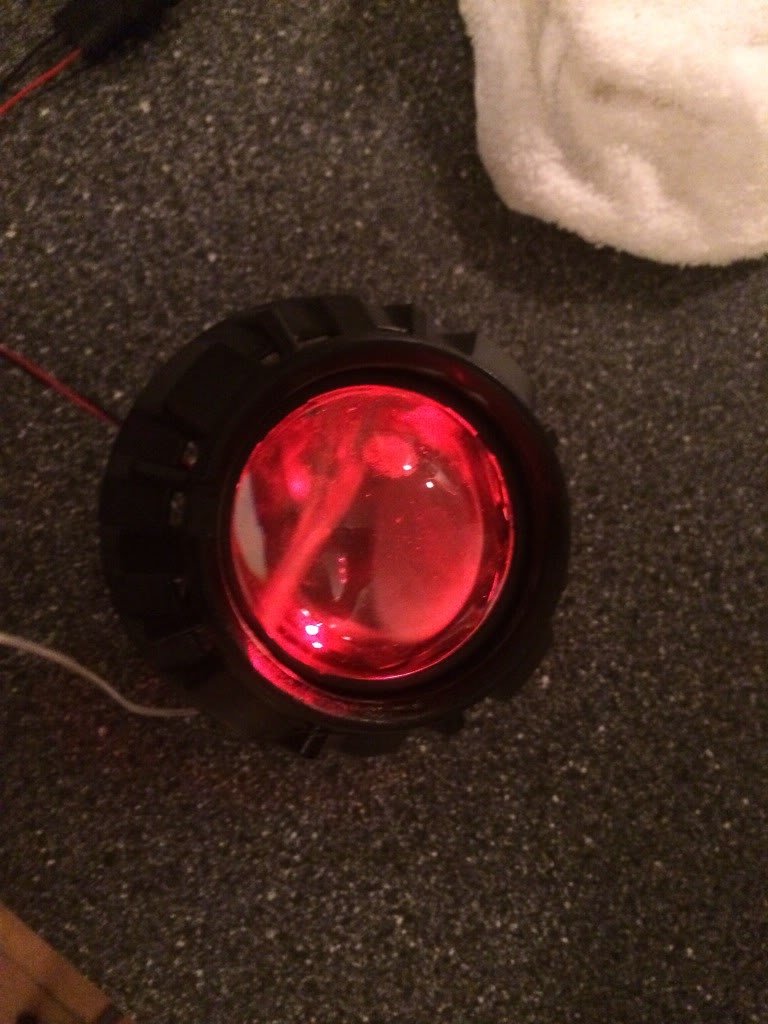

    Painted the shrouds today, used bleach to strip the chrome off and it worked pretty well. Painted a bezel too
    Mocked up demon eyes with 3 LED SMD strips and will likely paint the shields red as well.
    442D4585-51F5-4C92-99D3-54383F59119A-152_e1be0c53448e5a39c85259d6f730c1870a135d8c.jpg
    Halo mock up:
    AEF16BF4-6437-4EBF-A427-A2EEDCE4FD9D-152_07601180cbfebe2d8aec59468518b230992f3df3.jpg

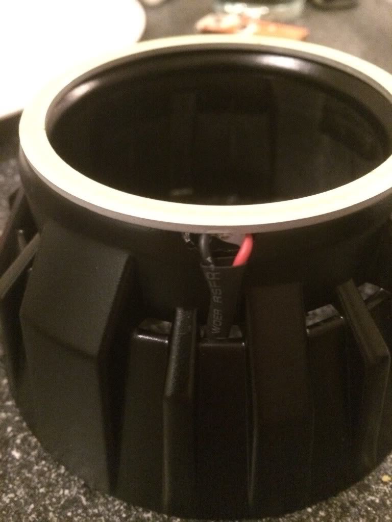

    Here's how I mounted the halo. So what I did was push the wires out of the clip and push the wire through an existing hole on the gattling 2.o shroud, then used some heat shrink over the wires of the halo to keep them together

    Yeah!! Pics!!
    I think I'm just gonna do silicone. I don't like the wire.... I have thin floral wire I was gonna use but IDK, silicone is so much easier and will hold better

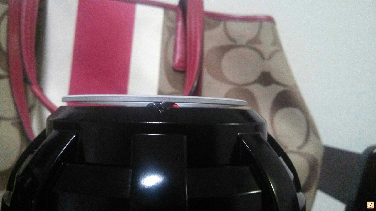

    I notched the shroud so the halo will sit level
