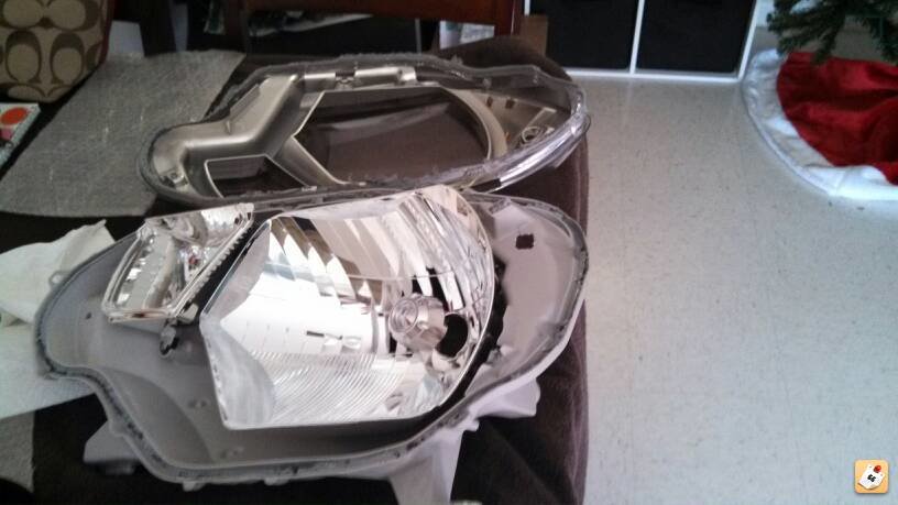

    Ya your telling meusu2enyd_dcab2fd8e67ebfac888f82d3738e66ea25d3628b.jpgone down!!!

    Once the wires are installed, you will barely notice them.
    Wire > Epoxy > Silicone (don't recommend...)
    Also epoxy or silicone will eat away at any of your paint that is solvent based (spray paint) FYI

    The only thing that worries me is if I use fishing line could it melt? I have some thing metal wire I could use but would prefer not to.
