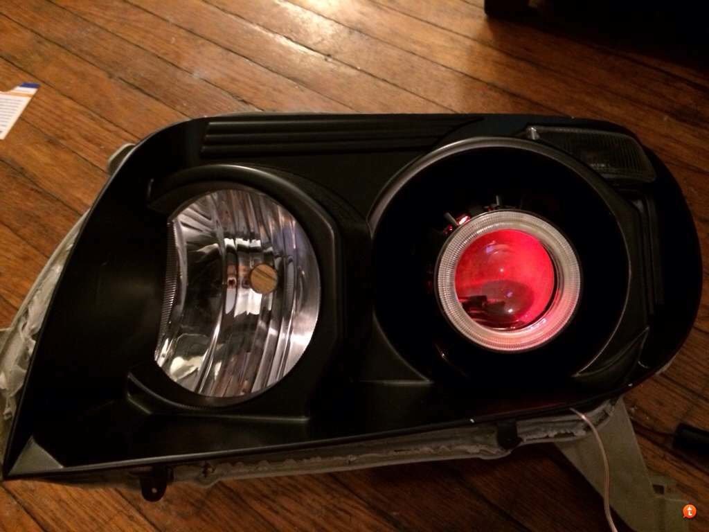

  17. Jan 31, 2014 at 4:35 PM
    #377
    zopperman
    zopperman LED & HID positive
    Sep 15, 2013
    #112511
    2,321
    Zak
    Arlington, VA
    03 4Runner
    Lift, 32" Duratracs, sliders, LED light bar, interior LEDs, sweet tunes & sub, OBA, sliders, TRD 16" 6 spoke wheels, CB, HID spotlights, electrical mods, etc.
    Color matching the shrouds right now. Decided too much black yrabe5ar_1a5ecb35d7f9ada758b570cd376a522a8a737237.jpg
  18. Jan 31, 2014 at 4:45 PM
    #378
    tacodane
    tacodane The Slow But Getting Somewhere Build
    May 25, 2013
    #104898
    4,902
    Dane
    2013 Tacoma Prerunner SR5
    Led Interior Lights AFE CAI Stage II, Aero Turbine 2525 Muffler Snugtop Cab-Hi shell TRS Retrofitted Headlights
    Do you have an LED in side the projector?
  19. Jan 31, 2014 at 5:45 PM
    #379
    zopperman
    Sep 15, 2013
    #112511
    2,321
    Zak
    Arlington, VA
    03 4Runner
    Yeah. Gonna tweak it a little
  20. Jan 31, 2014 at 5:50 PM
    #380
    tacodane
    May 25, 2013
    #104898
    4,902
    Dane
    Hope the heat from the projector doesn't burn it out on you
