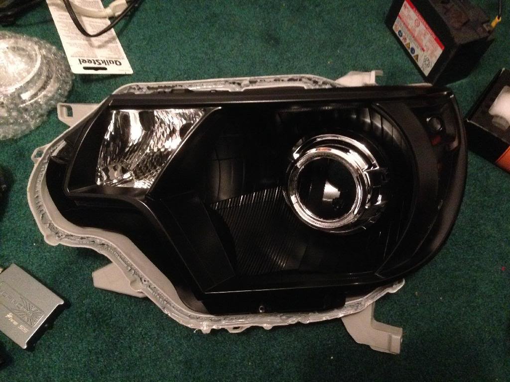

    Got em!! Time to unbox!!!
    Oh yesssss
    8E38C94A-00E8-4950-A702-71C1B6890CA2_zps_42d7d709f99ba5b4f172b80d8e095959997c1b74.jpg

    Cut the holes for the FXRs last night, they came out perfect until I realized I cut the notch for the solenoid at the top and not the bottom! LOL
    It's ok, dremel out another hole and the shroud still covers both of them, no biggie. Lesson learned, mark the top of the reflector like TRS said to

    There was a square on the back (pointed towards the top) and I was like whoah it's like it's made so its marked for the solenoid! Of course not paying attention to the way the light was facing.
    I'll admit, I was in a hurry because I was excited. Next time I will take the advice of TRS and mark the top of the reflector "top"
