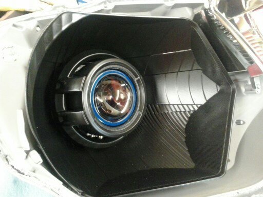

  15. Jun 2, 2014 at 9:27 AM
    #415
    WILLIAM ROBERT
    WILLIAM ROBERT Well-Known Member
    Mar 28, 2010
    #34148
    90
    Edmonton
    it's blue
    when I had the lens retainer off, to do the demon eyes, I also gave the retainer a couple of coats of paint. A nice little touch IMHO.
  16. Jun 2, 2014 at 9:28 AM
    #416
    braik
    braik Well-Known Member
    Oct 29, 2013
    #115472
    619
    Louisville, KY
    2006 4.0L 4x4 BASE
    2" Ironman 4x4 (B) Front Spacer Level LR UCAs Level 8: Tracker Wheels 255/75 Cooper ATPs Welded Rock Sliders Weathertech floormats Wet Okole seat covers JVC Head Unit Diff Breather Mod Zip Tie Mod Needle Bearing Mod HID Retrofit (Acura TL-R)
    How could anyone see it? It sits behind the shroud.
  17. Jun 2, 2014 at 9:29 AM
    #417
    tacodane
    tacodane The Slow But Getting Somewhere Build
    May 25, 2013
    #104898
    4,902
    Dane
    2013 Tacoma Prerunner SR5
    Led Interior Lights AFE CAI Stage II, Aero Turbine 2525 Muffler Snugtop Cab-Hi shell TRS Retrofitted Headlights
    No one can see it. The shroud covers the entire thing
  18. Jun 2, 2014 at 9:33 AM
    #418
    WILLIAM ROBERT
    Mar 28, 2010
    #34148
    90
    Edmonton
    it's blue
    this is what I mean.
  19. Jun 2, 2014 at 9:33 AM
    #419
    InSight Retrofits
    InSight Retrofits [OP] Closed
    Sep 17, 2013
    #112687
    1,260
  20. Jun 2, 2014 at 9:34 AM
    #420
    braik
    Oct 29, 2013
    #115472
    619
    Louisville, KY
    2006 4.0L 4x4 BASE
    Maybe yours is different. My shroud covers everything but the glass.
