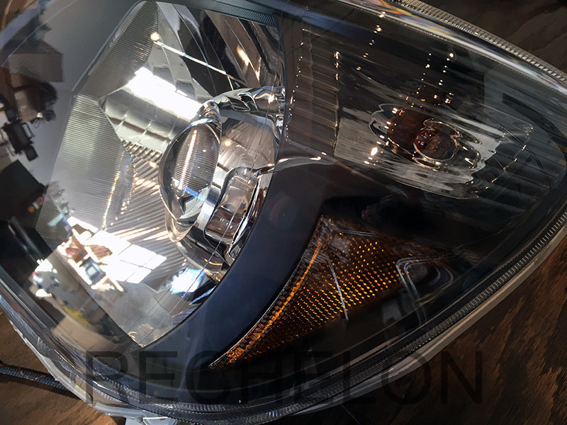

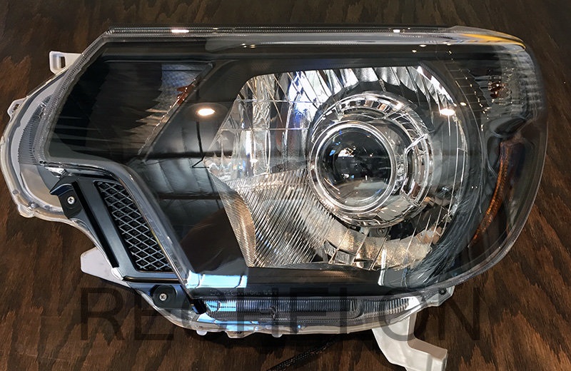

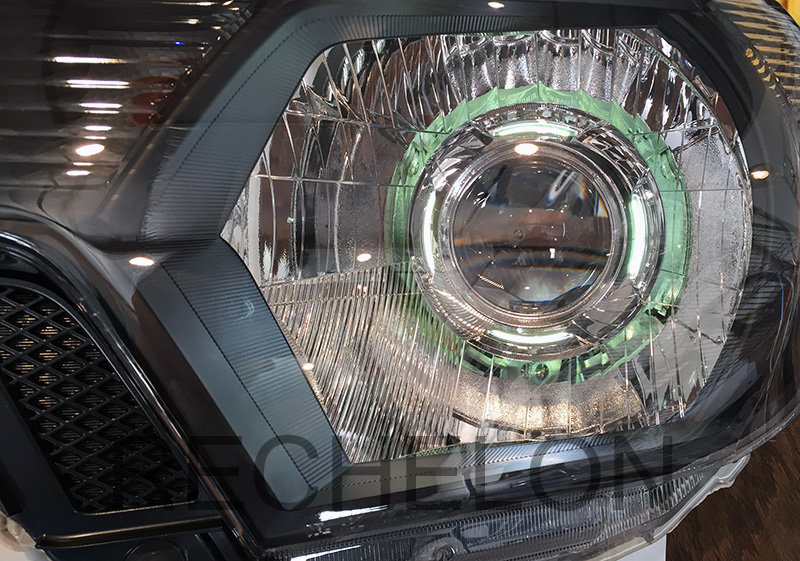

    Upsblaine - Rechtin black bezels (satin black bezel with black chrome corner), Apollo 2.0 shroud with white halo rear mounted, chrome main bowl, "black chrome" DTRL reflector, smoked orange reflector
