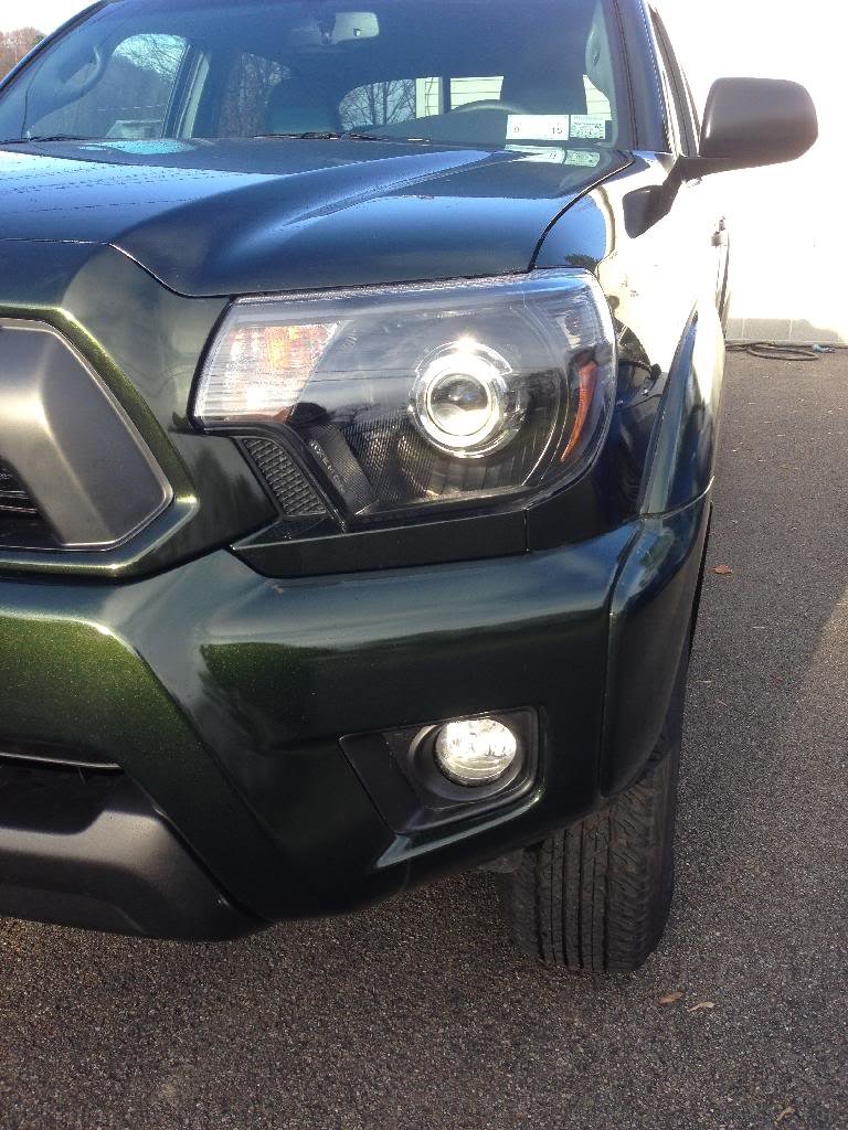

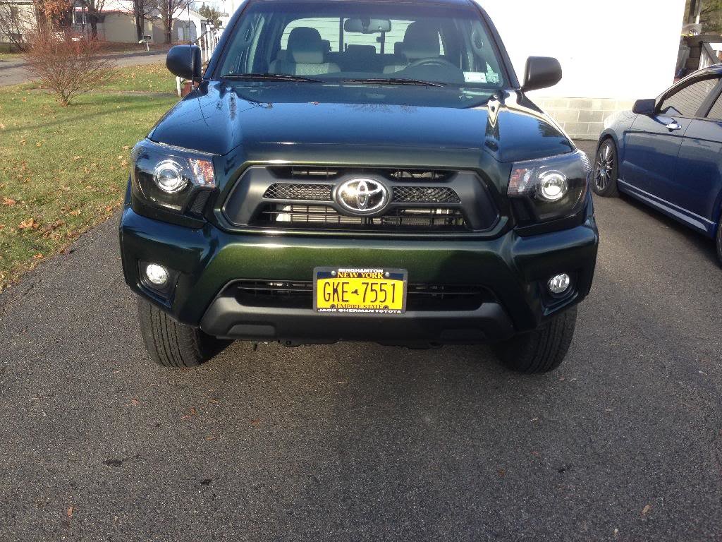

    Just got them on the truck!
    4397C3B2-8A81-4468-87B4-93E99C8D308D_zps_6bf0264e9ba302785daea01ab96bd3516ea947d0.jpg
    23BED3C4-38DE-445E-872E-A313C3240CBC_zps_040e9b9fb7519800b766b92aad32fb4a2fcc3f4b.jpg
