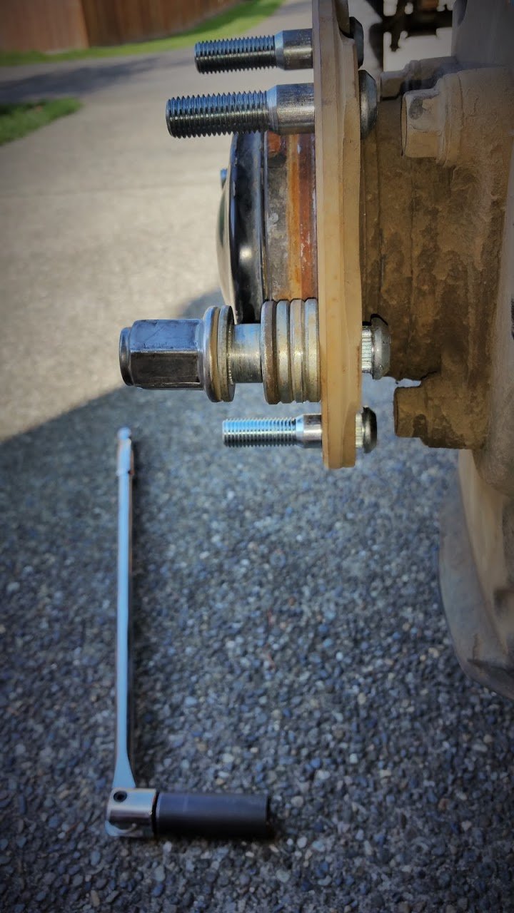

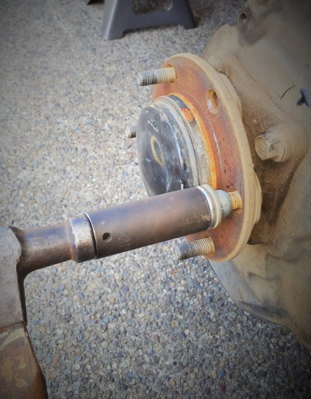

    1. I started by pounding out the stock wheel studs.
    The EASIEST way to do this is as follows:
    1. Put it in 4WD, jack up the front until both front tires are off the ground and put it on stands. Remove one Tire/Wheel at a time (you will be lowering the other side soon)
    2. Undo the (2) Caliper bolts, and also the (2) ABS bolts on the UCA and Spindle so you can swing the caliper out of the way *Zip-Tie it out of the way to ensure the hard brake lines and ABS Wire are not at risk of being damaged!
    3. Reinstall one of your lug nuts on the stud and tighten it down about 3/4 of the way.
    4. Put you socket on the lug, and give it a good solid smack with a hammer - this will pound the stud out w/o risking damage to the studs or lugs. Rotate the hub and do this all the way around.
    9wy9S2lEGtHUu7TDdysG6YR7xW2kx38oQhgecFww_2c395d03fcf3cb818465cce77d36e34863b1870d.jpg
    yH4hOXRRdzRyRbxkmdSkDdEi55K5Aq2l7wWzTFsl_b088aca2ec64e03c6fe7a85b466215f541765a02.jpg

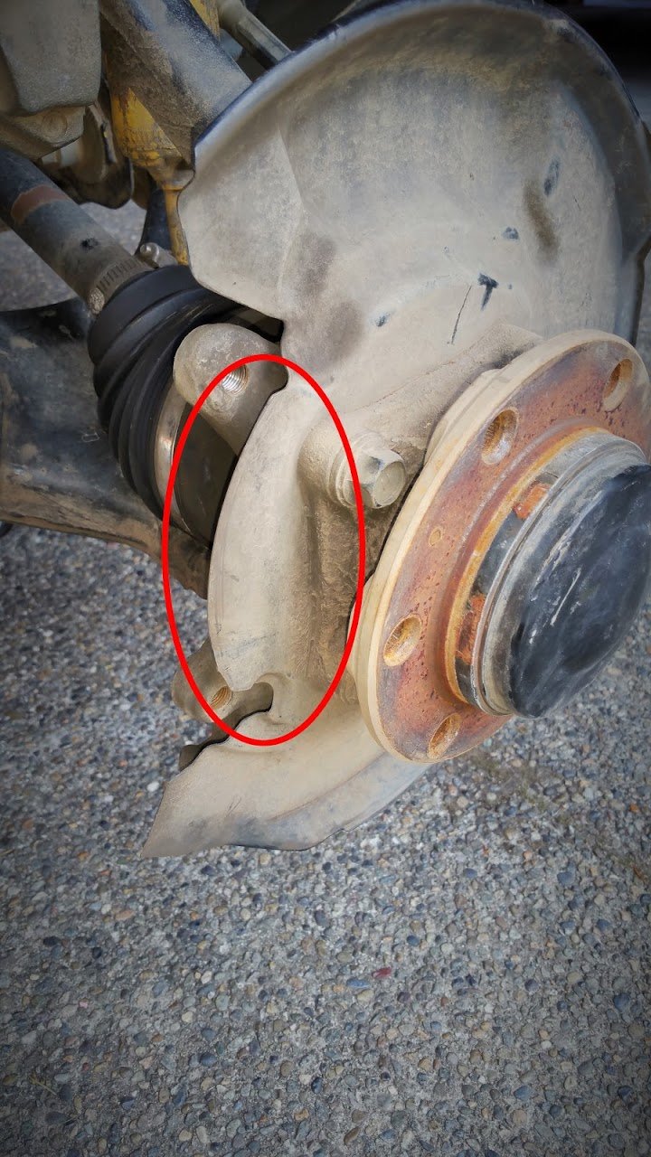

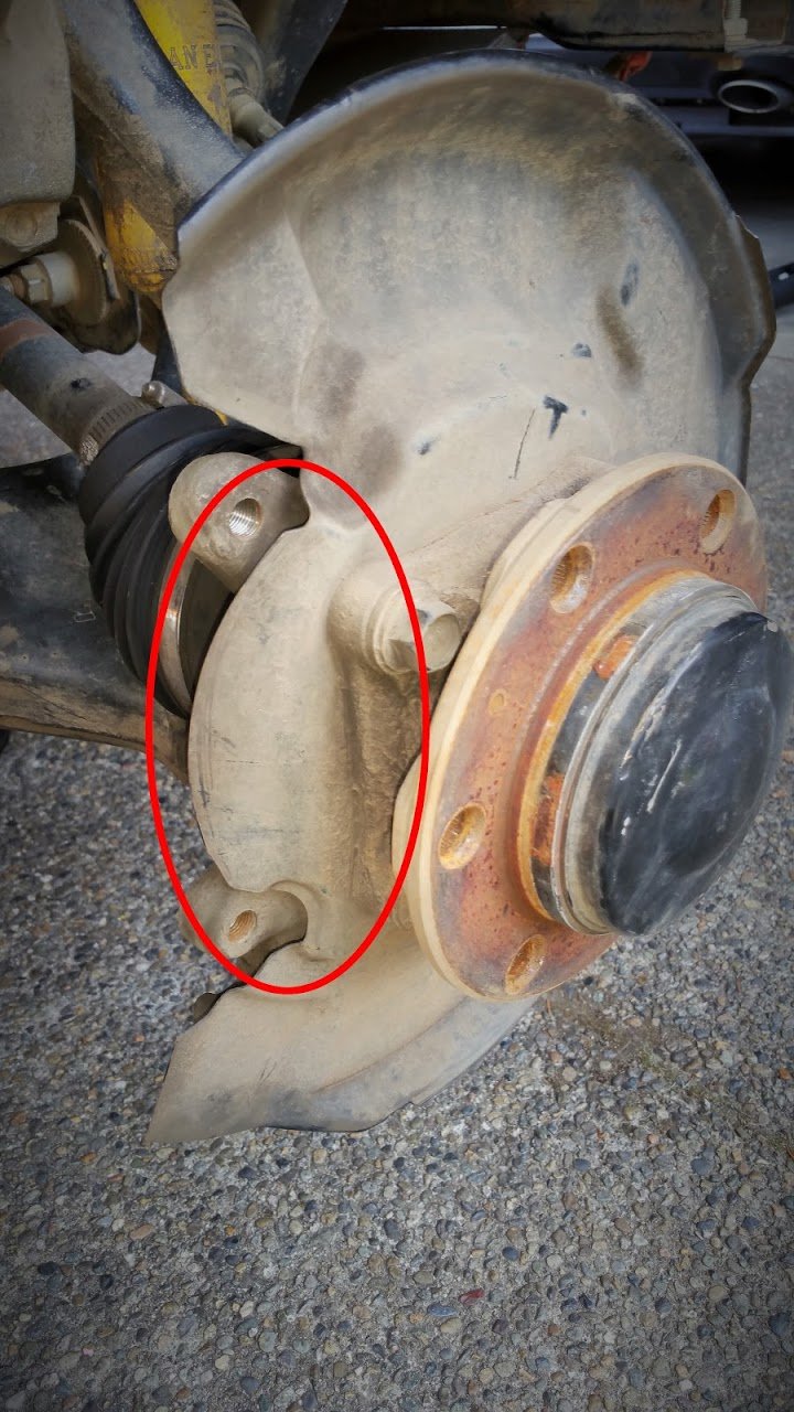

    2. Install the longer Matrix studs.
    1. Slightly bend the rear section of the dust shield backwards. This allows you to install the longer studs as you rotate the hub around. After all (6) are inserted, you can easily bend it back.
    hvQC6dUVHtOtG4kmd29irn9IPjmgXEXbWPw_RJ-7_b13c70694ab42fa0b028ae587de8e3e116b3fb9b.jpg
    OUtIgJ8yKXctgM79S2zxiQTRQa-2nnWJC8H47drM_bf355ac225631f1bea24a9d2a832d9757766dc01.jpg
    3uGBTgN9-PMwSPtw3l9V4uTuEFKhs3ikz0fEMdOF_ceeb07476ead823e7ba986d7e712dae36c2173d9.jpg

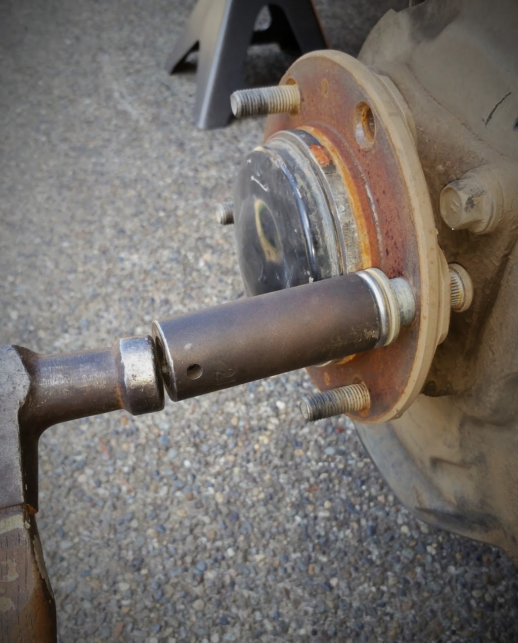

    2. You can now lower the other side back down, so the tire is on the ground and prevents the other side from spinning.
    3. Time to torque the new stud in place. I stacked a few (4) thick washers on the stud, and then re-installed the lug nut. I used my big breaker bar to tighten up the lug nut and "draw" the stud into place, but those of you with good tools or an impact wrench should have no problems. It took quite a bit of muscle to draw it completely flush, keep wrenching on it until it's completely seated:
    gJH8gWQIe-_Ipecy94f0trn2xzS_aIKBKfQ6YU7w_35e6380f9fd08e70437ff3733278ad9d581f692b.jpg
    4. After you've gotten all the new studs installed, reinstall the caliper and torque everything back down.

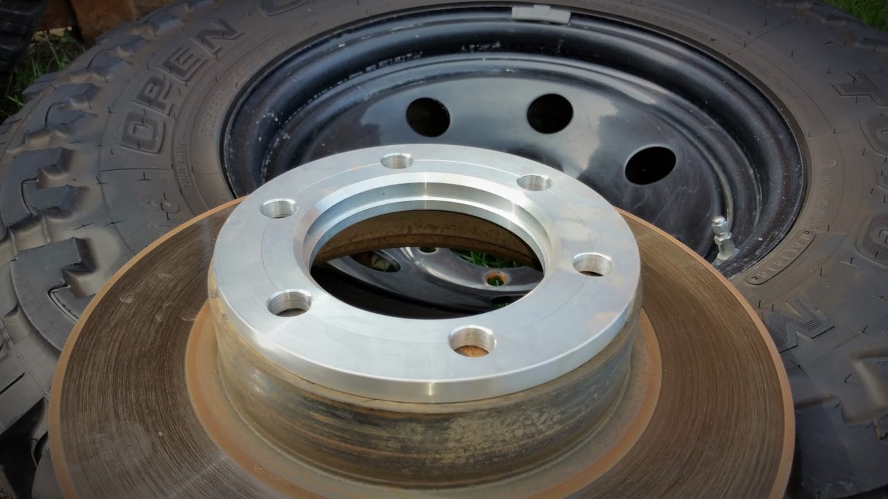

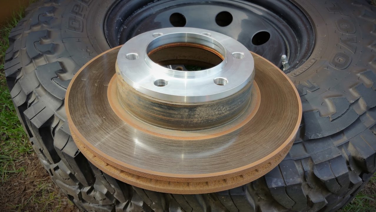

    5. Install your new wheel spacer. Here's a few shots of the 10mm (3/8") Spacer from Motorsport-Tech (BORA):
    5sbWmWfGtTPbGdH7Ftt57S8ZA2FDEKFp-gzMTHI2_bf5b2956e69270cec3a91ed0ae4f87aefe87d8b6.jpg
    4CvFUoo25EnmHipX54iHSDU6XRPndkK30t3Esd0C_05fc3a039376ca6db628cde8a5011632f0f63699.jpg
