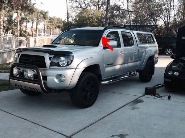

    About to buy an led light bar and it's going up on the roof racks and wanted to know how to run the wires? Wanted to see pics of how it's run next to the windshield . [​IMG]

    So I can't just run the wire under the molding without drilling a hole?:confused:
  14. May 6, 2014 at 7:11 PM
    Rich91710
    Rich91710 Well-Known Member
    Feb 23, 2012
    #73470
    16,331
    Rich
    Los Angeles
    08 Base
    Satoshi with FJ badge, factory cruise, factory intermittent wipers, Redline Tuning hood-lift struts, Hellwig Swaybar, Rosen DVD-Nav
    Need a hole somewhere to get from the cab to the bar.
    Running under the moulding lets you put the hole in the firewall.
  15. May 6, 2014 at 9:42 PM
    Tovar28
    Tovar28 [OP] Well-Known Member
    Aug 20, 2013
    #110820
    127
    David
    Chino,California
    05 prerunner TRD sport
    bilstien 5100s in front @ 1.75 bilstien 5160 in rear,general HD 4 leaf pack, 20% tint in front 5% rear, 40 inch led bar ,Kc daylighters , Aries bully bar , aries side steps ,black housing headlights ,factory roof racks ,snugtop camper shell, plastidip rims, bfg ko2 tires
    O thank god !!!:kona: I really didn't want to drill a hole in the roof thanks!!:)

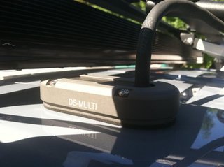

    It wedges next to the glass. DO NOT DRILL!!
  17. May 6, 2014 at 9:44 PM
    #17
    Tovar28
    Aug 20, 2013
    #110820
    127
    David
    Chino,California
    Ok thanks:)
  18. May 6, 2014 at 9:50 PM
    #18
    FreidTaco
    FreidTaco boost
    Sep 21, 2011
    #63918
    2,829
    jeff
    Panhandle of Wyoming
    06 Tacoma TRD OffRoad SR5
    URD Stage 3 SC. 35" duratracs LT
    Installed mine yesterday. Just went and snapped some pics for ya.
