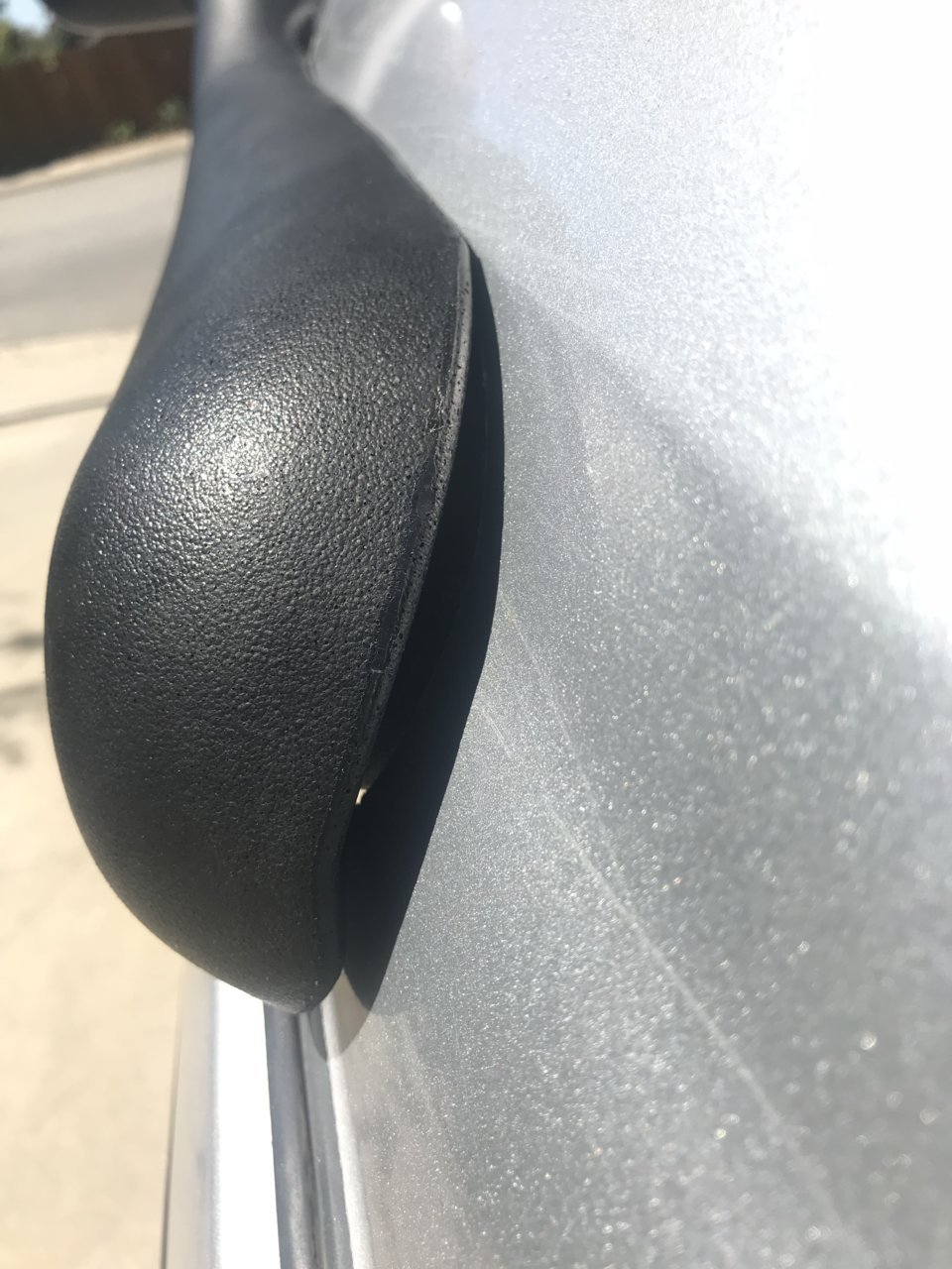

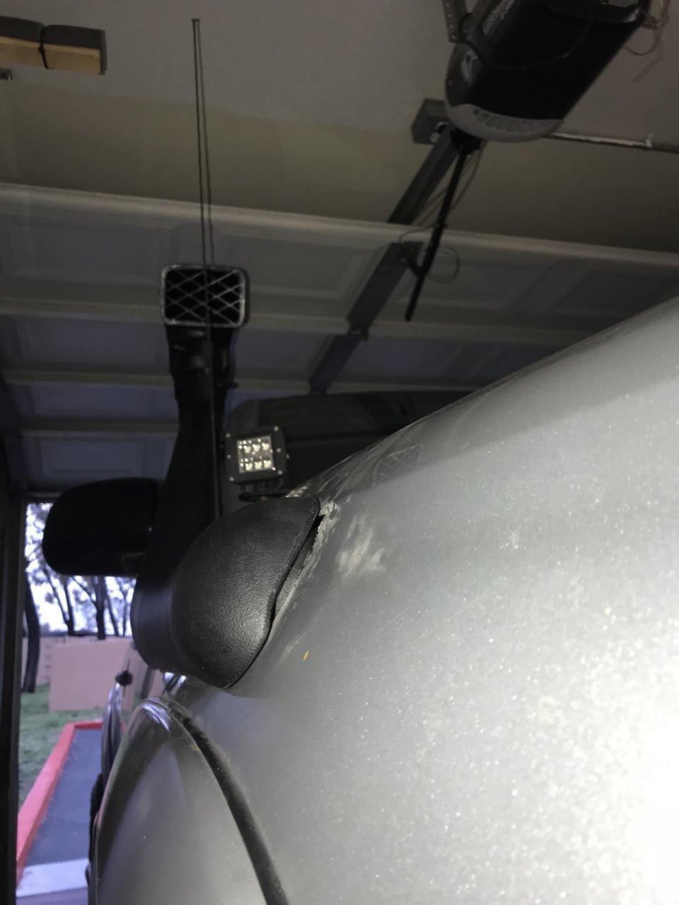

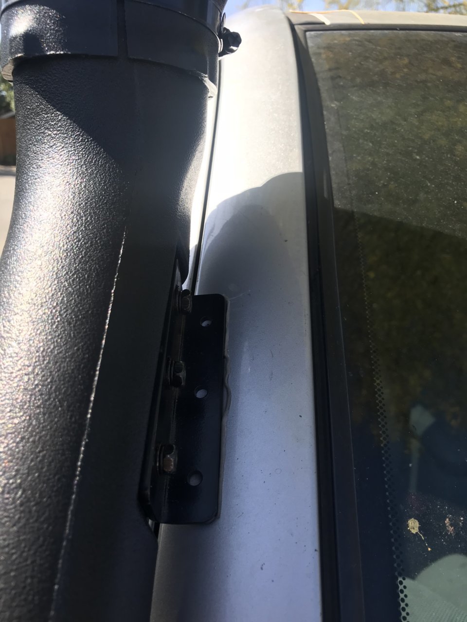

    Well did the install today and looks like I may be buying a new fender.
    I guess I installed it too low ?

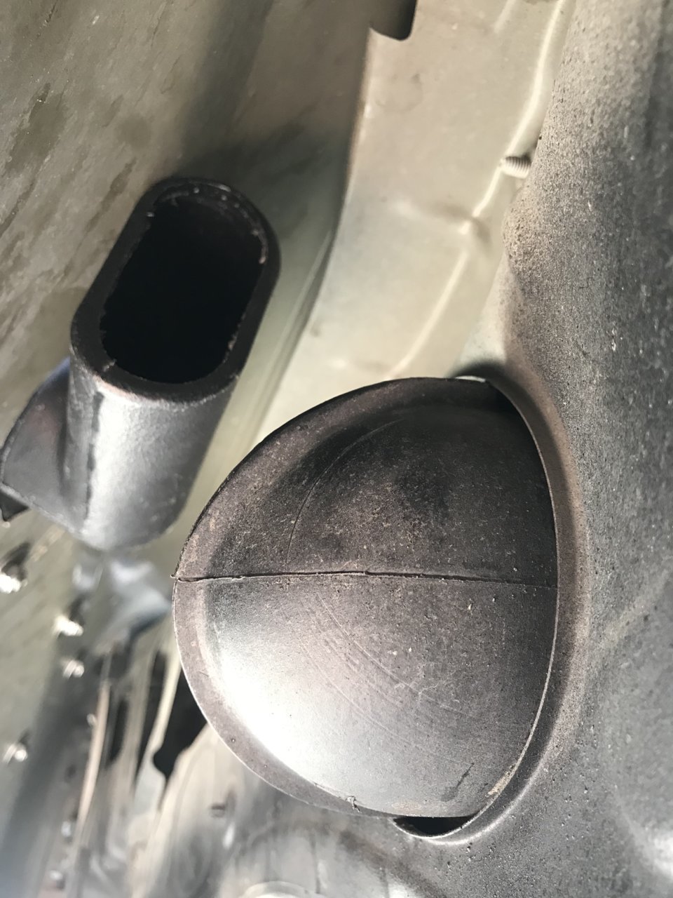

    The oval part on the snorkel HITS the back side of the fender. That gap is massive, and the a pillar bracket doesn’t line up what so ever.
    Any ideas on what’s going on? Bad mold ??

    Over piece is actually hitting the back side of the fender

    Lol! I actually d
    i wouldn’t worry about it, mine was the same
    I never did drill to my pillar as I didn’t want to replace that later and it’s fine. As far as it not sitting flush I just used black caulk and pow it follows the truck lines perfectly.
    I def trimmer that rubber piece down to make it fit and took a dremel to the engine bay to make a bigger hole since things weren’t lining up perfectly
    Nimble9 likes this.

    Looks fine to me- don’t drill A pillar just use some strong 3m tape

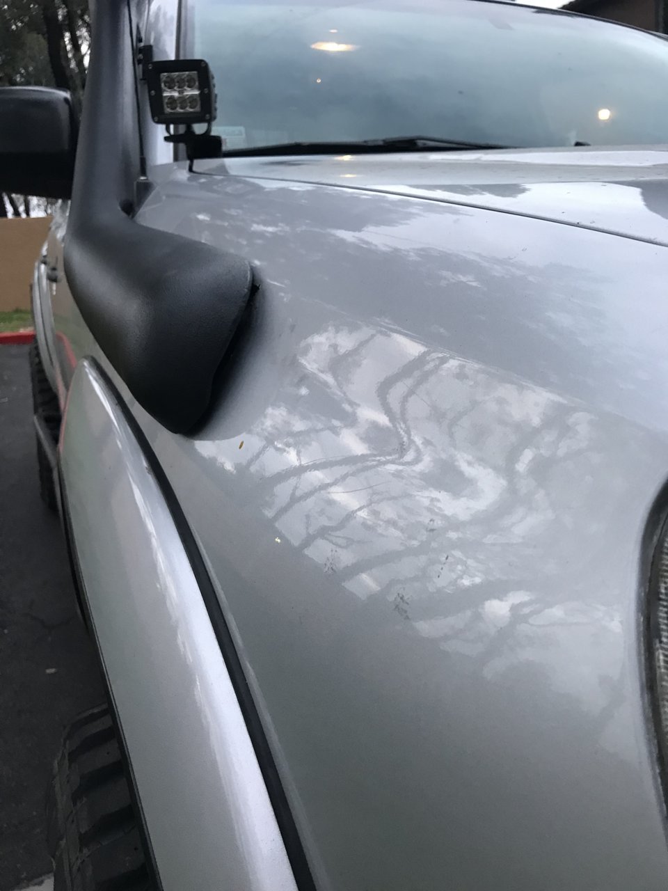

    Will the caulk fill a 3/8” gap ? I moved the snorkel up and it looks much better now. You can see the crappy cut at the front gap so caulking would really help,but the gap is about 3/8”
