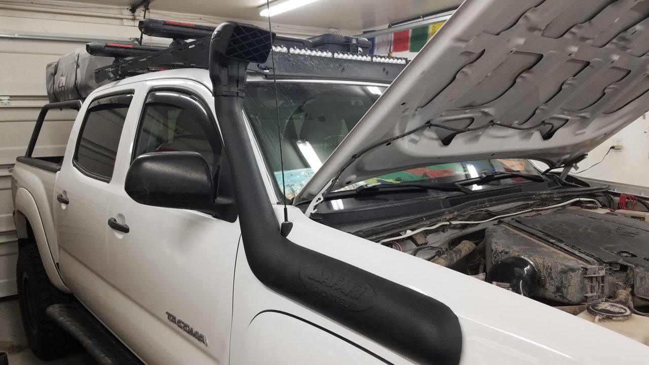

    Yeah it was very tough to line it up and mark all of the holes. If I could go back in time I would have done the cowl snorkel lol

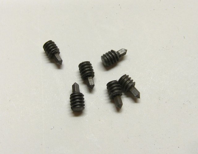

    You might try threaded hole transfer punches. Small center punches that thread into tapped holes (in the snorkel in this case), so now you have sharp points at each threaded hole. Line up the snorkel where you want it and give it a good slap and all the holes will center punch in their exact locations. Far more accurate than the "paint the bolt" technique. Here's an example of them and a link to McMaster if you know the thread pitch.
    https://www.mcmaster.com/catalog/124/2380

    that would have helped for sure! its also hard to tell because of the part of the snorkel that fits through the hole. hard to line it up before the hole is drilled lol!

    I know that you already installed your snorkel, looks good BTW! That info might possible help someone in the future, specifically @Gunshot-6A who I meant to quote. :anonymous:
    I've been following this thread since it started and will pull the trigger someday. I might try my hand at making my own template but I'll have to have parts in hand to figure out what easier once I get there.

    I didn't know these existed. Thanks for the tip!
    I think the fancy cruiser outfitter template will make do though. Def gonna use that spectre tube as well to avoid all the hassle of air pump relocation, etc as well cuz 2015 problems

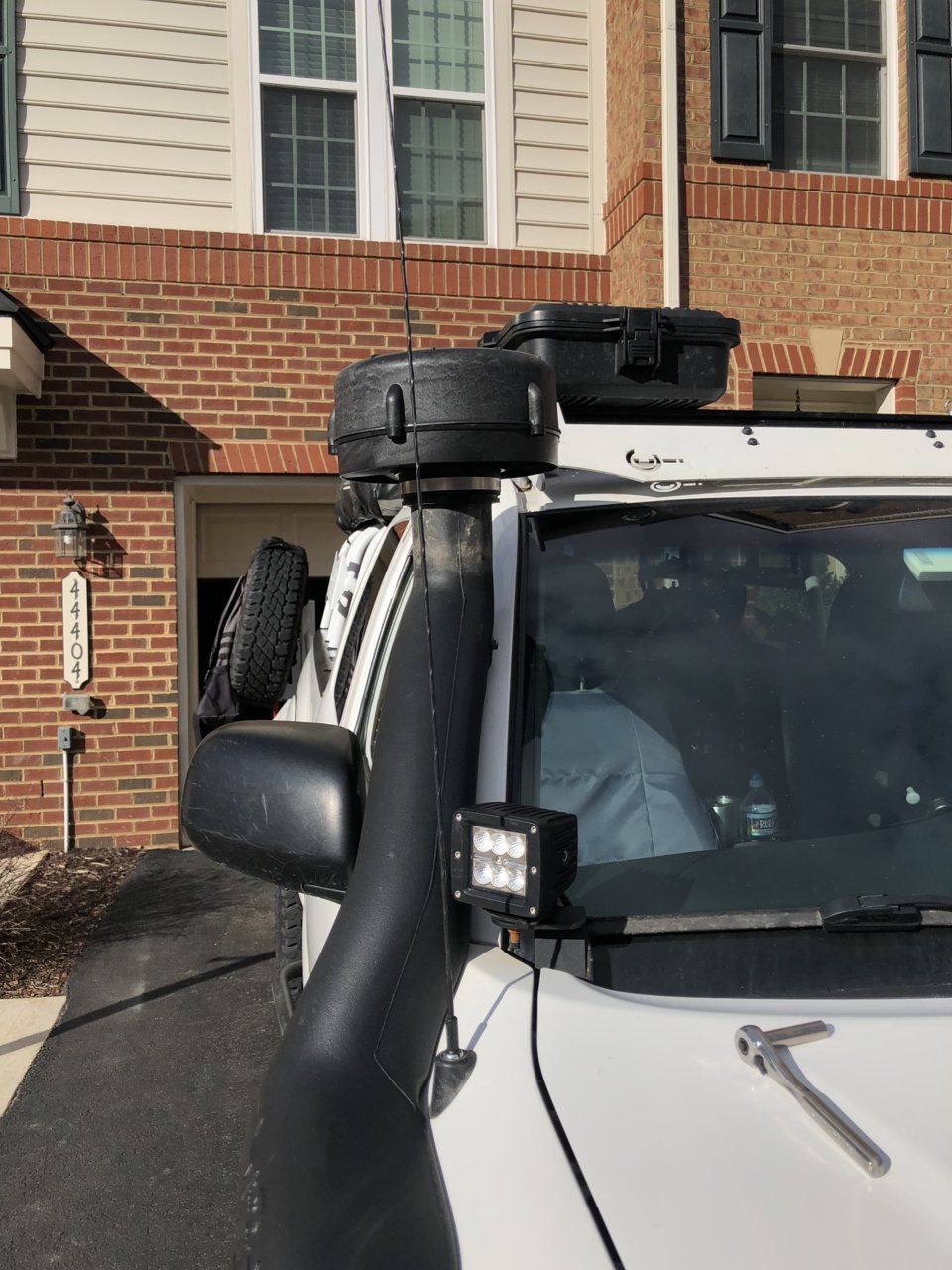

    Behold my handiwork!

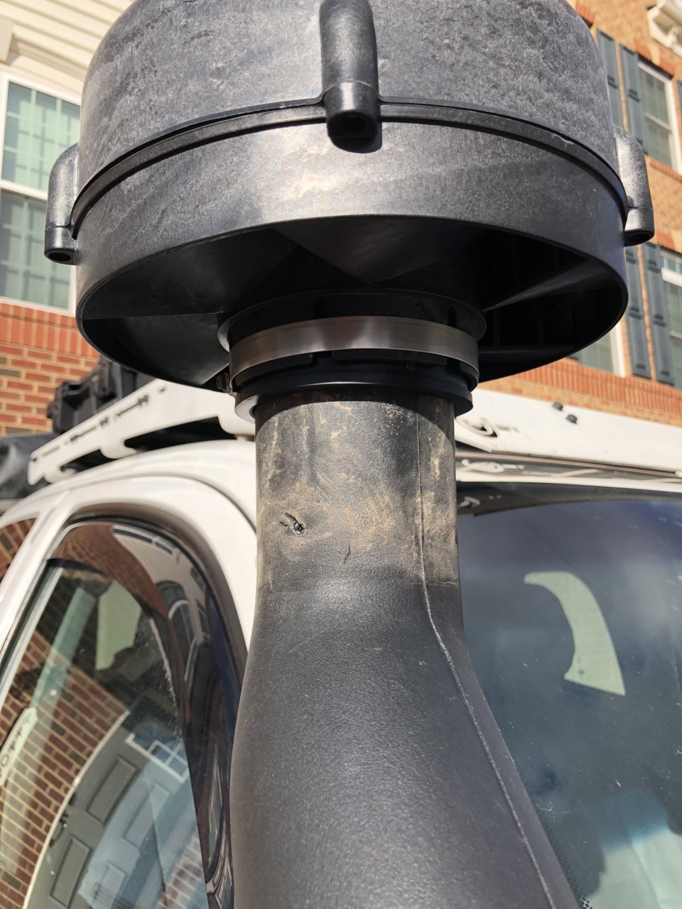

    Got a link to this prefilter? I want it!

    Is it a direct fit or do I need a reducer of some sort?
