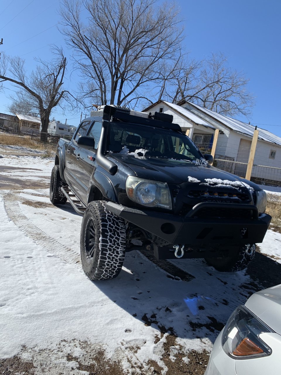

    3in lift, Bilstein 5100 Ome coils front. Bilstein 5100 Ome el095r leaf springs. Hooke Road roof rack. Lil BS fab cab mount relocation. eBay snorkel.
    Just installed on my truck used the spectre flex pipe and I siliconed the gap in the front with black silicone.

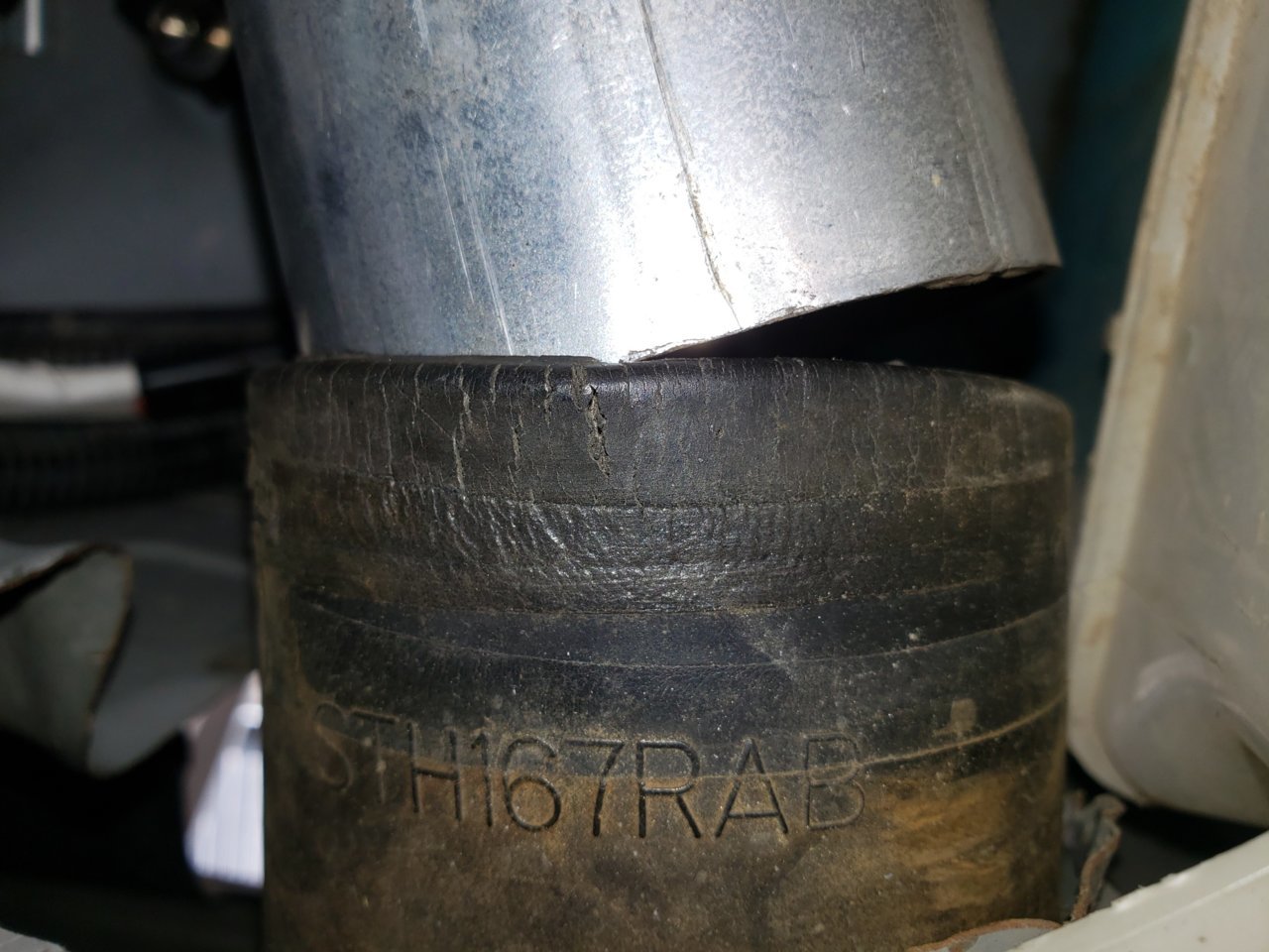

    Has anyone successful found a replacement rubber tube from the snorkel to the air box.
    I have torn mine pretty bad

    Does anyone know of a replacement for the elbow at the end of the snorkel? The one that goes from the oval profile on the snorkel to the 3" round intake tube?
    Mine is looking pretty worn out due to age. Lots of cracks developing.

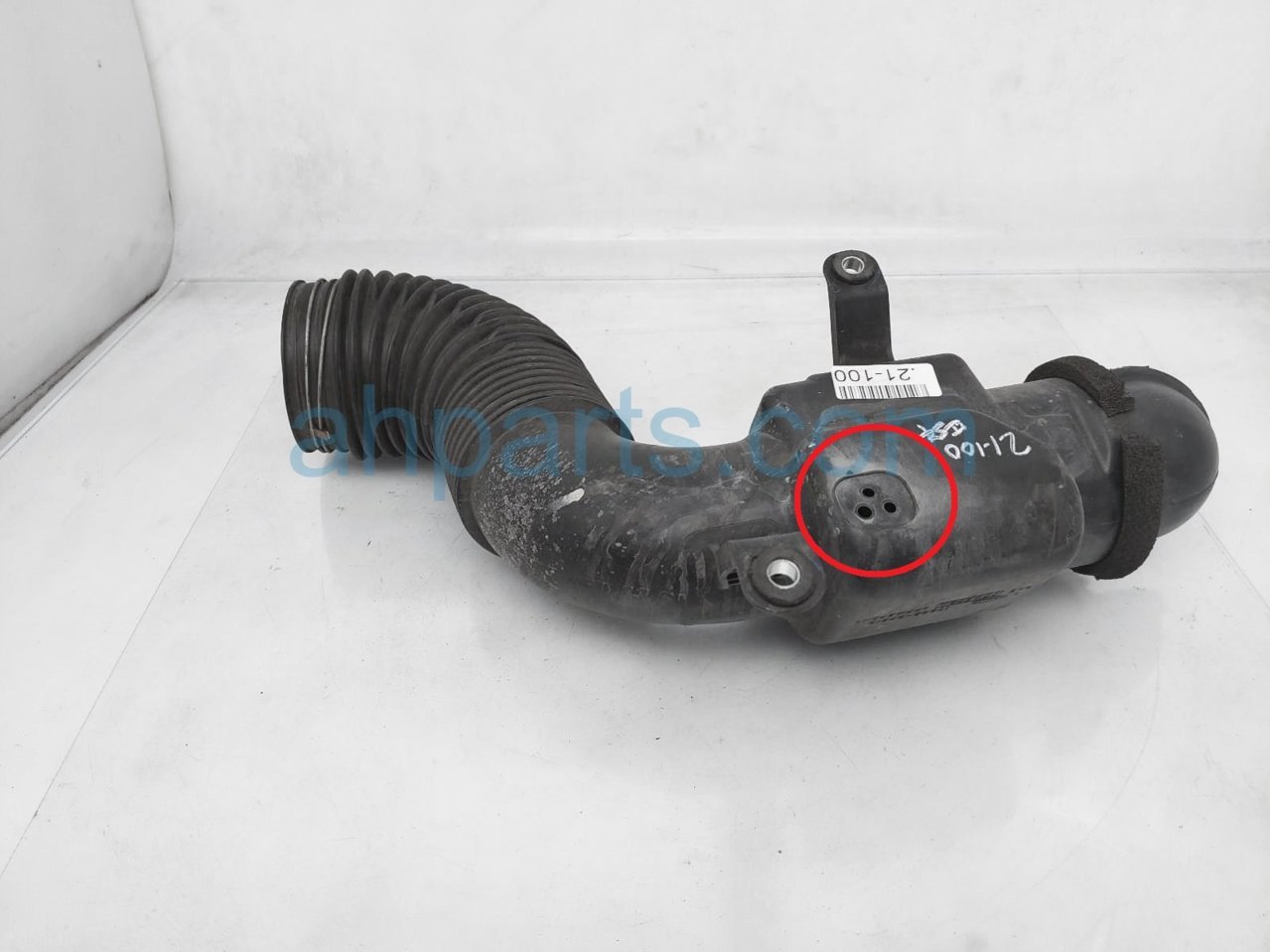

    Bumping this back up. I didn’t see this snorkel connected to the stock intake tube in any photos.
    Is it possible?
    has anyone done it?

    I'm sure it has been done or can be done, though I haven't seen it.
    You would have to cut the stock intake tube to accept the snorkel elbow fitting. Also, you'd have to seal or plug the additional holes on the underside of the OEM intake collector box.
