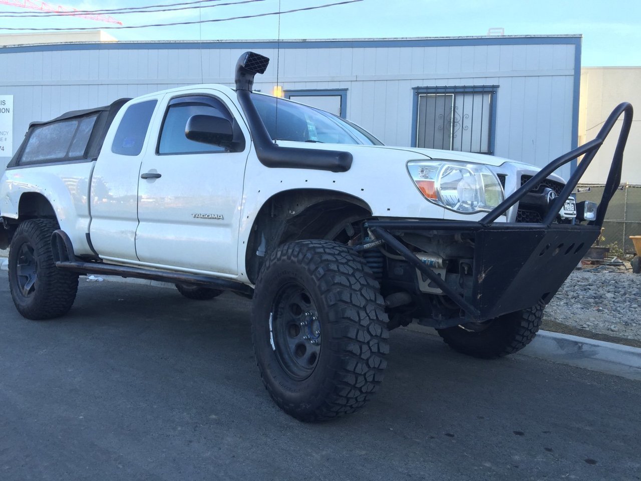

  2. Nov 5, 2015 at 5:55 PM
    slcsez2000
    slcsez2000 Well-Known Member
    Jul 16, 2012
    #82775
    7,289
    St Aug, FL
    12 TRD Sport 4x4
    Exterior: -Current Suspension- Icon extended travel front struts w/ 700lb coils Icon extended travel Remote Resi rear shocks Dakar leaf pack Icon Tubular UCAs with covers Icon neoprene shock covers -OEM Roof Rack -2 fold down cup holders in bed -Bed bottle opener -Access lite rider roll up tonneau cover -AFE Prodry air filter -Pop and lock bed lock -Rear differential breather relocation mod (behind tail light) -Aeroturbine 2525XL Muffler Armor: -SOS Concepts bolt on sliders W/ kick out -SOS Concepts aluminum front bumper with full hoops -SOS Concepts Rear HC Bumper -SOS Concepts IFS/Mid skids
    Looks clean as fuck
  3. Nov 5, 2015 at 7:02 PM
    adriancast
    adriancast Well-Known Member
    May 20, 2013
    #104544
    2,310
    Adrian
    Ontario, Ca
    2005 Tacoma 4x4 TRD Off-Road
    -2.5 Donahoe Coilovers -All Pro Standard Leaf Pack -All Pro U Bolt Flip Kit -Front/RearWheeler Super Bumps -Extended rear Bilstein 5100s -Flowmaster 40 Series -All Pro IFS Skid -All Pro Transmission Skid -Bruteforce Hybrid Bumper -30" Double Row LED bar -400 Watt Anytime -TRD Seat Covers -ABS Kill Switch -Locking Center Console Mod -Rear Differential Breather -BHLM -Anytime Fog Light Mod -Toyota Hilux Snorkel
    Yup. Wasn't planning on getting a snorkel because they're around $400, but when I saw this thread and the other for only $130 I had to buy ASAP.

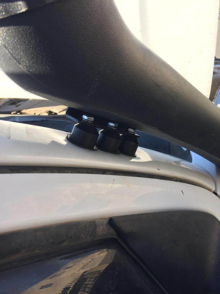

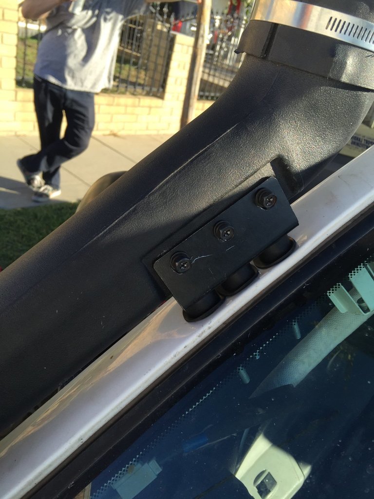

  6. Nov 5, 2015 at 8:01 PM
    Papa Taco
    Papa Taco HARD CAAAAAAARRRRRRRL
    Feb 20, 2013
    #98004
    8,882
    Jared
    Socal
    2011 Access Cab 4x4 6 Speed
    Follow the yellow brick road
    Yeah I just did this as well. So sick 3df351f0a9e579f4fd084e56b183d607_abe4c1b70659bc47436d3e5f34f38605d938e62f.jpg

  13. Nov 12, 2015 at 8:12 AM
    Papa Taco
    Feb 20, 2013
    #98004
    8,882
    Jared
    Socal
    I used a 4-1/2 hole saw. It's definitely bigger than I needed but it doesn't bother me that I made a bigger hole at all. The snorkel still covers the hole nicely. Also I mounted out through the A-pillar yesterday. Solid As A rock now. Got a little over zealous whilst torqueing it down but oh well. Who needs a non-dented A-pillar anyways

  15. Nov 12, 2015 at 9:42 AM
    Papa Taco
    Feb 20, 2013
    #98004
    8,882
    Jared
    Socal
    They are a hard plastic spacer my dad brought home from work. That fit in prefectly. I used a rubber washer underneath them so I didn't scratched the paint but I really like how it turned out.
