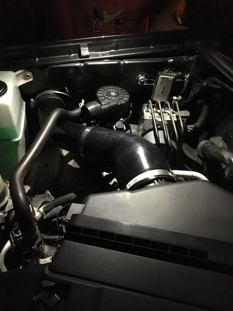

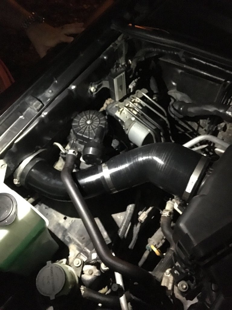

    Do these cause the elbow piping to rub on the emissions bracket at all? I had to shave mine down because the piping was rubbing on it so bad. I just wasn't sure how these lined up :notsure:

    I need to pop the hood and look at mine again but this is from install day and it was tight. That emissions thing basically sits on top of my pipe, close fit.
    9e5d44727c3aa154b0d382449e7af284_41dc8cbe8f91c61fca6f21f700ef3311ca5615aa.jpg4f98f633906d806568d5aa12ef3a21b5_29778c8954d51a71a49b85442ddec1d8abb120e2.jpg

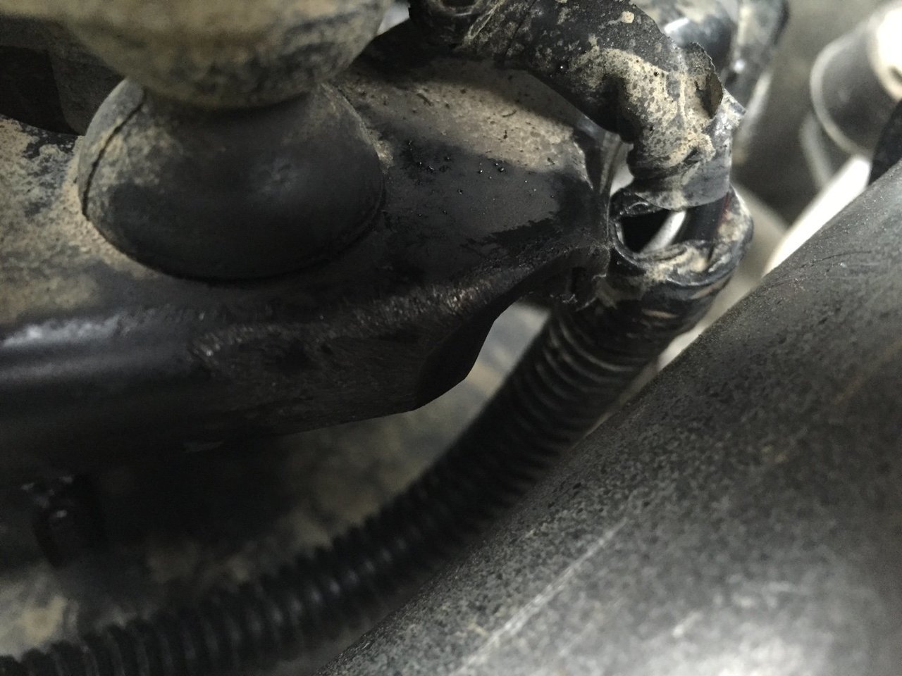

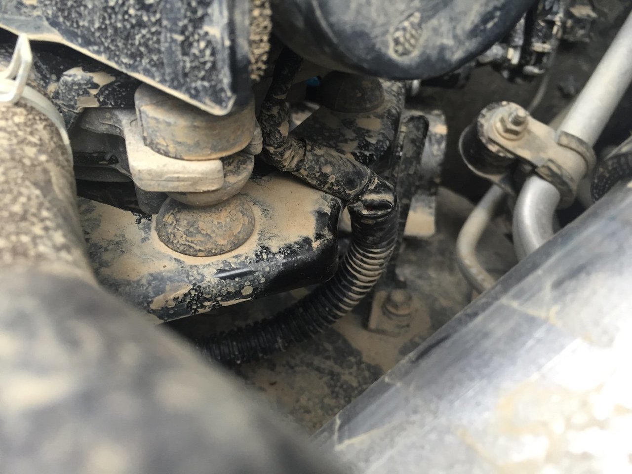

    I had to trim the bracket a bit:
