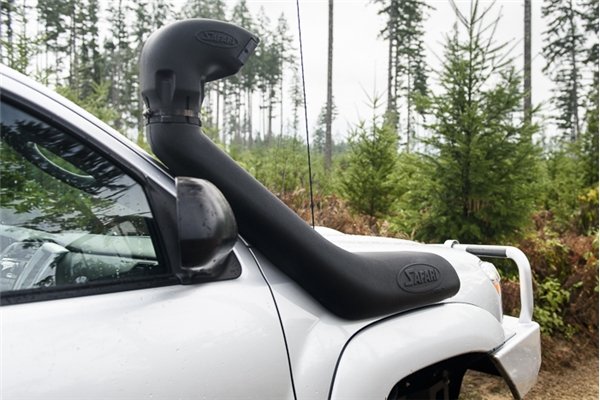

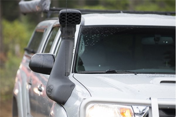

    Sorry to revive and old thread, however I was looking at this snorkel compared to an ARB snorkel. The price it definitely right on halls DIY snorkel, but I'm just worried the air flow isn't that well. If you compare the two diameters it looks at if the ARB is double in size compared to yalls. Any idea now that you have had them for a while on constricted airflow through your snorkel?

    Well, I don't have an ARB snorkel to compare with, but I do have the stock intake tube from Toyota - which happens to be the same diameter as the DIY Snorkel tube (3" Inner Diameter).
    Can you provide comparison pics/data to further support your hypothesis?
    My truck still performs fine with the DIY snorkel - no sluggish performance or lack of airflow, it drives and it accelerates. So in my opinion - it works just fine.

    Agreed. I had no loss of acceleration or power from Install.
    Go look at your throttle body. It's 65mm or 2.55".

    I don't have any physical snorkels to compare or I would. But looking at the DIY snorkel compared to the ARB pictured in my post, it almost seems as if the ARB just dwarfs the DIY. Of course this could just be direct angles and exposures etc..etc.. But that's why I wanted to ask as maybe y'all have some insight on the issue.

    Okay - that makes more sense! Yes, physically the ARB snorkel tube itself is much larger, but I've yet to see what the interior (engine side) of their ducting looks like. I'm willing to bet the ARB tubing reduces down the same 3" ID as the stock tubing before reaching your intake.
    Without seeing the other components of their kit and taking measurements, everything I've said is purely just conjecture, so take it with a grain of salt.
    But, I've had the aFe CAI (Pro Dry-S) and now the stock intake w/ Snorkel, and my butt dyno says I still have just as much oomph and giddy'up as I've always had - even if there was any performance degradation it was too small to notice :D

    I didn't use any silicone, good hose clamps provide a 360° seal.
    The design of the water separator on the DIY snorkel is identical to ARB, whereas it uses centrifugal/turbulent "ram" air coming in through the snorkel to separate the (heavier) rain/water and force it to the walls of the snorkel head; with the force of the incoming air pressure, the water is expelled through the (4) slotted openings of the snorkel head (the 4 slots around the heads are where the water comes out).
    Keep in mind that the DIY snorkel is modeled after the Safari snorkel (owned by ARB) so the basic function is the same, just as it is for any snorkel design - raise the point of clean air entering the engine.

    Like I said, it doesn't matter. It reduces down to 2.55" at the throttle body regardless. And without forced induction it won't compress sssoooo...
