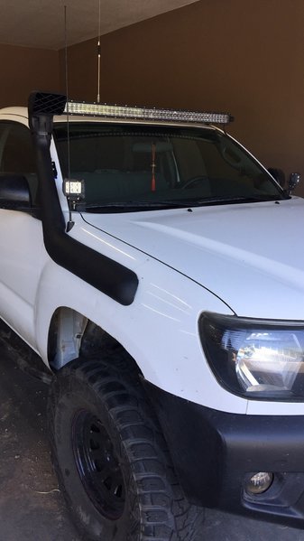

    I think the template from Cruiser outfitters, would have been worth twice its weight in gold, but if youre good at eyeballing stuff, it won't be hard. The holes in the fender, I drilled them out to 3/4", so I had plenty of wiggle room. The backing washers are large, and the snorkel body covers the holes, so no one will see how big of holes I drilled.

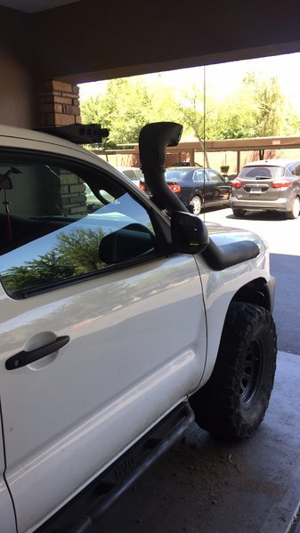

    Yup, took less than a week to receive it just like OP said. Followed his directions as well.

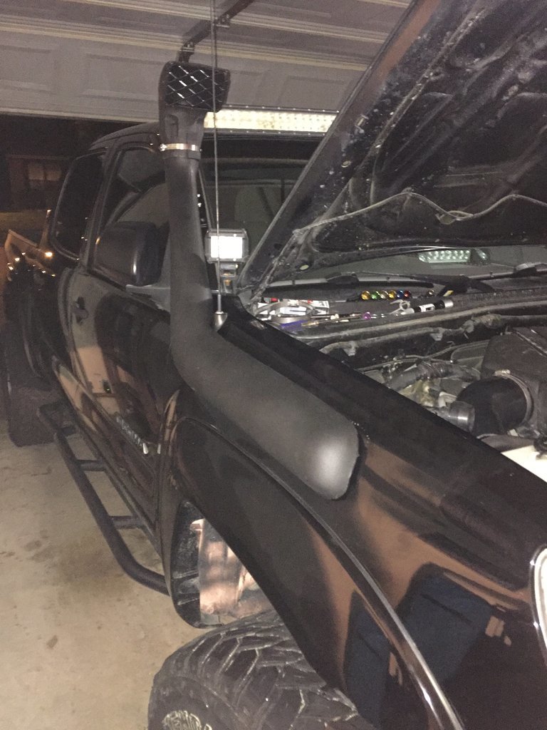

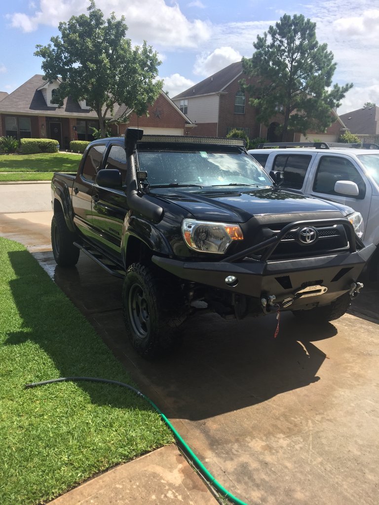

    Just did it gotta get the pipe made and a new rubber fitting cut to much off lol.

    Wasn't too hard I did a hack job on the fender but the snorkel covered it lol.

    Yeah lol didn't have the heart to drill into the pillar used 30lbs weatherproof double sided tape.
