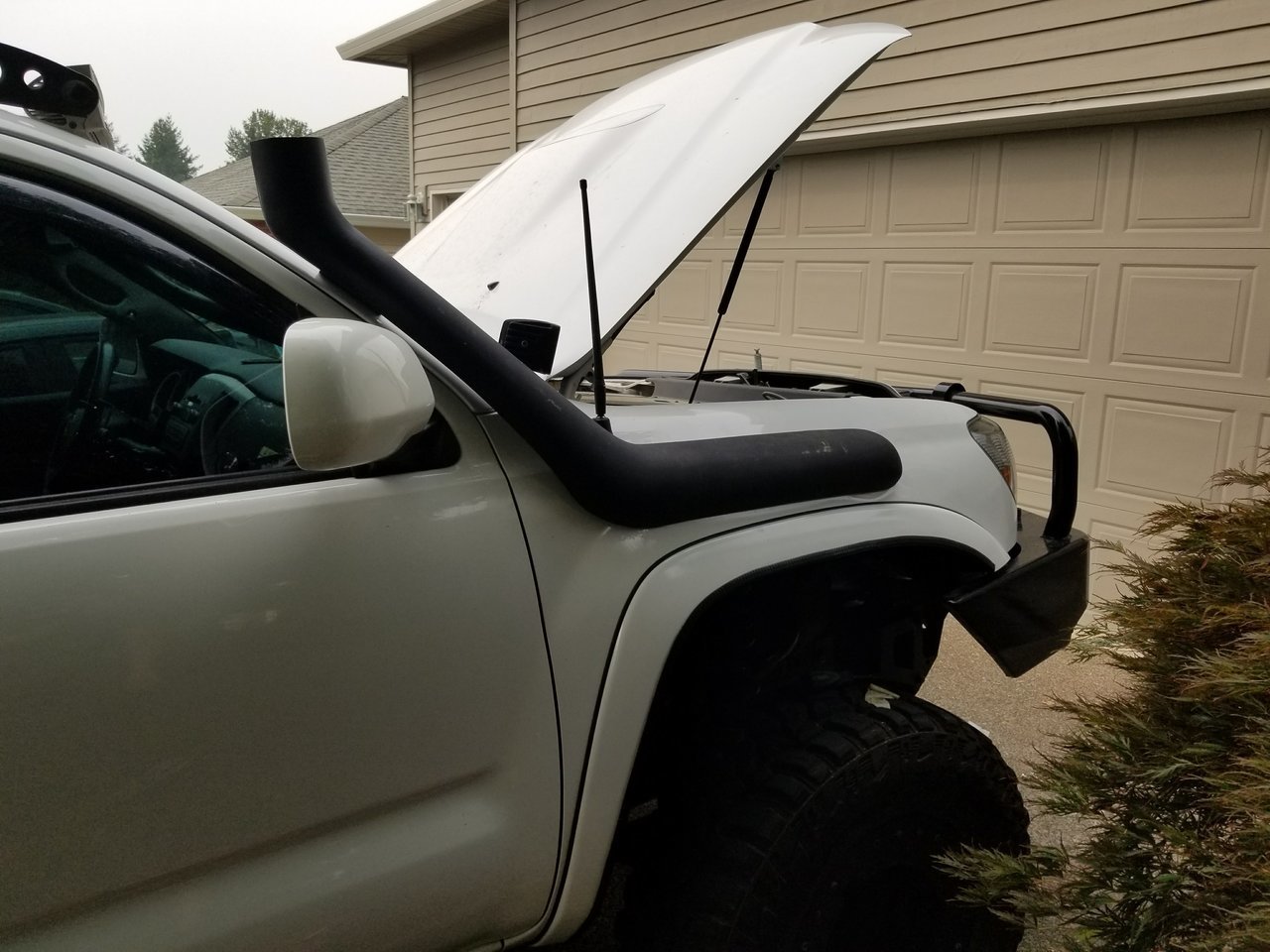

    So, I done went and did it. I checked the placement multiple times with and without the studs inserted, and a few more getting the template lined up right. I ended up a little too far forward and about an inch higher than I needed to be to plumb the hose through the factory air intake hole, so I had to trim the inner fender. Luckily, my cuts were straight, so I was able to use some pieces of door edge guard from AutoZone to trim out the chop job. Overall, it doesn't look to shabby. I did run a bead of RTV around the snorkel body to seal up the gaps, and that got a little smeary, so I'll be cleaning that up tomorrow.

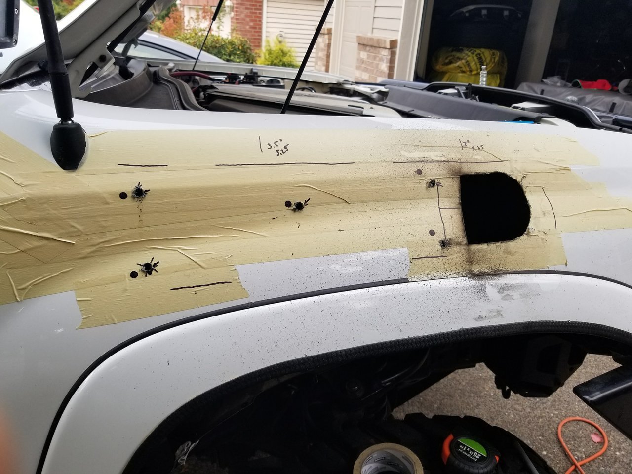

    ill just leave this here.....a good tip, dont use their template, make your own and measure from the top of the hood down. i will post a guide on what i did later today.
