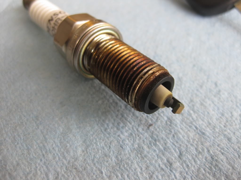

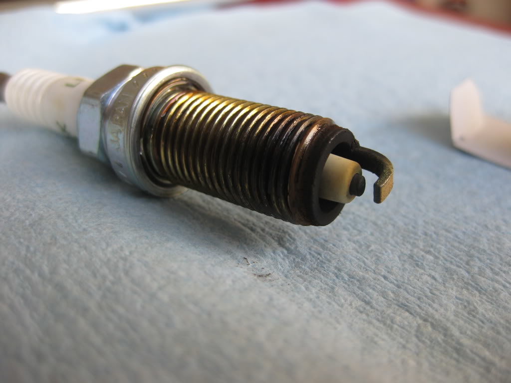

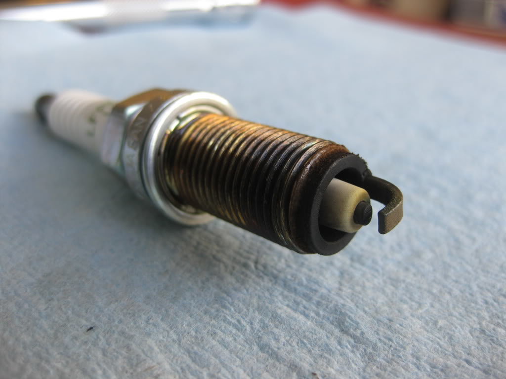

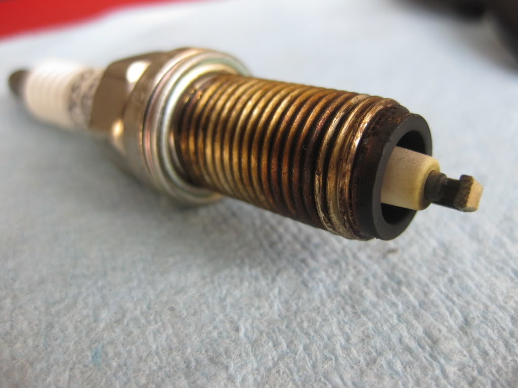

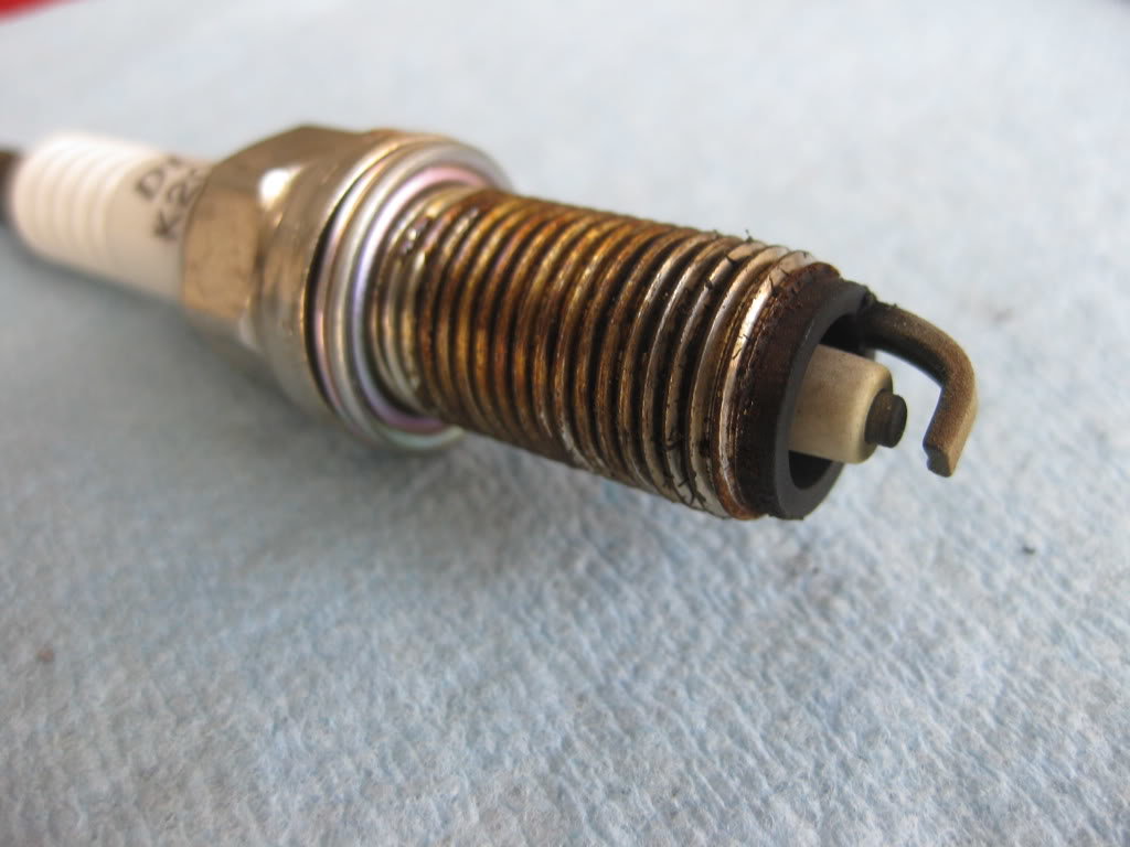

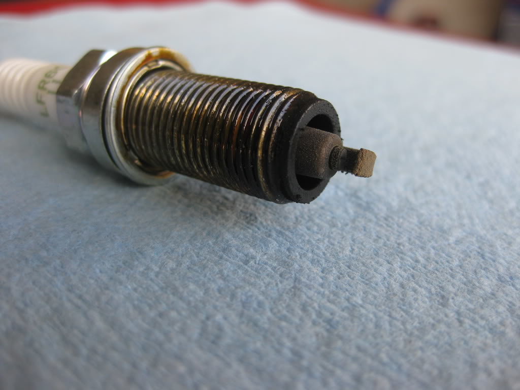

    ngk 1 is the one nearest on the driver side, counting clockwise.
    These plugs were pulled out after 58k miles on my 1GR-FE 4Runner.
    NGK 1
    NGK 2
    NGK 3
    DENSO 4
    DENSO 5
    DENSO 6 - nearest to the passenger side.

    you reemplace by the same or a different brand , passager site need a iridum?

    4.10 gears, sliders, and lots of buttons.
    Replace with the OEM Denso plugs for best performance

    yes, I replaced all six with Denso plugs. Looking at those old plugs, Denso seems to be in best shape.

    Looks like you may have a valve stem seal issue on the cylinder the NGK 1 was in. There's lots of soot on the insulator and lots of oil on the threads all the way up to the crush washer. Does the engine consume any oil?

    The thing with the dip stick on the 4R, its hard to read. As far as consumption goes, maybe a little bit, nothing major is observed.
    Is there a way to correct this (valve stem seal issue)?
