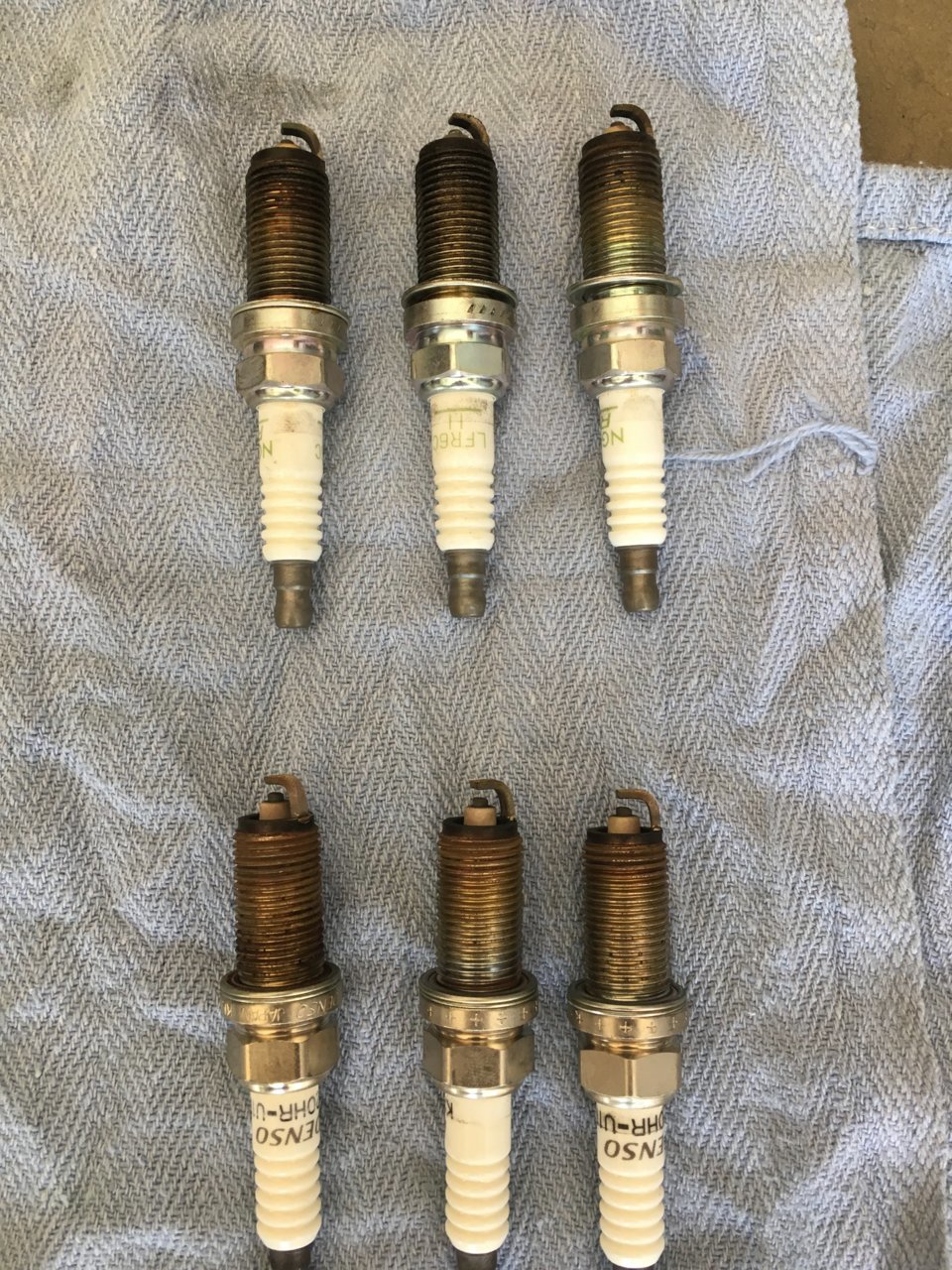

    Just bought a 2010 prerunner 76000 miles. Already changed rear diff fluid that was disgusting. Changed spark plugs and I guess no one in the life of the truck thought it was a good idea to change plugs. 3 denso on passenger side and 3 ngk on drivers side.

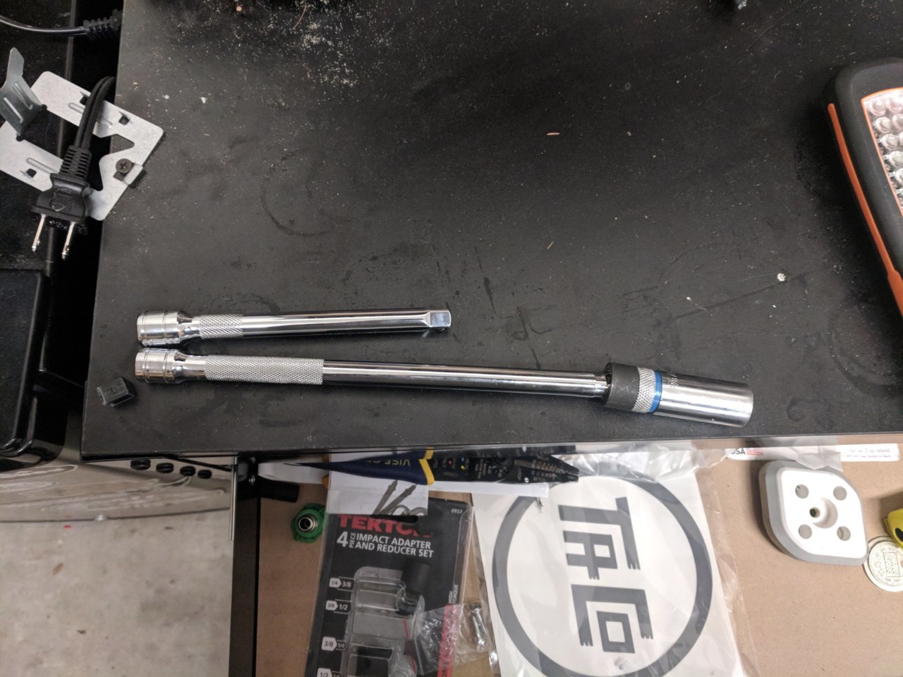

    Took me 2 hours last night with a few beers and some buddies around chit-chatting.
    This magnetic spark plug socket was a great buy (also the 6in extemsion) The head has a little movement to it which helped in those tight spaces on the DS. The spark plug socket is metal and not plastic so should last me a while. I also did the iridium plugs and haven't noticed any difference after driving about 50 miles this morning.

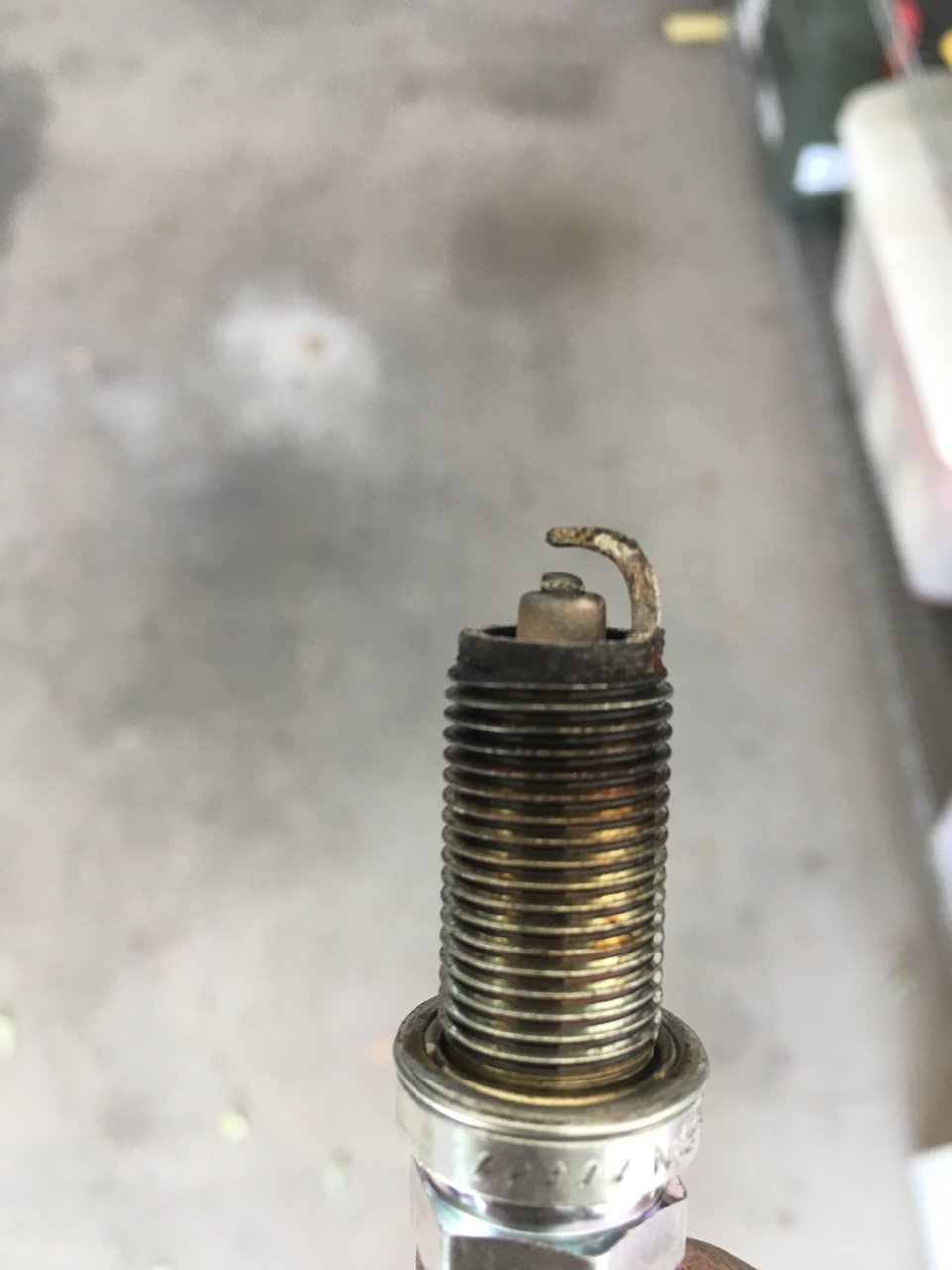

    Just changed mine out today, 1/2 ngk and other half denso. Almost all of them were at .58-.61 for a gap at 70,000 miles. Great write up! Very easy to follow for a guy that doesn't know much about engine maintenance.

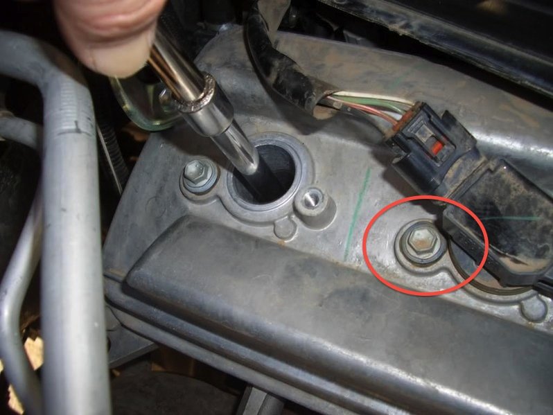

    Great write up and it helped me out a lot. im curious, what is the other bolt next to the coil pack for? I unscrewed two of them before realizing there was no need to. If they dont hold in the coil then what is their purpose?

    .057 is the FSM specified maximum. Was it running like poop?

    I am not sure what those hold in or down. Good question.
