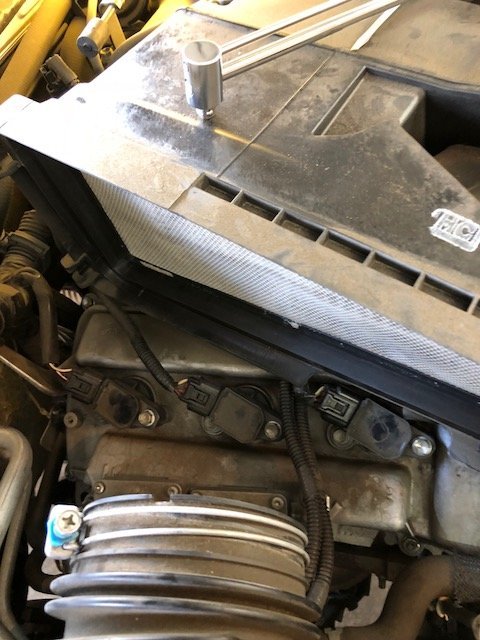

    I changed them last Sunday, and was able to do it without removing the pump. I released the latches on the air cleaner housing, loosened the clamp holding the inlet hose to the air cleaner, and twisted the air cleaner off of the hose.
    I had enough clearance to remove and install the plug without removing the hose or the pump.IMG_7798.jpg

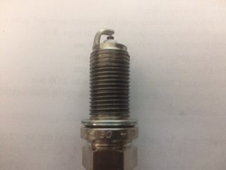

    I used the Denso TT plugs as they were rated for the longest life. The electrode on them is hair thin!!! see fuzzy pic below.
    The gap on the old plugs were 55 on the passenger side and 60 on the driver side.

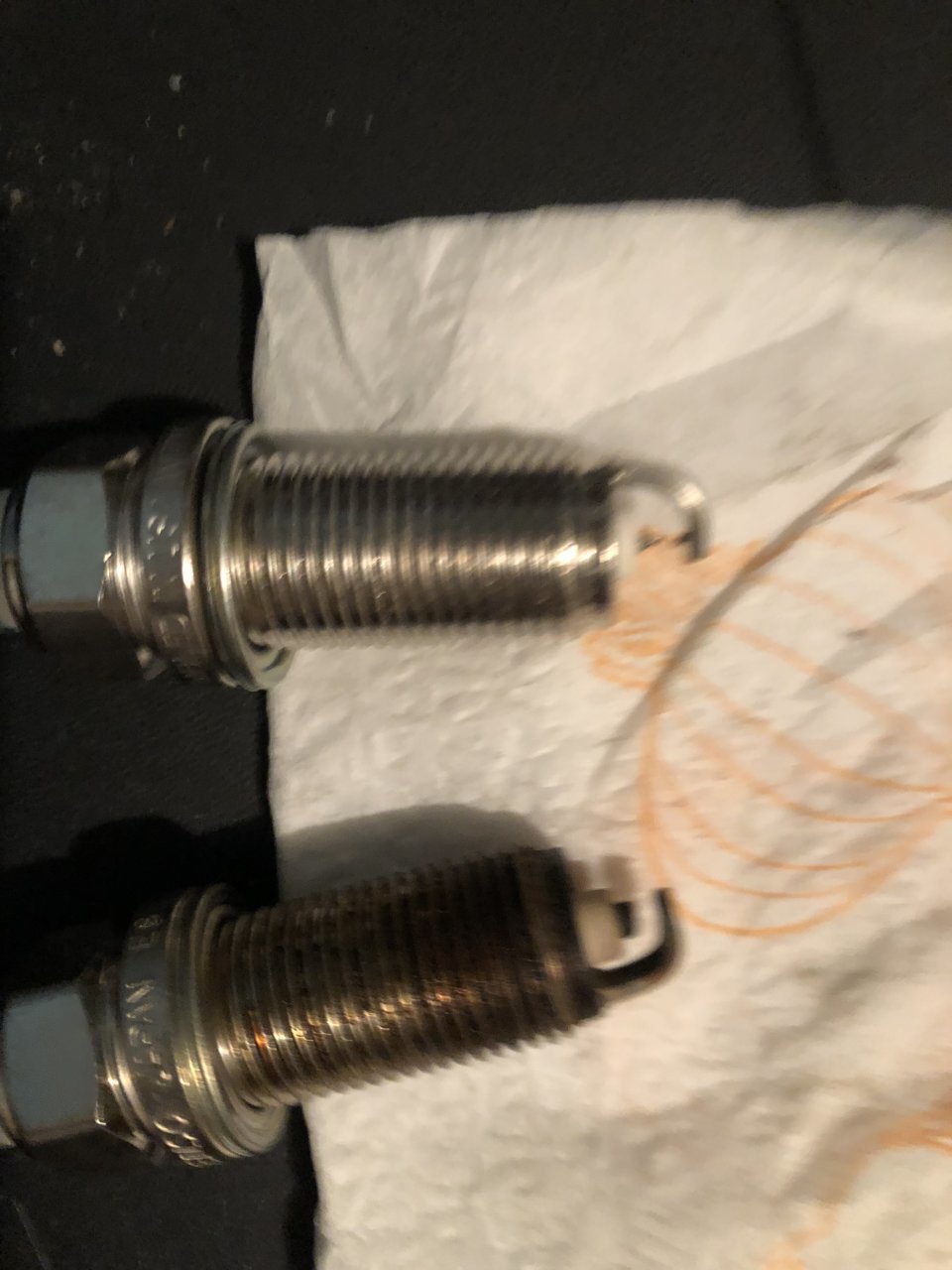

    this is what i mean by a thin coating.. its one of the plugs i recently installed at 30K miles.
