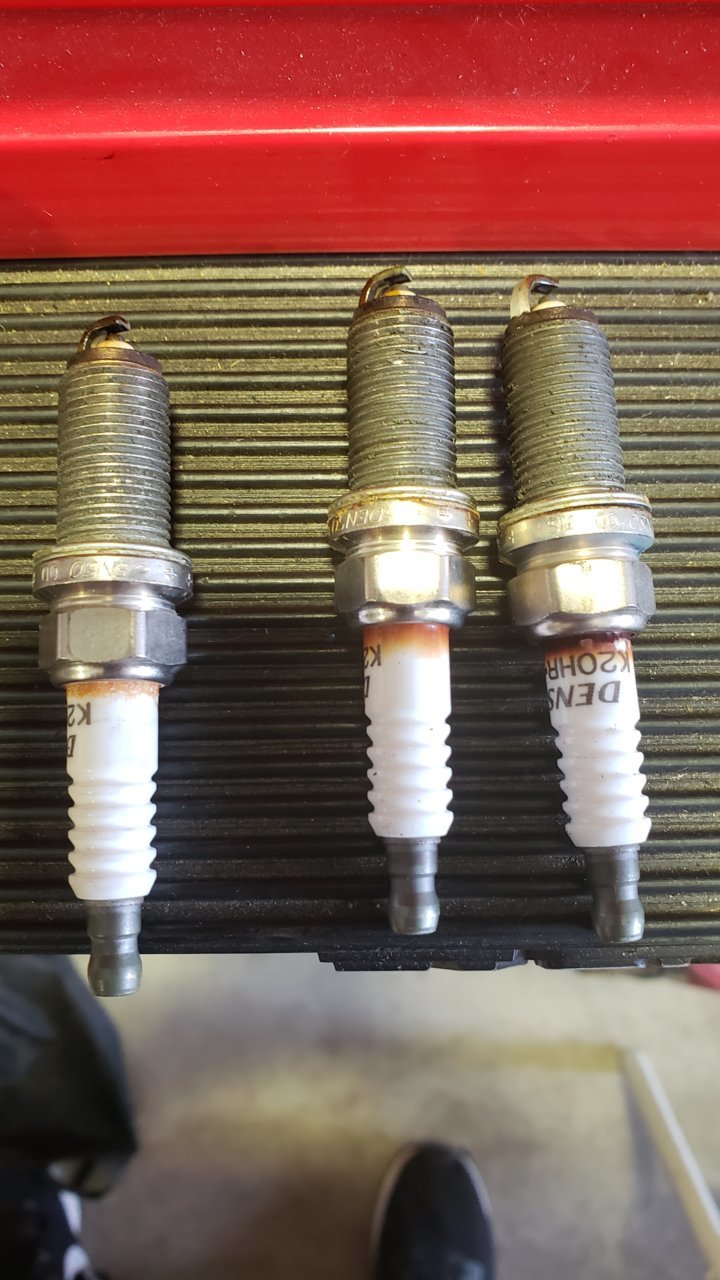

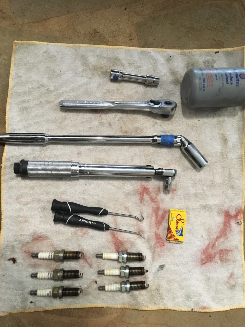

    Big shout out to this post. Helped me change my spark plugs. Took my time, and so far everything went nearly exactly as described. I watched a few youtube videos for sanity (because I had them changed on a Honda when I was younger and I think the charge was like $350…).
    Here the aftermath of 100k mi og spark plugs. I know I know, every 30k
    Scary moment, since this was my first time to change spark plugs, when I started the truck, it shut off on me. Did a double check, started it again, and so far, no issues.

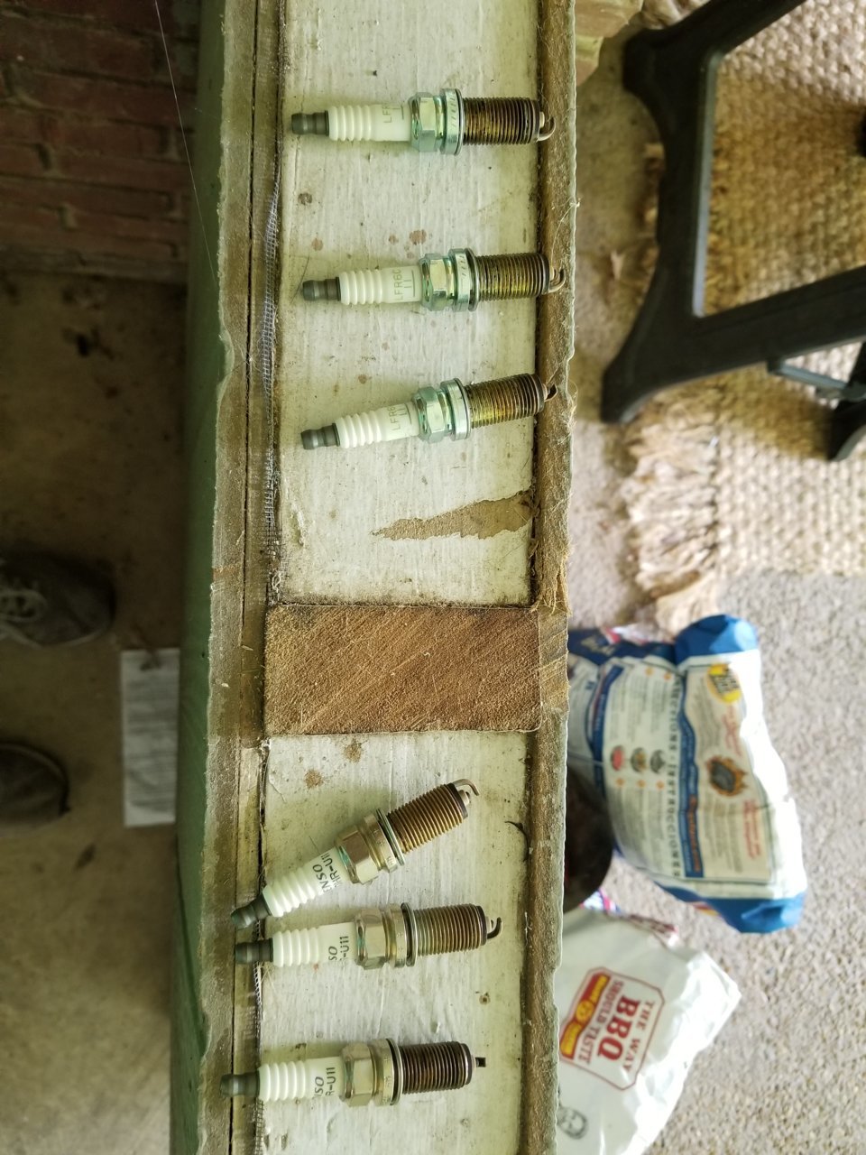

    Juat did my plugs, at 113k i pulled half NGK and half Denso out and I honestly dont know how my truck was running with no issues. The electrodes were literally gone. Previous owner had dealer do all maintenance up untill i got the truck at 100k. I dont think they ever changed the plugs like they stated they did.

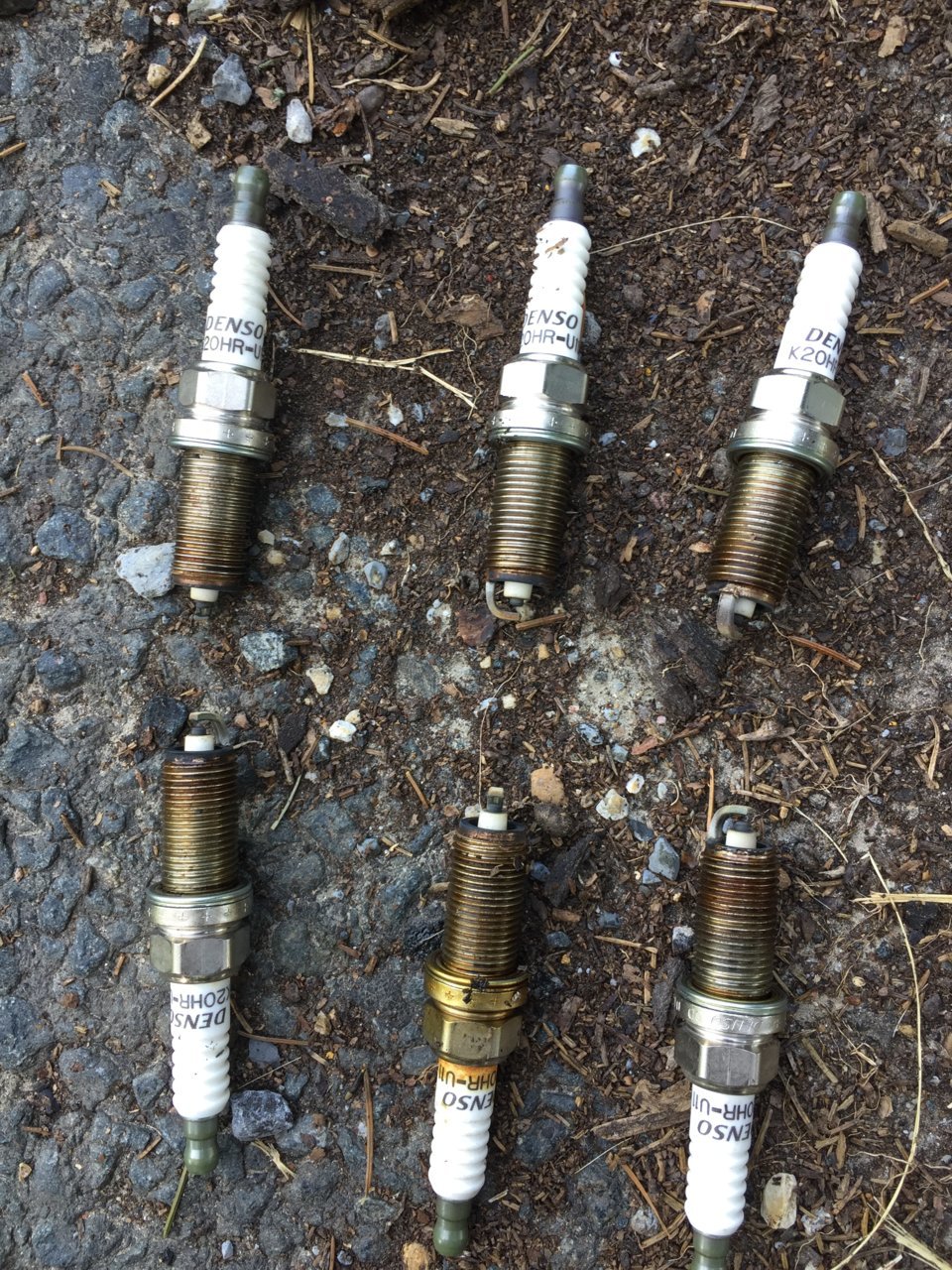

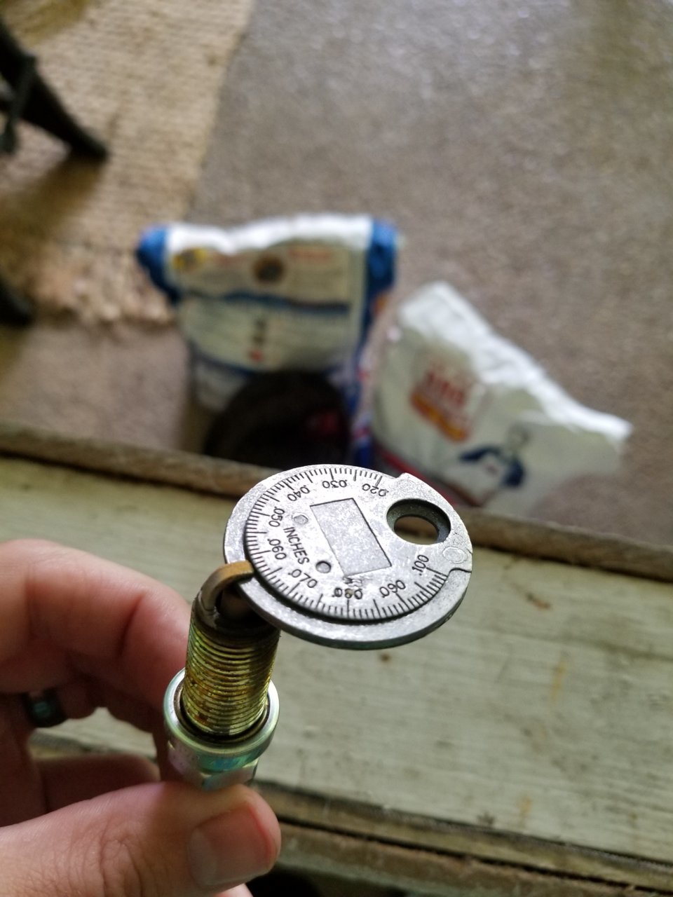

    Huge thanks to OP and Taco World. I did my plugs today, pulled out 6 Denso plugs so I guess the dealership did change them like they charged me for :)
    One of the plugs was a little oily, not sure what’s up with that. All them gapped in the mid 40 thousandths.
    When I started the truck, it immediately shut off but seems to be running fine now. Probably the computer resetting after hooking the battery back up.

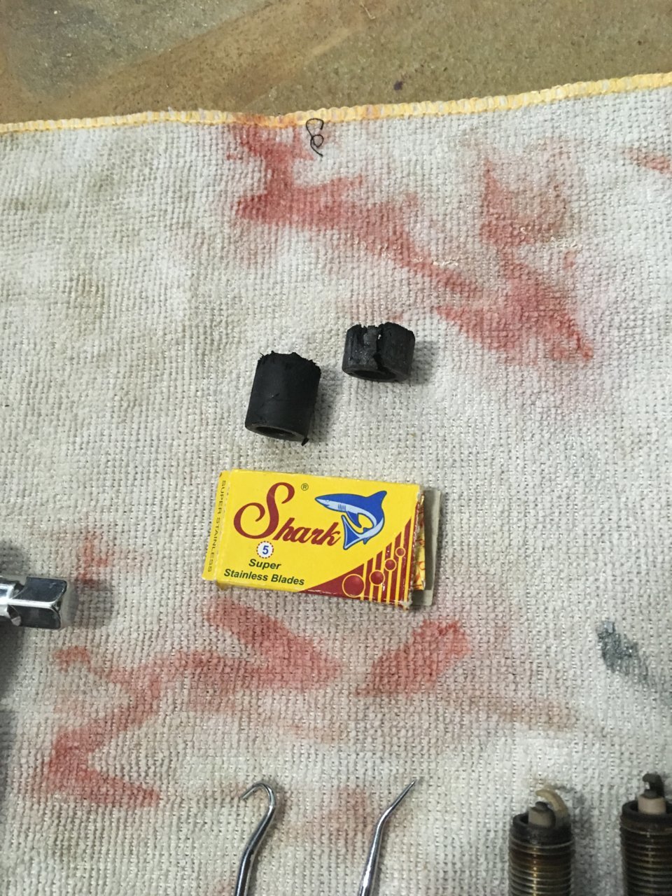

    Just did this. Excellent write up. Everything went well until I got to the driver side. I was using a super old spark plug socket. The rubber grommet iside the socket came off came off and when I tried to insert the ignition coil it wouldn’t seat properly. This essentially lodged the grommet down around the plug and the socket could not engage the plug. It would just spin. What a major PIA. Long story short, I put a DE blade inside the socket to see if I could cut away the grommet and it worked! For the most part anyway. I still needed to pick at the remainder of the rubber, but I got it all out. I went to oreilly and got a magnetic socket. No more rubber. Other than that, it went smoothly.C959C36E-E10B-4A2A-A91A-5BDF8124487E.jpg157A63F5-9AB8-4B0D-8541-7482382C9BE2.jpgD96EBD7A-8425-4D11-9DC3-C2AA8290F7DA.jpg

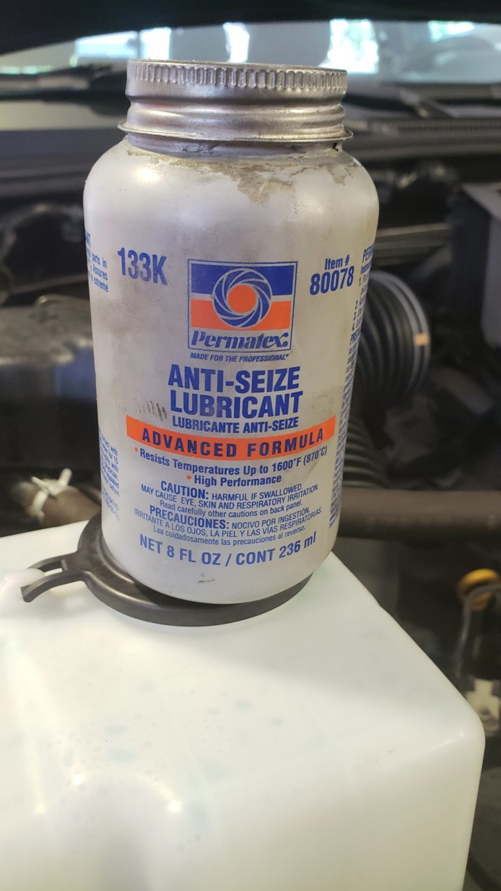

    Hey guys.
    I'm doing my plugs for the second time. I used anti-seize the first time. When I pulled out my 1st plug today it fought me all of the way out.
    Below is what I use. Hi-temp. I use it on my wheels lugs as well and those spin off no problems.
    Should I forgo the seize for the new plugs? Maybe get a different brand of seize? Thoughts anyone?

    Denso and NGK actually say not to use antiseize. I, however, still use a small dab of that exact type, and have not had any issues over 3 different Toyotas.
    Also remember that antisieze will affect torque values. On the spark plug, the torque is needed to crush the washer. It looks like you used a lot of antisieze, and you have have effectively over-torqued the plugs last time.
    Unless it had been in there a very long time, not sure why it would fight you unless there is damage to the threads or there is a lot of fouling. I'd at least chase the head threads with a new plug, no antiseize, a few times to see if you can clean up the head threads a bit before committing to the final install and torque. If that doesn't' make it smoother, get a real thread chaser to clean it up.
    But why in gods name you'd use antiseze on your lug nuts is beyond me. That seems very unsafe.
