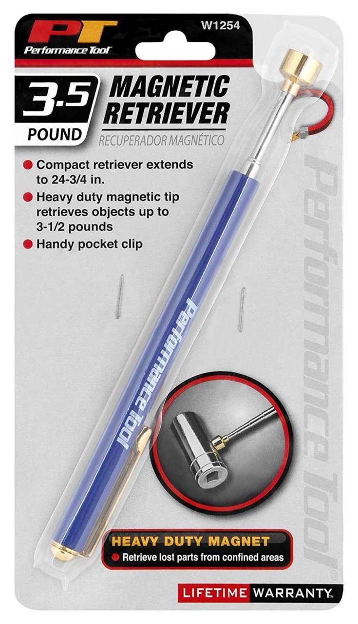

    Another big thanks to my hero, Chris4x4, for such a useful thread. At 34,000 miles on my 2014 Tacoma, it was time to do this and it went without a hitch — thanks to this thread. Honestly there was one hitch. The clip on the end of my vent hose fell off and on top of my skid plate.
