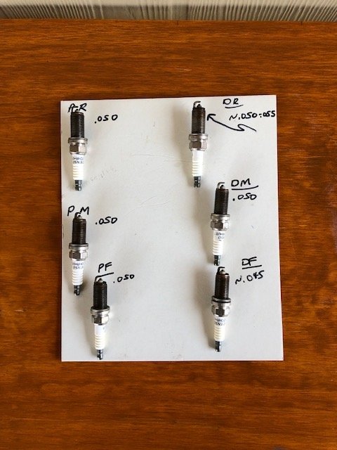

    Finally got around to swapping my plugs out. Truck has 80k miles, original plugs were still in it. After removing them, they all gapped around .054 (that was the closest wire I had and it fit snugly in almost all of the gaps). The new plugs seem to have smoothed things out a bit.
    Used a magnetic spark plug socket with an extension on it that made life much easier. It was my first time doing it so I really took my time to make sure i didn't screw it up and double checked my tool count at the end. Took about an hour and a half. Next time will go much faster.

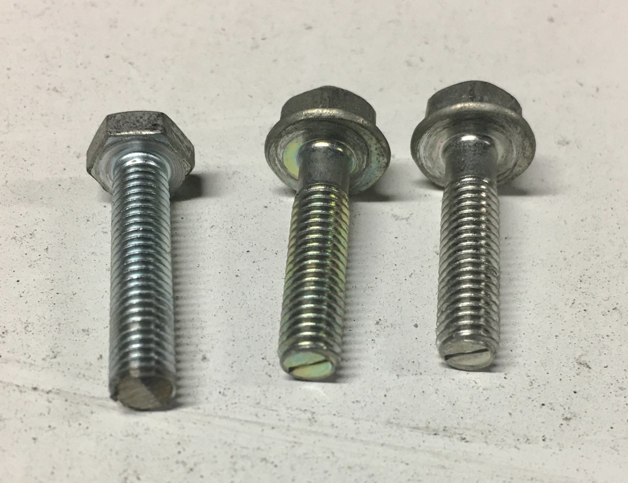

    Just did mine at 47,000 miles assuming that the previous owner (who only put 24,000 miles on it) hadn’t already done them.
    Started pulling the driver side coil packs and found a surprise. One of these things is not like the other... and looks like it was cut-off using a dremel.
    Guess the previous owner had a shop change the plugs early, and they lost one of the origina bolts in the process.

    Those things break super easy if over-torqued. Ask me how I know...

    IMG_0116.jpg Yesterday I changed out my plugs. I followed chris4x4's excellent and well detailed tutorial to a tee. I went +60,000 mi. on this second set of plugs(my selling dealership did the first plug change). My mileage was 120,440. Next change will be 30,000mi or ~150,000mi.
    I was methodical. Took my time(~2.5 hrs). Others have finished much quicker than me. Since this was the first time I had done this I wanted to make sure I wasn't making any grievous errors.
    I did one plug at a time. The only difficult one was the driver side front. It took a few more minutes to access. A small screwdriver + the long needle nose pliers got it done. Extensions were a must. I lubed the gaskets on the coil assembly with silicone and used dielectric grease on the boots. A small amount of anti-seize for the plug threads. Things started off on the wrong foot when the first plug fell out of my spark plug socket onto the concrete. Arg! The plugs were torqued to 15 ft.lbs. My 3/8 torque wrench would not accommodate the torque values for the coil bolts. I carefully hand tightened those. The electric tape on the extension to spark plug socket worked very well. All the plugs came out without any issues.
    All in all I felt great accomplishing this relatively minor maintenance item. My chest was a tad puffed out. Changing spark plugs isn't exactly like rebuilding an engine, but it still felt good and saved me money. Thanks again chris4x4!
    The old plugs were all gapped at about .050
