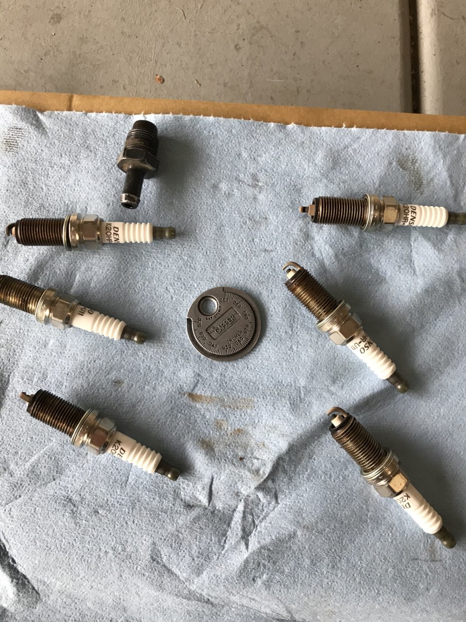

    Same. The Denso plugs I bought on Amazon were “ok”. 4 of the 6 plugs were capped at about .040, the other two I had to gap. They were closer to .035

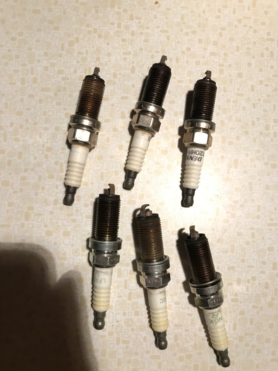

    I'm gonna bite here so please don't beat me up too much for not reading the whole thread. :anonymous:
    I did read the 1st 5-7 pages and the last 5 or so. I have a 2012 4.0 V6 that will trip 50K in a 3-4 more months.
    I'm gonna do the dif service front/rear, tranny drain and fill, flush the coolant as well as change the plugs.
    After all is said and done what is the best choice for plugs?
    Denso one side NKG the other?
    All Denso?
    All NKG?
    Or as long as they're gapped properly does it really matter?

    Doesn't matter. I usually just get the Densos from the dealer. They are cheap.

    I guess making sure thy're properly gaped is the most important. :D
