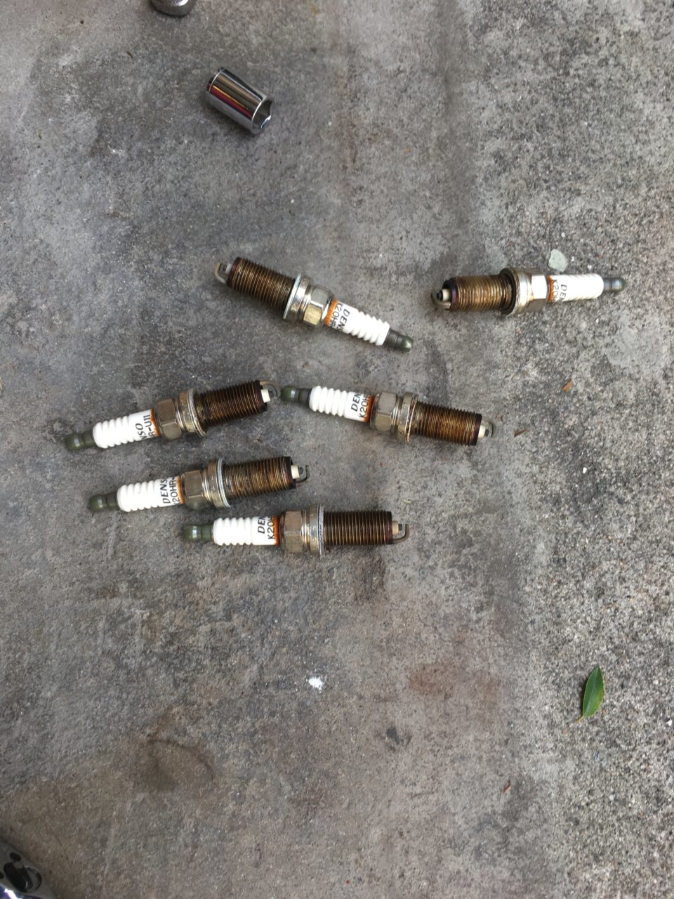

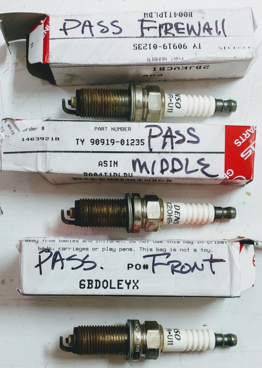

    Did a full 60k service today on the truck. 5w30 Pennzoil platinum, oem oil and air filters, cabin filter, Royal Purple 75w90 for the front diff, rear diff and transfer case and greased all 5 zircs with Lucus Red and Tacky. Then, I replaced all the spark plugs - they were original. I replaced with Denso coppers, all gapped to .041.
    I labeled each as they came out with the location.
    Over all job took about 7 hours, but I went slow and double checked everything as I went.

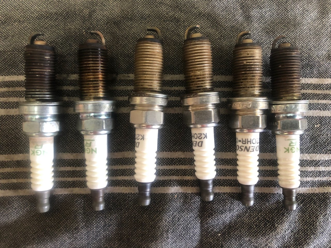

    I did mine today...no idea when they were done last as I bought it about 10k ago, 167,500 currently. They were in rough shape and I did the air filter while I was at it.plugs166k.jpg
  13. May 18, 2019 at 4:46 PM
    #2133
    DrFunker
    DrFunker Well-Known Member
    Feb 3, 2014
    #122158
    42,919
    How is it running now?
  14. May 18, 2019 at 4:48 PM
    #2134
    Freeheelbillie
    Freeheelbillie Well-Known Member
    Mar 18, 2018
    #247669
    1,602
    Billie
    Saint Clair, MI
    2019 Tacoma SR, DCSB
    FRONT END King Stage 3 3” RR Coil Overs SPC UCA’s REAR END King Stage 3 BAMF Shock Relocation Rear AAL Heavy ARB Universal Diff Breather Kit TIRES & RIMS 16” Method Bronze BFG K02 (315/75/R16) ARMOR Demello Off Road Baja Hoop Front Bumper Main Line Overland Rock Sliders w/ Top Plate ¼” Aluminum RCI Fuel Tank Skid RCI Fuel Tank Straps RCI Rear Diff Skid RCI A-Arm Skids RCI – Front, Transmission, and rear Transfer Case Skid DRIVE LINE YotaWerx, BlackHawk Tune Re Geared w/ Nitro 4.56 Package Front ARB Air Locker Rear ARB Air Locker 8” Reverse Clamshell 3.73 & Down Carrier RECOVERY ComeUp Seal Gen2 9.5RS Winch, Synthetic Line ComeUp Seal Hawse Fairlead ARB On Board Twin Air Compressor LIGHTING Squadron-R Pro Amber Fogs (Wide Cornering) Baja Designs Rock Lights Squadron Sport Fogs (qty 4) Baja Designs Bed Light Kit SPODS, HD 8 Circuit Switch Panel
    These actually might be original considering the NGK/Denso combo :notsure:
    ready6delta and TheDevilYouLove like this.
  15. May 18, 2019 at 4:49 PM
    #2135
    Freeheelbillie
    Mar 18, 2018
    #247669
    1,602
    Billie
    Saint Clair, MI
    Soooooo good! It cured the flutter/spark knock issue I thought was "normal" :anonymous: I'll be interested to see if I gain MPG.
  16. May 18, 2019 at 4:49 PM
    #2136
    DrFunker
    Feb 3, 2014
    #122158
    42,919
    :yes:
  17. May 18, 2019 at 4:52 PM
    #2137
    Freeheelbillie
    Mar 18, 2018
    #247669
    1,602
    Billie
    Saint Clair, MI
    Gap on the ones I pulled averaged .70:eek:
  18. May 18, 2019 at 4:53 PM
    #2138
    DrFunker
    Feb 3, 2014
    #122158
    42,919
    whoa.
    :laugh: Yeah, you should see some results.
  19. May 18, 2019 at 4:57 PM
    #2139
    Freeheelbillie
    Mar 18, 2018
    #247669
    1,602
    Billie
    Saint Clair, MI
    I was only getting 13...so anything will be an improvement. I got better MPG in my 1970 Bronco LOL!!
