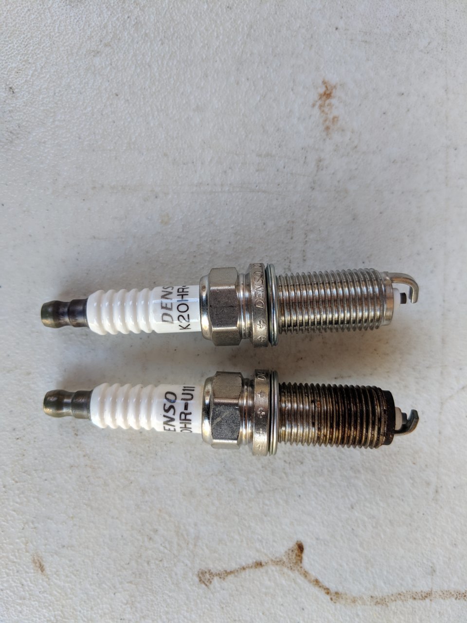

    Old ones:
    New vs old
    Gapped at .040

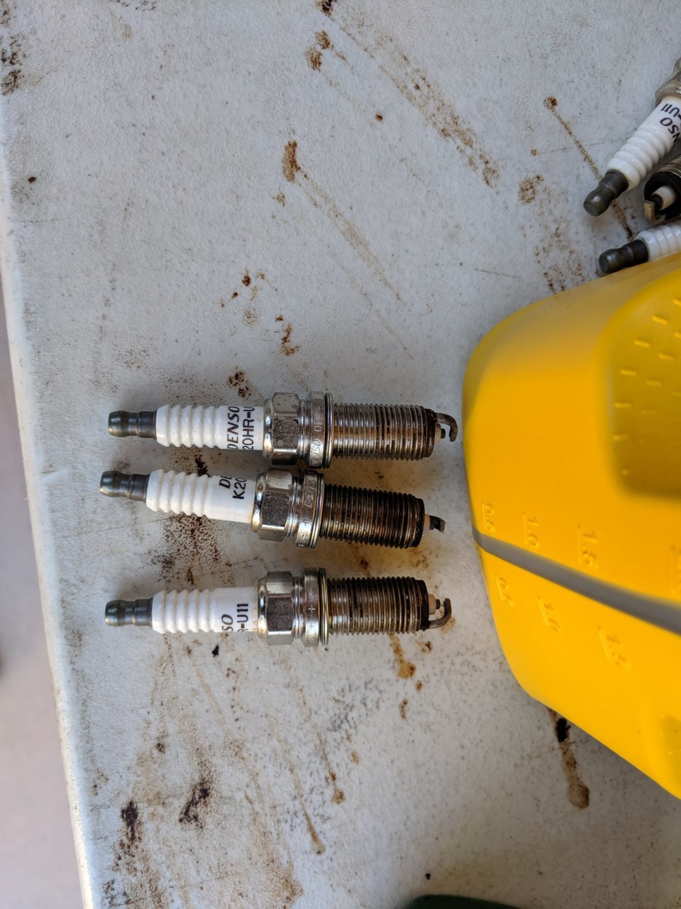

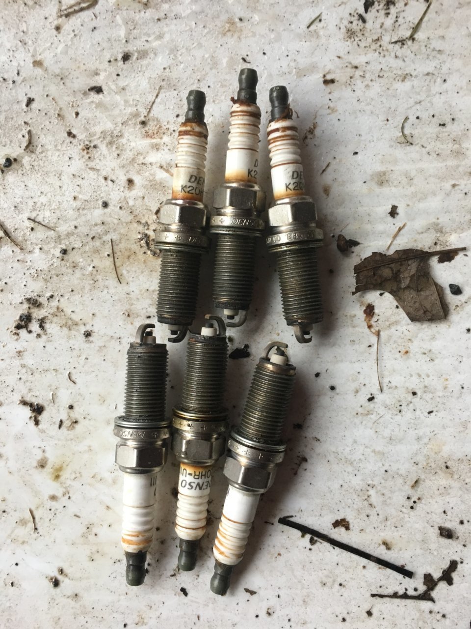

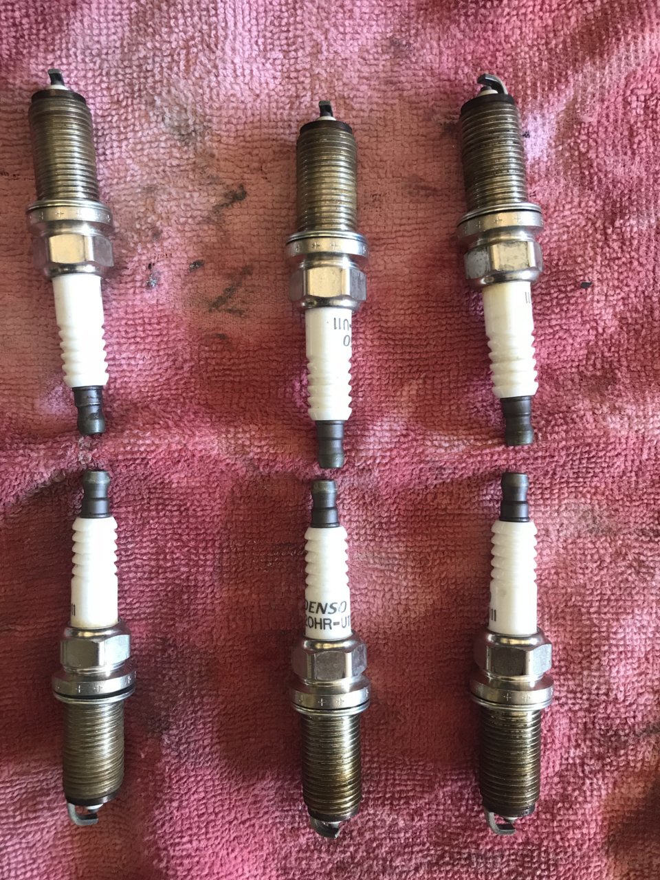

    Changed my spark plugs yesterday. Overall it went pretty good thanks to this thread and everyone’s advice. Had my previous spark plugs changed at around 33,000 miles by a shop (wish I found this thread earlier). Just changed them at 74,000 so they were overdue. Checked all the gaps on the old ones. They were all at .043 except for the driver side middle one which was oddly at .050. They were all densos.
    Do they look good? Anything that pops out that is concerning?
    Top is pass front to rear (left to right) bottom is driver from to rear (left to right)
    Also when screwing in the new plugs is it noticeable if you cross threaded them while torqueing them down? I think they all went in correctly.

    It is difficult to see the electrodes but they all appear evenly colored with nothing of particular concern showing in the picture. If you want to check more closely just do a search on the internet for pictures of how a spark plug looks from a well running engine and you will get your comparison pretty easy.
    As for cross threading, it happens when you first start to turn the plug. If you are starting it by hand then typically it will not turn by hand unless you have it threaded correctly. Cross threading occurs most often when someone uses a ratchet or other mechanical help without tightening by hand first. So, assuming that you were able to thread the plugs in by hand and turn them quite a few turns until they snugged up, finishing them off with a torque wrench to 15lbs then you are all set.
    As for the one spark plug gapped off at .50, that was most likely installed that way and the mechanic who installed it neglected to check all the plugs for gap when they were removed from the packaging.

    I used a magnetic spark plug socket with an extension attached and hand treaded it. It treaded in pretty easily then I torqued them down to 15ft/lbs.
    Yeah that’s what I figured with that one larger gap.
    Thanks for the help.

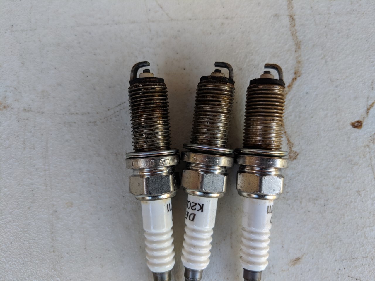

    Just did mine at 70k
    the drivers side plugs were in worst condition as the gaps were pretty big.
    All the new plugs went it at .40 gap.

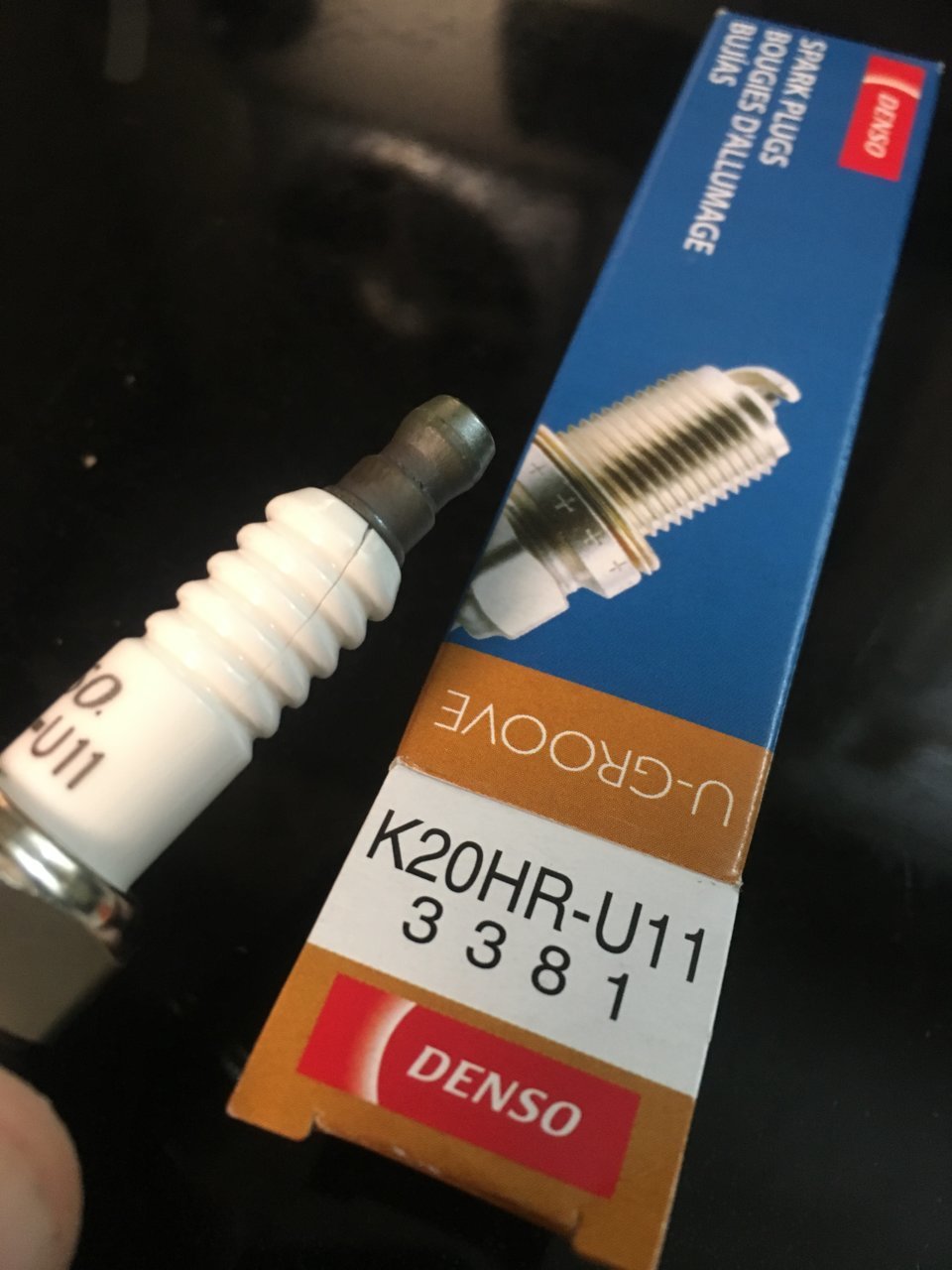

    It’s been about 30k so I got some new plugs from Advance Auto. The porcelain on one of them is cracked. I’ll have to exchange it. Glad I checked!!!

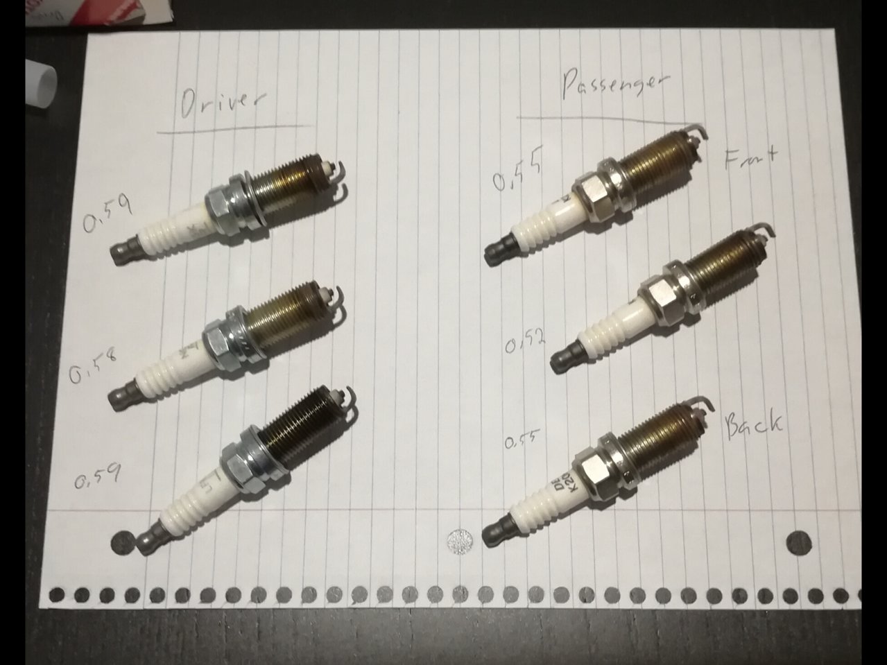

    Just did mine again at 35k. They all gapped right around 45 thousands. I think the brown burning marks are from the dialectic grease that I used last time. I opted not to use it this time.
