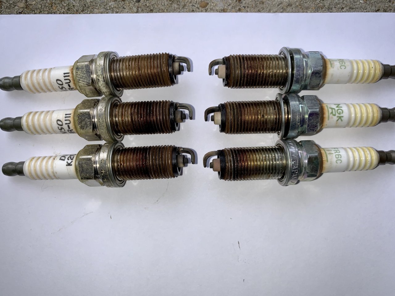

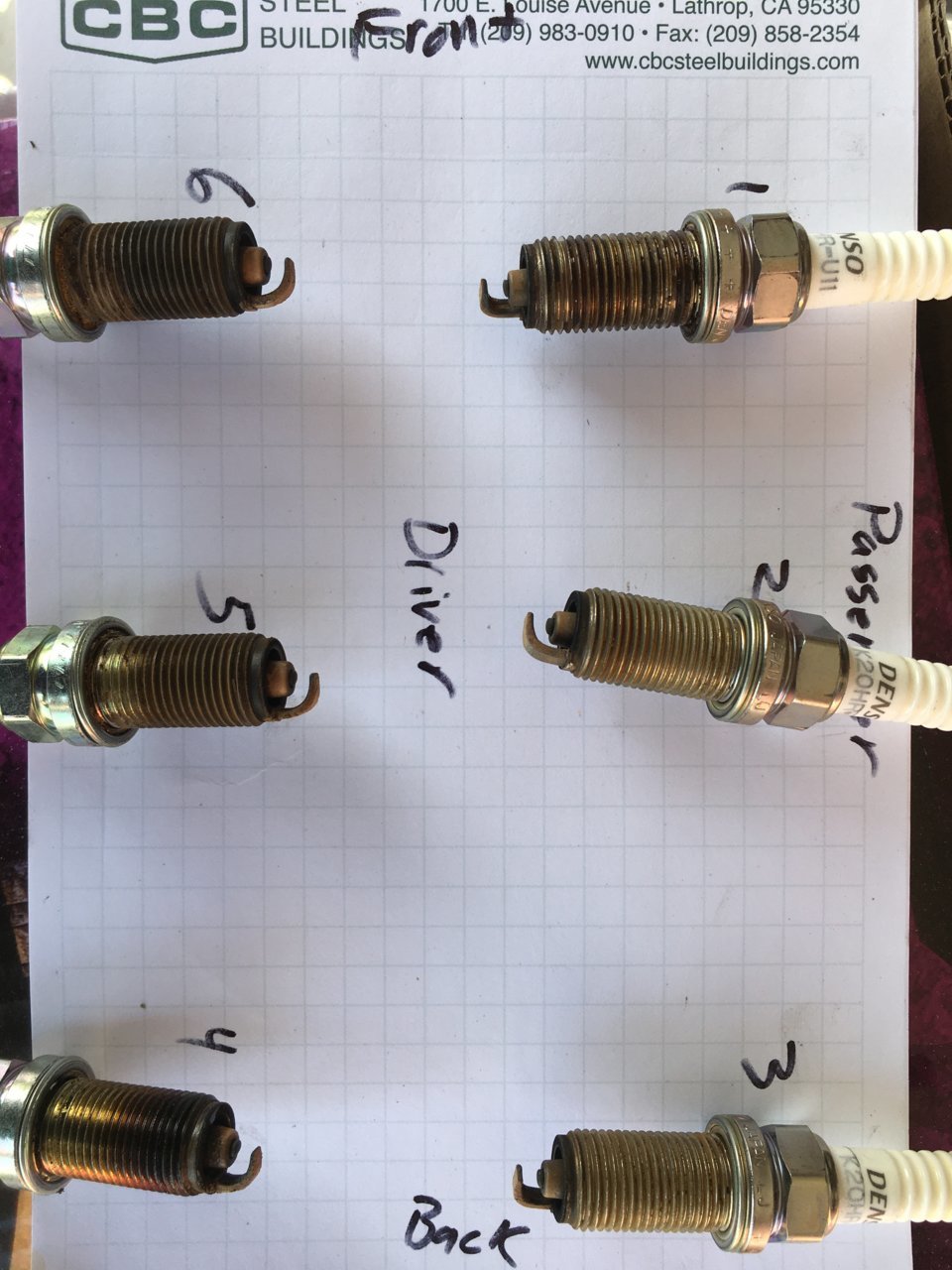

    Another successful change using the info in this thread (109 pages, really? maybe my post will make it 110 - ha!) 65k on the 2013 4.0, Denso and NGK mix, so first change. Noticed all the Denso on the passenger side stayed in the socket when removing, then all 3 of the NGK on the driver side slid out of the socket and required a magnetic stickum to remove. Didn't measure the diameter of the ceramic. The driver side back cylinder was darker on the thread and had a bit more buildup on the electrode than the other 5.
    This is where supply chain overruled engineering - they wanted to keep 2 suppliers competing on price, lowering the risk of outages during manufacture. Somebody somewhere thought it would be just great to use both! The work instruction for the assembly line worker said install NGK driver side, Denso passenger side. The bean counter mess things up for sure, but they do make sure you are able to do your thing in the years to come. Or the more cynical side of me says, NGK had a lower cost, but somebody further up the food chain had a friend at Denso and wanted to make sure they got some business too. Or vice versa. Or I could be totally projecting what happens at my workplace onto someone else's. FWIW, I'm in engineering - and get beaten regularly with the dull cudgel of supply chain logic.

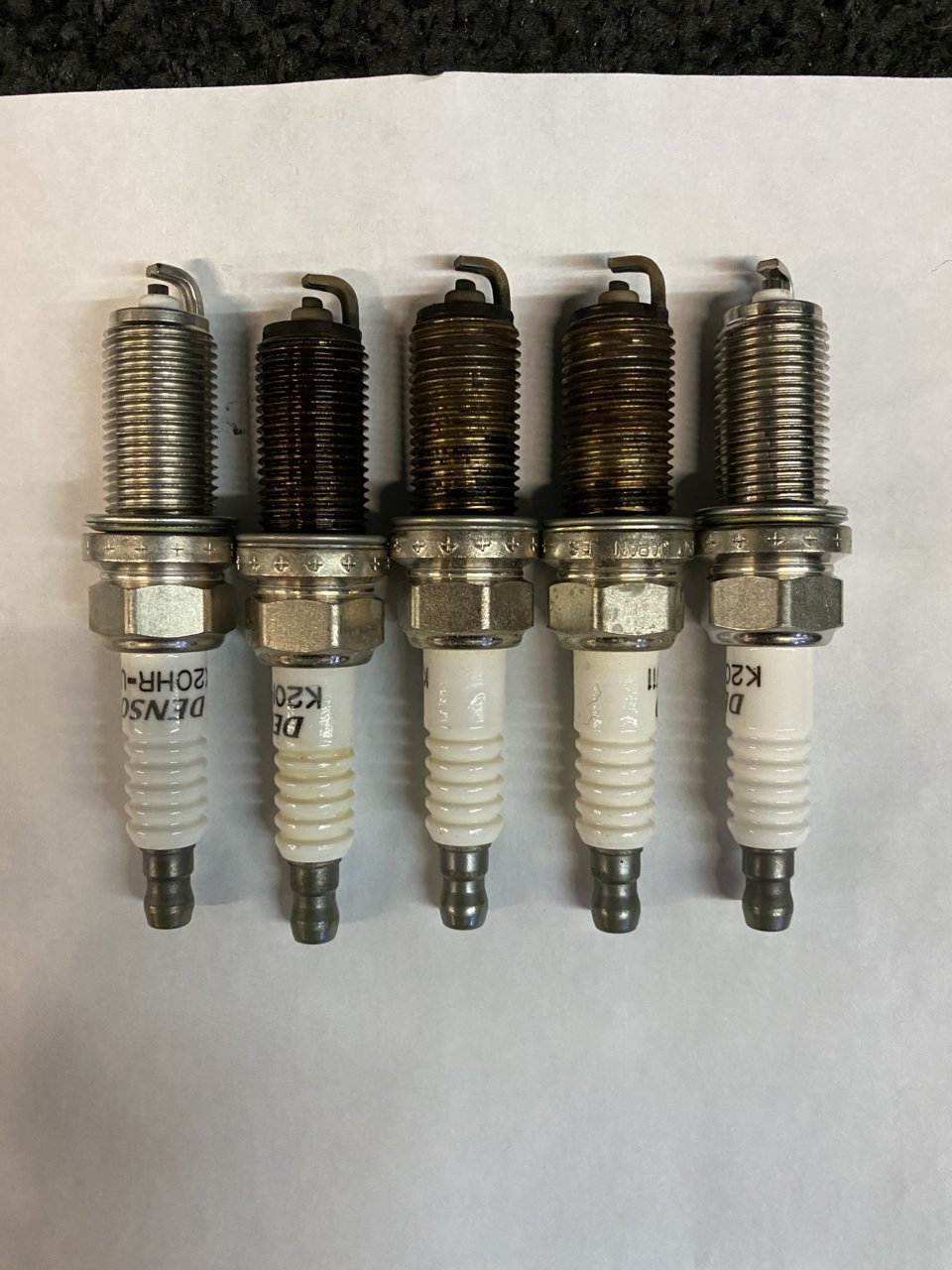

    Awesome and informative tutorial, thanks! I probably wouldn't have tackled the job without this. Just changed plugs in my recently acquired 2011 4.0 with 61K mi.
    The truck obviously had the original plugs. Looked to be in decent shape for their age. Threaded out fairly easily. Driver's side was much more difficult to do because of the obstructions. Gaps of original plugs were all about 10 thousandths higher than spec.
    Replaced with all OEM Denso, and did NOT apply anti-sieze (after much reading). Gapped to about 0.042. Interested to see if I notice any difference after the change.

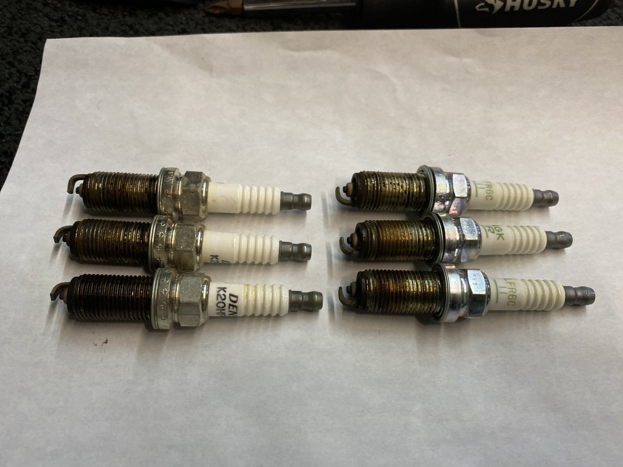

    Do oily spark plugs mean something bass going on? Sorry for the noob question lol
    Just changed my passenger side and they looked like this after 50k miles next to brand new ones. (I know supposed to be every 30k lol).

    Originals changed at 50k.

    40,079
    Go to the first page of this thread and read. I just added an updated link on reading plugs. Yours look normal.
