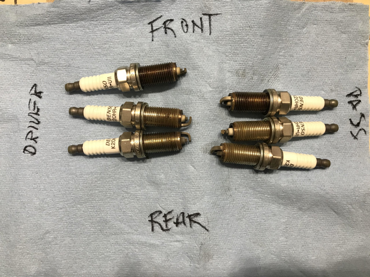

    Yet another rep for this thread. Replaced at 30k, w/ engine at 90k miles. Easy and took an hour. Thanks to all!
    The front two plugs have darker threads than the rest. And the back two plugs have grayer tips than the rest. Normal?

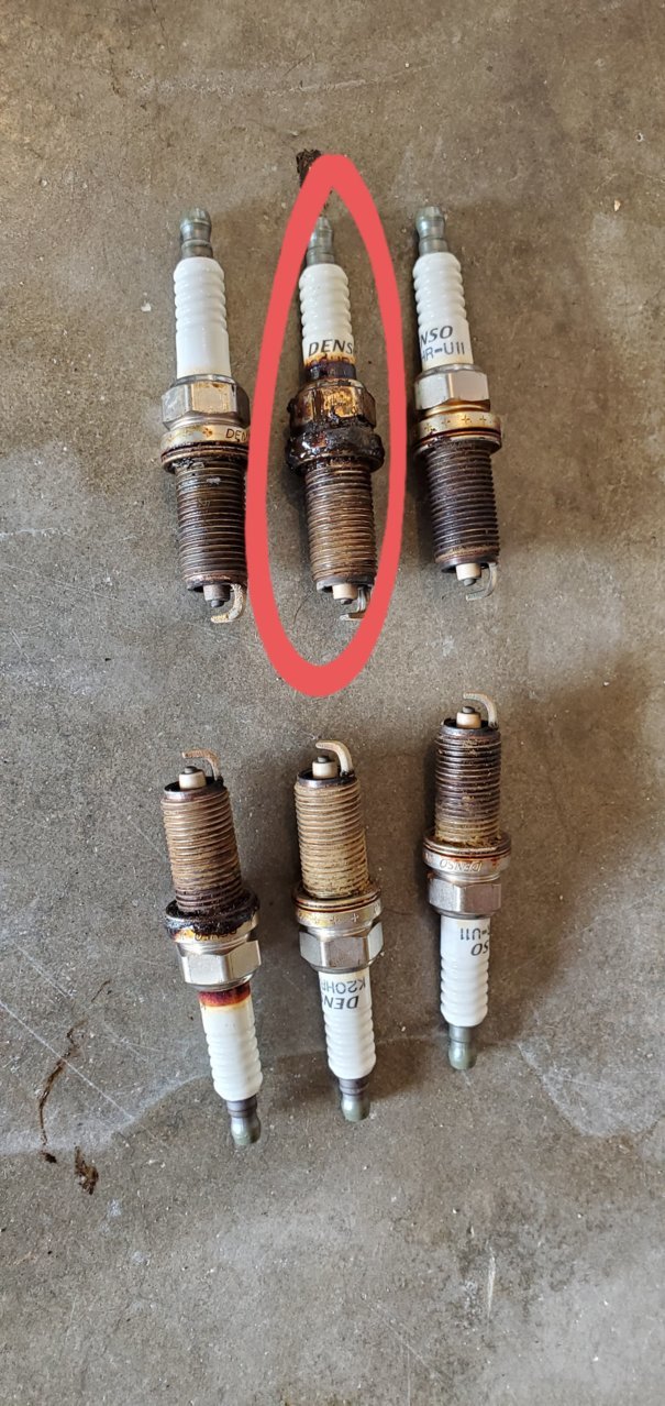

    Finally got around to changing these out, thanks to this write up! Should I be concerned about the plug circled?

    I would just be happy that you were able to get them out. How old are they?
  11. May 16, 2020 at 5:15 PM
    #2191
    Dr3w
    Dr3w Well-Known Member
    Nov 12, 2014
    #142205
    919
    Drew
    805
    2007 White DCSB Sport
    At least 120K haha been meaning to do this for a while but just pushed it off

    Finally checked and I went from 13mpg to 16mpg. Still have my foot in it everywhere. The plugs had never been changed 120k. Noticeable highway difference in effort\smoothness. The gaps on the old plugs were insane.
    Mine were dark at 120k, but yours have been changed before as they are all the same brand. Maybe someone put too much gunk on them. Most of the black is on the exterior :notsure:

    That is what I was thinking as well. The tips themselves are fine, just really worn down. I guess it would be more concerning if the tip looked like that as well. Truck has felt great though. Much smoother like you mentioned
