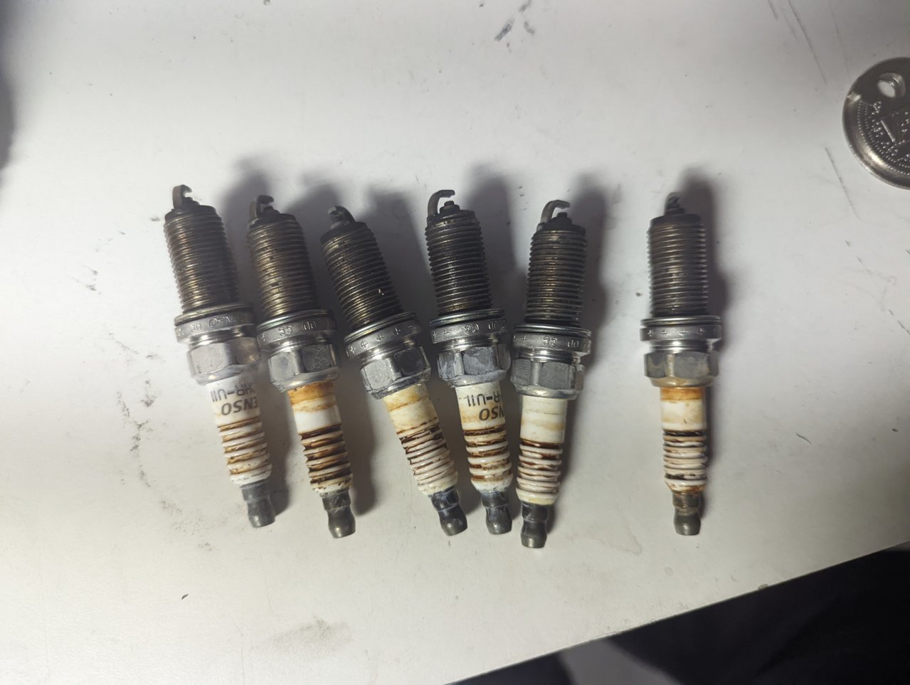

    Changed my plugs and this is how the old ones looked. Should I be worried? The driver side has oil residue on them by the crush washers and base of the porcelain. CE759585-4C15-4141-BD02-6422FD910D38.jpg

    I’m not sure why, but drivers side especially the plug closest to the cab is known for a bit more oil residue. Seen it in several threads. I’d say it depends on on how many miles you have on them and the condition of passengers side also. My drivers side was a lot darker than passengers side when I just changed them at 160k after 40k run time especially the plug closest to firewall. Tips of your plugs look ok to me. I’m no expert, but you probably just had them in a bit too long.

    Yeah I just did a deep dive after posting this. Sounds pretty common. Thanks for chiming in. I had them in for a little over 30k miles.

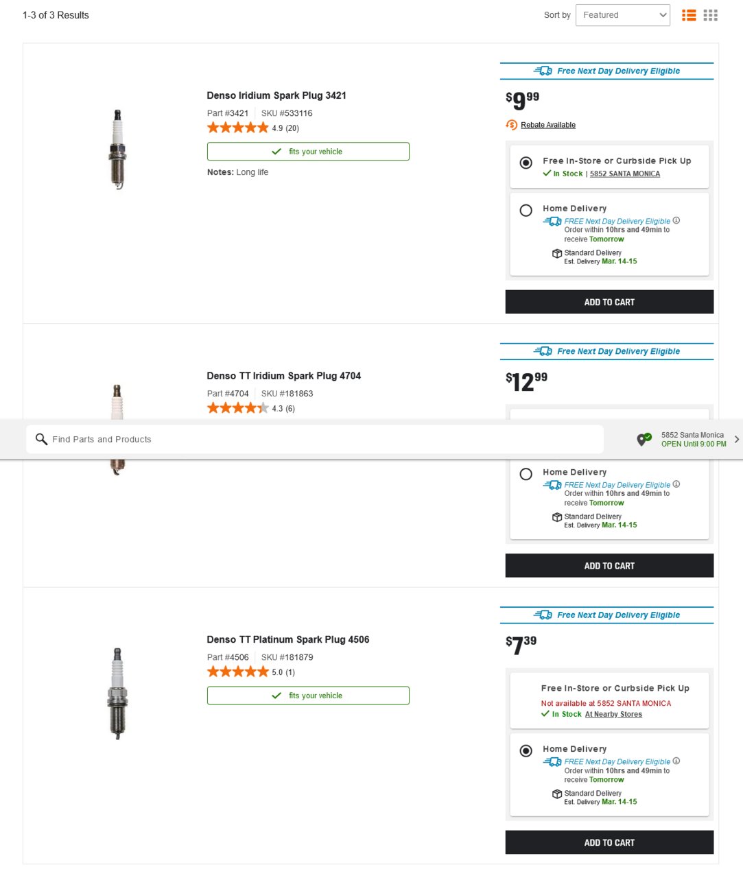

    which of these spark plugs would be best? I'm not sure if the OE Denso plugs are iridium or platinum. Do any of them have any practical benefits over the others? Looking to try this job out soon!

    Neither. The factory plugs for the 1 GRFE engine are regular resistor plugs not iridium or platinum which is why replacement interval is 30k. Get them from a local dealer I paid $32 a few weeks ago for all 6 plugs and check the gaps they were not all pre gapped to spec as they say. I gapped them all at .040 and my truck is running great. I couldn’t find the Denso plugs the factory uses at any auto parts stores. The 4 cylinder engine does run irridiums. But don’t put them in the V6 lot of guys saw decreased fuel economy or were throwing codes. Factory spec for these plugs and the engine is happy!

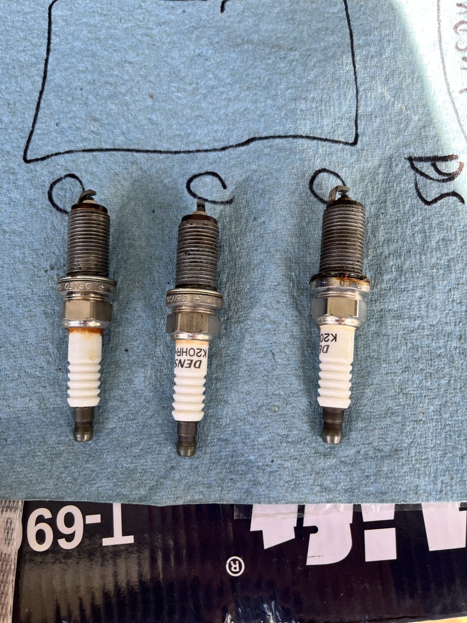

    Just changed these at 50K miles out of my 2015 pre-runner. most gapped at .50 which isn't bad i guess. There's a bit of dried oil on the ceramic though, should I be worried?

    I’d say normal for 50k. First change at 50k or 50k since your last spark plug change? The recommended interval is 30k so you changed them 20k after the recommended interval 2/3 away from double the recommended interval. Your gaps were quite a bit over factory spec which is .039-.044 so your engine was not running optimally. Probably just carbon buildup on the ceramic they look fine to me for the mileage just do them closer to 30k next time. I bet your truck is running way better and your gas mileage is improving!

    2nd change to my knowledge? I bought the truck with 34K miles on it, changed it myself at 65K, then just yesterday at 115K. I think i was motivated by recent gas prices to change them again ($40/day in Socal just to go to work ($5.50 gal, 120mile commute)! I was getting 17.5mpg, when I used to be able to get 19, so I figured i'd do spark plugs this weekend, then clean throttle body and maf sensor.
