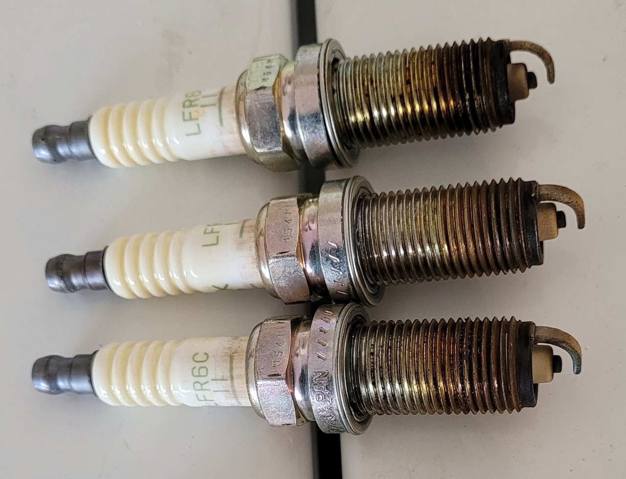

    Just finished doing this job. My first time changing plugs, and this guide was super helpful, so thanks for the write up, and all the advice in here. It was good to get in there, and do this maintenance. I cleaned my intake tract as well, cleaned my filter, the MAF and the throttle body.
    Aside from the socket getting stuck it went smoothly. It seems the plugs have been changed before at some point (before my ownership), since all 6 plugs I removed were Denso (I haven't changed the plugs since I bought with ~94k miles, i'm currently at 145k.) They all looked fairly normal, except for the middle passenger side, which had some oil on the threads. I don't know exactly what that means, but I'm pretty sure they're not supposed to have oil on them, so I'll look into it when I have some more time.

    Finally did my plugs today at 90k mi. Bought the truck at 50k, but I'm thinking these might not have been changed at 30k as they still were the 3 Denso / 3 NGK combo. I had never gotten around to it since 60k when I bought the plugs and tools heh. It was much easier than I thought, only taking a little under 2hrs for my first ever time working with spark plugs. Can't wait to do our 17 Corolla where all 4 are right there on the top with zero obstructions!

    Replaced my plugs today, and the air cleaner. Actually, my buddy came over and did it for me. Cost me a beer. Just over an hour. He did the work while I played with the plugs: the new Denso plugs were in spec between .039 - .043, but I pulled them all a bit closer to .041. First plug change, miles on my 2015 at 50,400, old plugs all nicely matured with gaps at .051 - .054. Don’t expect great things from the change, just maybe prevented some poor changes going forward. Oh, by the way, plugs and beer less than $30, local shop wanted $300+ for the job. Works for me.
