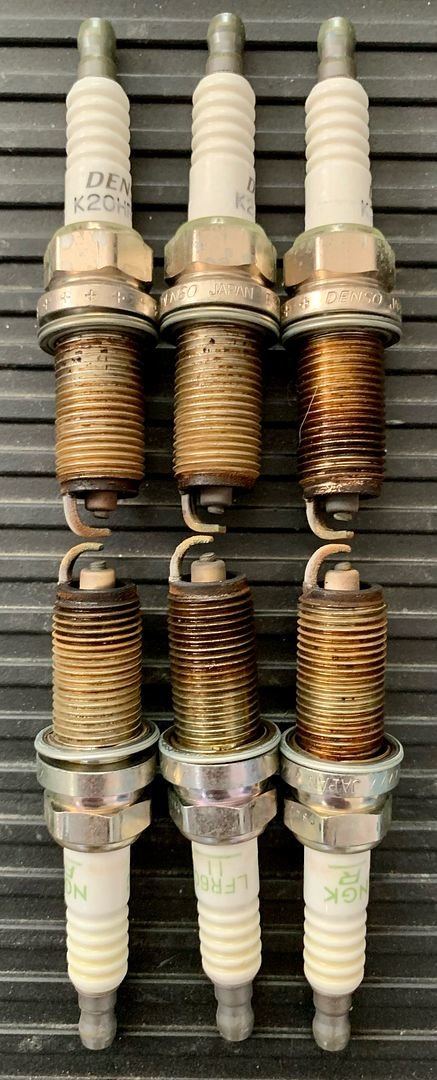

    Just did mine at 90k miles, this was the third time they have been changed but the first time I did it myself.
    The first 4 came out easily, the last two were tight. No metal from the head on the threads thank God.
    One interesting thing is I pulled one of the new plugs back out on the tight cylinder and the sacrificial shiny coating was missing in a few spots. I didn’t use anti seize because denso recommends not to but I think I will pull those two plugs and replace them AGAIN with new ones with a dab of anti seize. The shiny coating missing means no protection from galvanic corrosion.
    I’m a bit OCD about this stuff. Don’t want an issue doing it again in a few years.

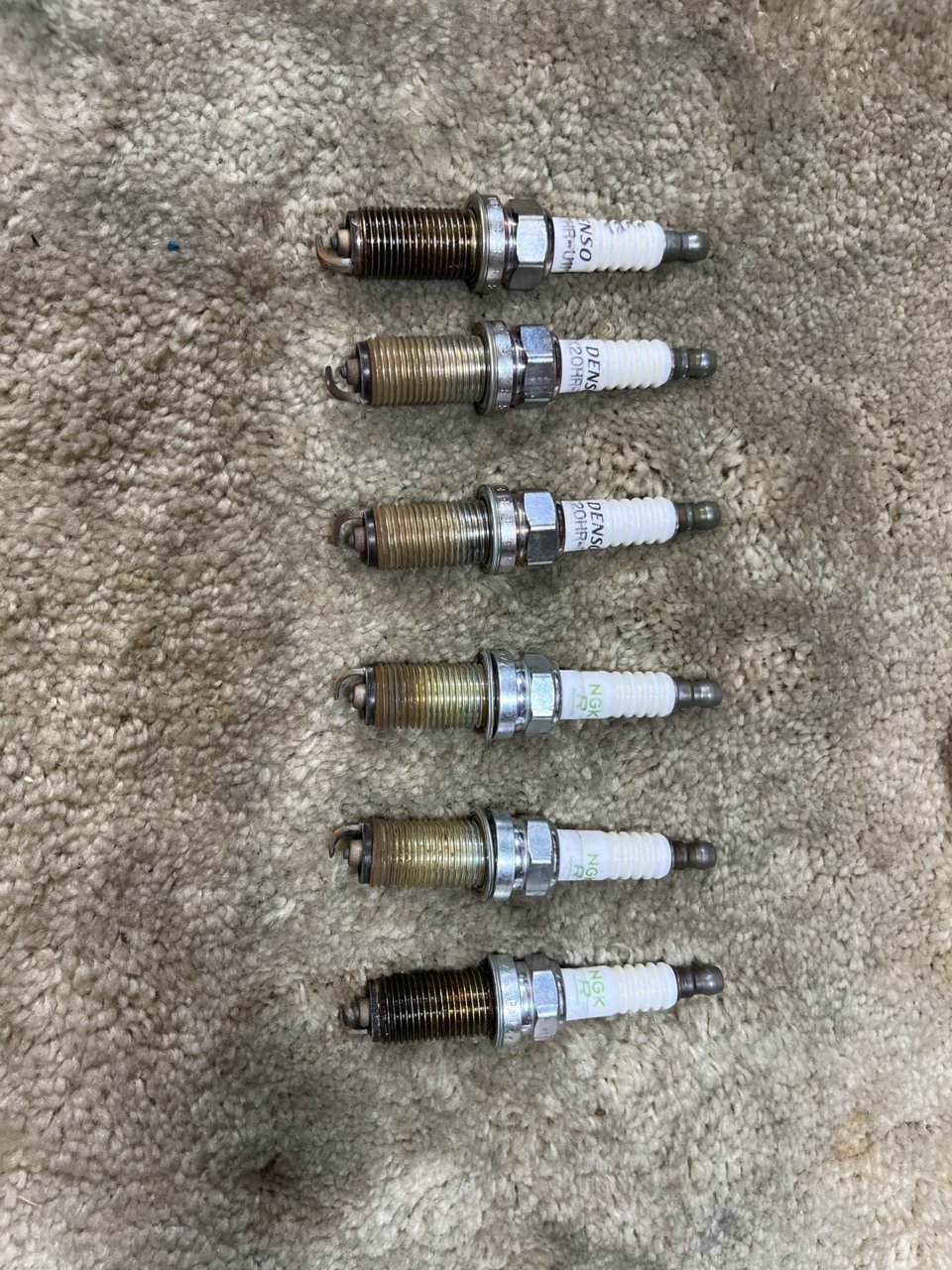

    A few weeks ago I picked up a 2015 Tacoma Limited with 70K miles. I changed the serpentine belt a few days ago and the spark plugs today. The belt was probably ok but now I don’t need to worry about it for a while. The plugs definitely needed a change.
    • I’d guess they were the original plugs from the factory.
      • Four of the gaps were about 0.060”.
      • One was about 0.055”, the other closer to 0.065”.
      • They were half Denso, half NGK.
    • I opted to do all six Denso copper plugs as the original post suggests, sourced from a Toyota dealer.
      • Four of these were gapped to 0.040”, two closer to 0.045” which I regapped to 0.040”.
    • I did use anti seize paste.
      • Information is all over the place on this.
      • I opted to use the paste and reduce the torque value by 20%. Hopefully the engine doesn’t explode:)
      • I only had access to an in-lb wrench. In case anyone needs the information…
        • 15 ft-lb = 180 in-lb
        • I torqued to 80% of that, 144 in-lb.
    • Things to note:
      • Really not much. The belt and plugs are pretty easy jobs if you have patience and the correct tools.
      • You’ll save a boatload of cash doing it yourself. If you don’t have the tools it’s better to invest in them than pay someone else to do this. A Toyota dealership quoted me $800 to do the plugs and $330 for the belt. That’s stupid money for this work.
        • The belt cost $75 from Toyota and took me about 30 minutes.
        • I had most of the tools for the plugs. Borrowed the torque wrench. I invested about $50 in the plugs, and anti sieze, & dielectric grease. It took about 2 hours, taking my time.
        • I’m a hobbyist at best.
      • You can borrow the torque wrench from AutoZone for just a refundable deposit. The rest of the tools are good ones to have in your toolbox.
      • The driver side is much more involved than the passenger side but it’s still not bad. You just need to remove a few extra bolts & clamps then work around some hoses. I’d do the driver side first. You’ll feel like a pro when you do the passenger side.

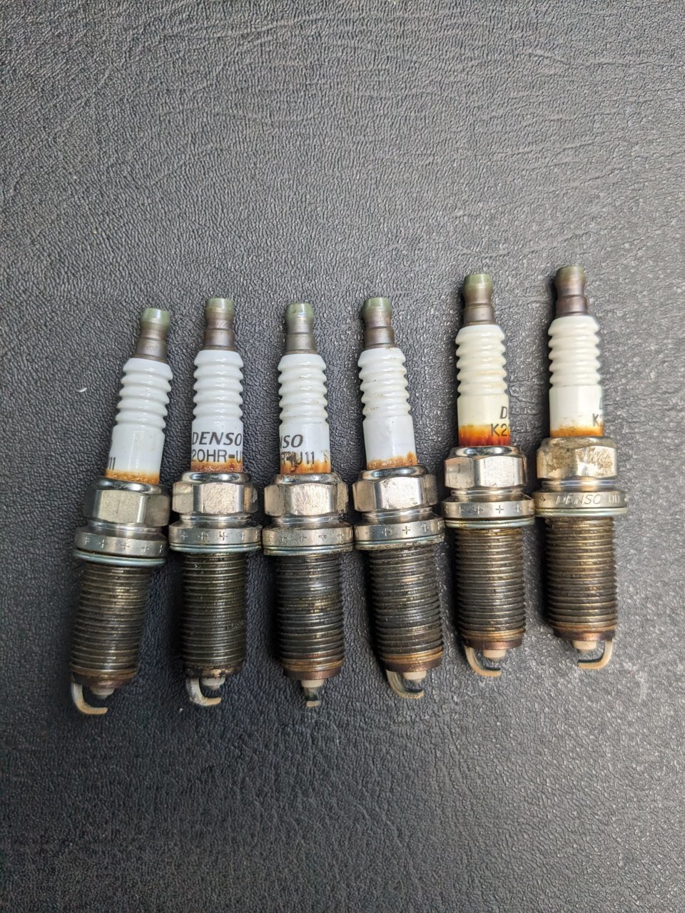

    First time changed plugs at 39,100 with DENSO K20HR-U11
    Second time changed plugs at 78,434 with DENSO K20HR-U11
    Forgot to check gaps in old plugs. I didn’t use anti-seize either time but did torque to 15lbs. Plugs came out fine. I did notice several electrical wire looms disintegrate when I touch them. Anyone have a good replacement before I just electrical tape everything?

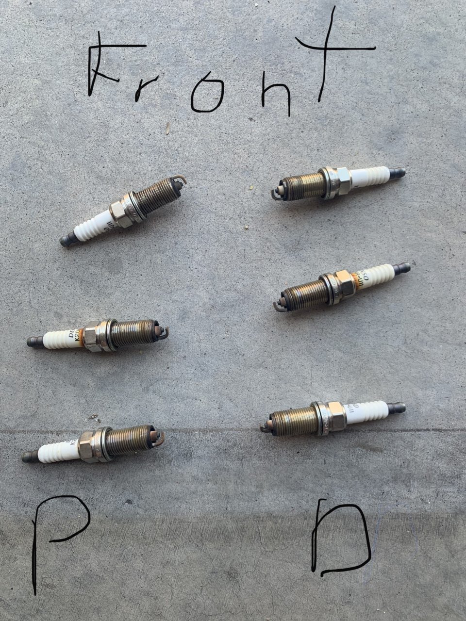

    I shoot Trap with an older guy (76) and he has a 2013 Tacoma V6 4.0L. He bought the truck new and has 220K miles on it now. He never has changed the spark plugs!
    I offered to help him do the job after he got a quote from the dealership for $600.
    The plugs came out without any issues and I honestly think they look good for the amount of miles. The gaps were all .060” +!
    He’s all set and ready for the next 220K.
