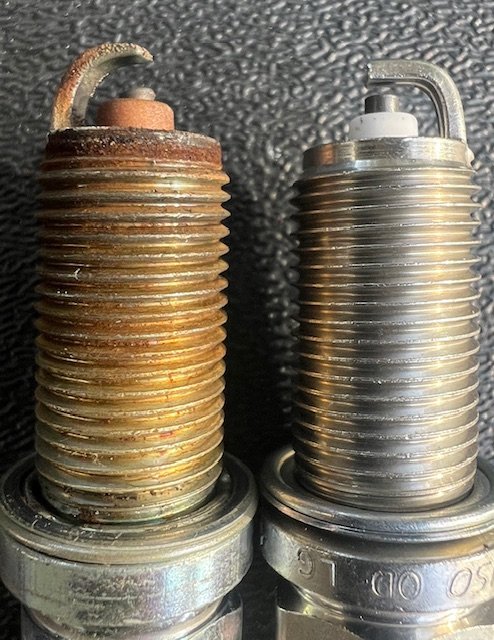

    Really appreciate this guide. Recently purchased my taco with 60k miles so I did the transfer case and diffs and decided to do the plugs as well. Took an hour or two, pretty straight forward. Used denso plugs with a small amount of anti seize. Pulled 6 ngks out so someone must have done it once. Torquing the plugs down was the only part that made me nervous. Used the 15lbs recommendation and everything started up and ran fine on my test drive afterward. Thanks again!

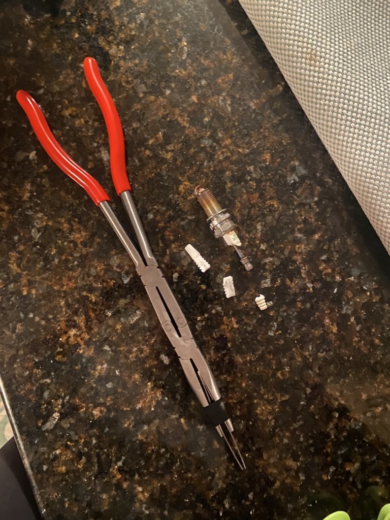

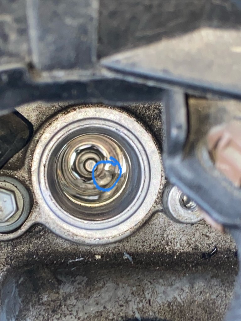

    I just performed a spark plug change on my 2014 TRD OR DCSB with ~ 70k miles. I bought it when when it was at 67k and the plugs had not been changed previously but came out looking ok all things considered.
    5/6 plugs were easily replaced but I experienced an extremely tedious situation with one of them. Somehow the plastic coating sheared off and was blocking my access to the plug head within the cylinder. I managed to fish it out with tweezers taped to long reach needle nose pliers and then removed any particles I saw. Gave me a scare that I did something wrong. But the last plug was removed and replaced after that…
    Truck started up ok and I let it idle for a few minutes and believe everything is ok. But that was certainly a challenge for my first spark plug change.

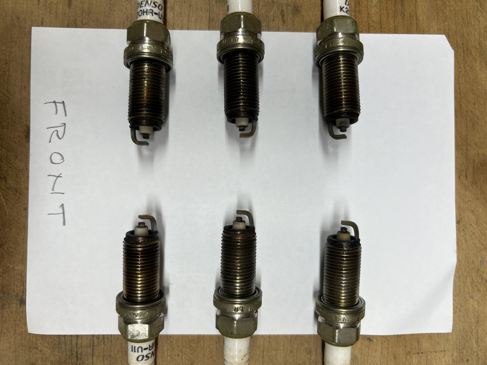

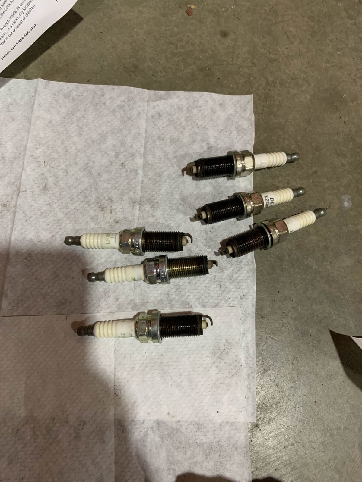

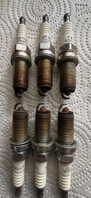

    Perfect write up & directions, thank you Chris!! Good job! I just did my spark plugs on my 2009 2nd gen at 150,507 miles. 3 Denso plugs and 3 NGK, so they had never been done. I have attached a photo of the used plugs.
    One thing to note: my needle nose pliers were not long enough to reach the plugs so I used an extendable magnet, which worked great in tight spots. Truck runs better & even seems to have a little more giddy up in the throttle.
