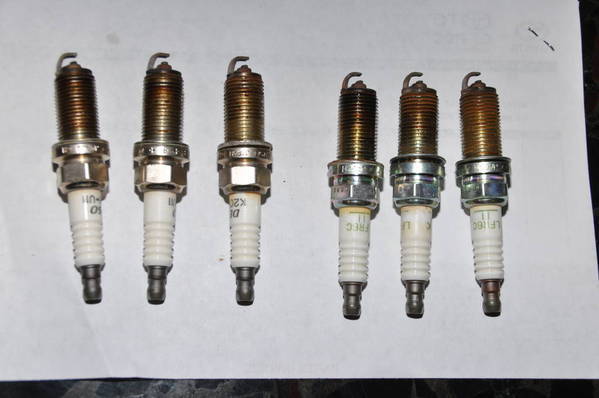

    First off, hat tip to Chris for an awesome write up. I was able to get my driver side without unplugging the VSV, but everything else I followed to a T. Took maybe an hour start to finish.
    I got my Tacoma with 75,000 miles on it. It's a 2007 and I bought it a little over a year ago. It's right around 90,000 miles now, so time for the scheduled spark plug change interval. I pulled the plugs to find, to my horror, that from what I can tell, they were still the original plugs from the factory (NGKs on drivers side, Densos on Passenger side) and they were burnt to hell (understandable after running 3x their designed service interval. Every plug I pulled out was running somewhere between .060 and .070 gap :eek:. Here's a picture of the plugs I pulled out:
    Plugs are in order: Passenger side, back to front; Driver side, back to front.
    The one that concerns me a bit is the rear driver-side plug. It's the top one in this picture:
    It was a little wet on the threads when I pulled it out and the electrode was pretty much gone. I've noticed my 'Taco Tick' getting a lot louder before the tune-up, so my guess is this plug had stopped firing and I had a dead miss in that cylinder causing the wet plug.
    The truck doesn't use any oil between changes, so I don't suspect a valve or ring problem.
    What do you guys think? Something to be worried about? Or pretty normal for a set of completely worn-out plugs?
    Cheers.

    Given the milage on the plugs, Im gonna say thats "normal". See what they look like at the next change.

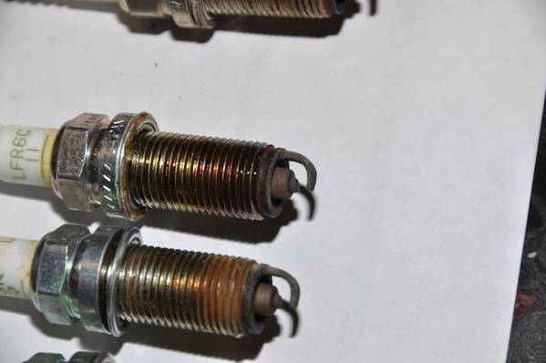

    Excellent walk through Chris! If you have some sort of aftermarket Air box (AFE, K&N, TRD) its even easier. I took my time and spent about an hour doing this.
    I was unsure if the previous owner had changed the plugs, so I started on the drivers side, figured if I pulled out a denso, I would just screw it back in and wait for 60k interval.
    However, The previous owner did not change the plugs at 30k. Still had NGK on the drivers side and Denso's on the passenger side.
    After changing the plugs, I measured the gaps and figured I would post some info here.
    On my truck with 46150 Miles, here were the gaps on my plugs. 1 is the plug closest to the radiator, 2 is middle, 3 is closest to the cabin.
    (C2) Drivers 1 NGK - .053
    (C4) Drivers 2 NGK - .054
    (C6) Drivers 3 NGK - .053
    (C1) Passenger 1 Denso - .047
    (C3) Passenger 2 Denso - .049
    (C5) Passenger 3 Denso - .049
    Clearly the Denso plugs don't wear as fast, and I will make sure That is what I use in the future. Color was normal on all plugs, truck idled smoother, about to take it out and enjoy my favorite beverage.
    This picture is worth a thousand words, and I don't mean describing everything going on. I simply mean the swear words that come out of my mouth when I can't get the Plug socket off the plug after putting them in!
    Electrical tape FTW!
