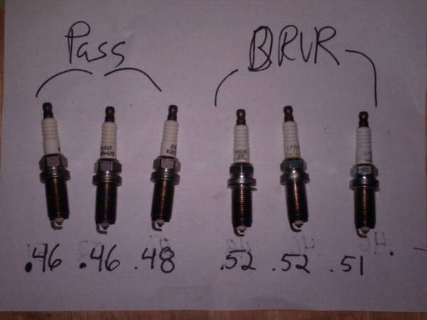

    hey dude did your truck have the same plugs all the way around? I have a 07 taco and half were NGK and half were densos. are they supposed to be like that or were they smoking pot when they put mine in. My taco was made in mexico.

    All Tacomas have NGK's on the driver side, and Denso on the passenger side from the factory.

    so when i replace mine, i can put all ngk's or all densos right?

    You should use the Denso's. THey hold a gap better than the NGK's on this engine.

    Just did mine today. Holy crap my gaps were awful...i'm at 60,000 and i had my 30,000 done at Toyota in Carlsbad CA...Do you think they didn't even change them when they said they did? These are pretty big gaps for only 30000 miles.
    Also it seems the NGKs wear a lot faster than the Densos.
    These are the gaps:
    Passenger Driver
    Denso NGK
    55 64
    56 65
    57 64
    Here's a pic. their color seems to be normal but my driver's side was a lot darker than the passenger's side
    Also i didnt get the plug that was K20HR-U11 i ended up with the PKH20TT...
    is this alright or should i have went with the normal one or does it even matter...no better no worse??

    Interesting....This is the first I have heard of them putting back NGK AND Denso plugs at the dealer. I would bet they didnt change them.

    Its the Denso Platinum plug. Only thing is, it will hold the gap longer than the regular ones. You can go longer with the change.
