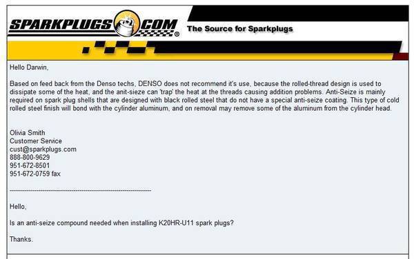

    How necessary is the anti seize? I've never added that to my other two cars that I dd the spark plugs on.

    Sure will make them easier to remove the next change,if you break one down in that hole you will be taking it to a dealer to fix,unless your a mechanic.

    Interesting info on the use of anti-seize compound. What do you think?

    Not sure. I still apply a little anti sieze, and have had no issues with it. Im not wanting to test it to see if they end up fusing to the head.

    Wow ! This is a 180 from what I've been told since they started using aluminum.:eek: I hope someone will test this out. If the plug bonds to the head and snaps off it will help me make my decision.:D Thanks.

    Iridiums are supposed to be changed at 100,000 miles. They may be welded to the block by then - dissimilar metals. When would you change them to avoid this ? And now the post above says not to use anti-seize so how do we stop them from welding to the block ?
