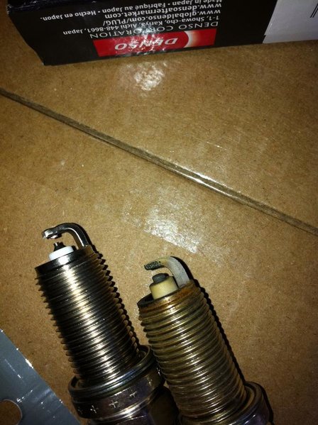

    Changed mine today. Thanks for write up made it real easy. Here's old one compared to new

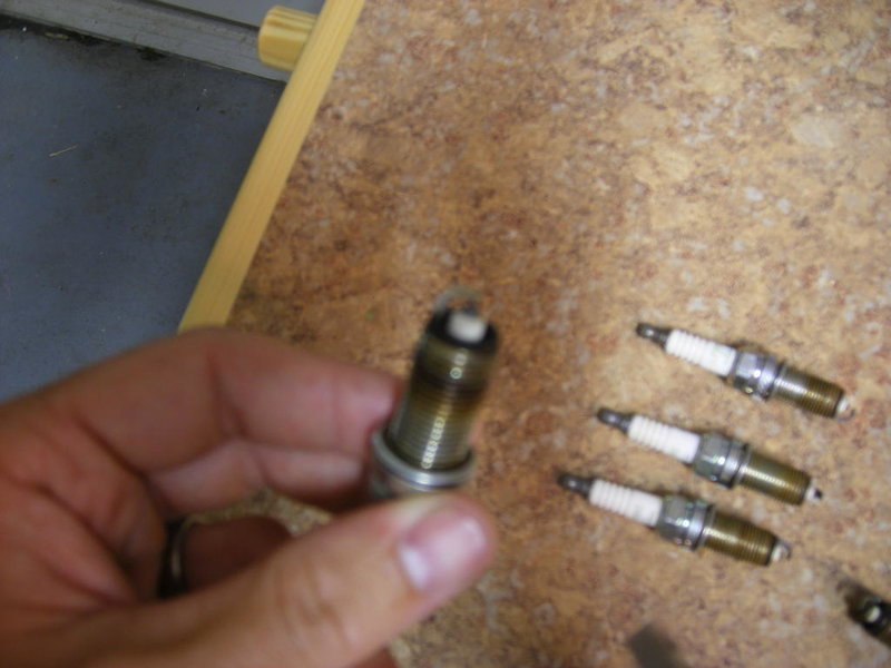

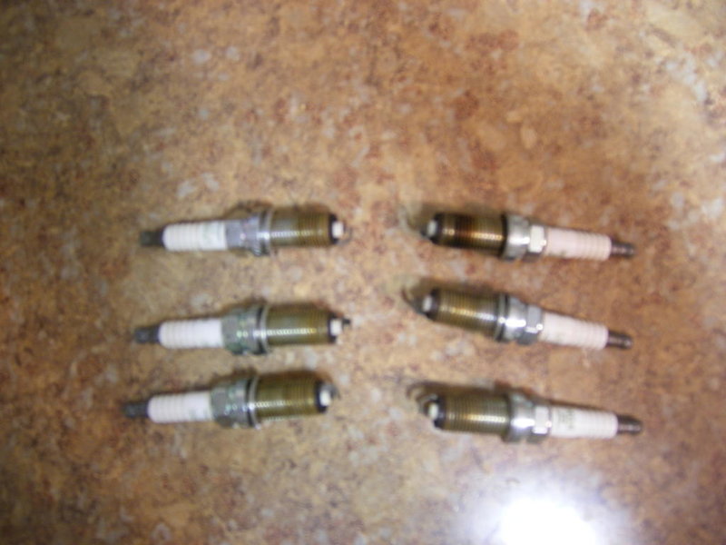

    I need some input on this one. My post inspection of the old plugs has revealed something I'm not liking. The plug closest to the driver (when facing the front bumper, it's the back right one), looks different. Different in a bad way. Seems it's got some oil or "wetness" to it. Any suggestions
    for a next step to diagnos the potential problem? Can't be good. :eek: See photos:

    Ive noticed that a couple times on other trucks, as well as mine. Doesnt seem to be causing an issue, and I cant see what would be causing it. As long as its not on the end, it shouldnt be a big deal.

    could it be the o-ring/gasket thats under the valve cover leaking
    getting oil on the plug

    Could be, butI have never seen them leaking enough to justify pulling the VC and checking. A little oil doesnt hurt anything. If it were gummed up, or shown excessive oil, then I would consider addressing it.

    Thanks fellas for the input. The gasket seal seems like the most reasonable culprit. Regardless, it wasn't on the end of the plug, so I'm not messing with the valve cover. I noticed the same issue on the same plug at 60k. I just did the 90k. I'll keep an eye on it. I might change the plugs a little earlier next go-around.

    I had the same thing on the same plug. I think its just system sucking oil from the engine vent hose. It happened to be right at that cylinder and my spark plug was oily only on one side
