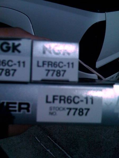

    so the guy at carquest told me to use these since they are"recommended" paid about $90 ...now my question is? should i return these? since i just read the entire thread lol.

    yea def chris4x4 thank you for all your help. on the TWLIVE thread someone also answered my question. good thing I checked on here because I was about to down my truck and change them out ... would have been pretty salty if I knew these weren't the right ones after I changed them...sigh

    so the closes thing i could get my hands on with carquest was these lol. this will have to do. since i could only exchange.

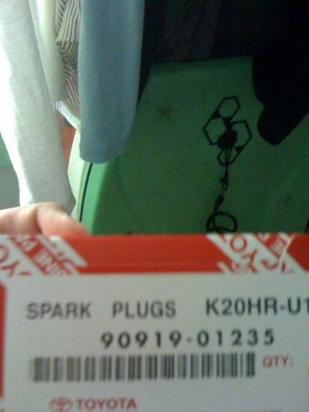

    lemme see if i can go toyota dealer and find plugs there first , if not I will take your offer. thank you sir

    bought these for $31.19 of servco auto parts sand island, HNL.:D
    but then I ended up buying a bed mat too since i was there lol:frusty:
    for $114 ish out the door.
    thanks again Wolf and chrix4x4 for all the help and offer.

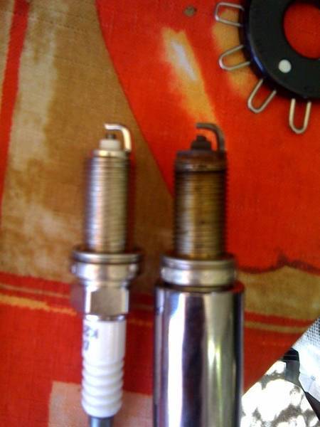

    mine were prettyy used up. finally finished after posting the last picture.
    only hard part was the last plug driver side next to fire wall. disconnecting the coil was giving me quite a headache & it started raining on me.:mad: but overall was easier than I thought. I just gotta fire it up and see what happens lol
