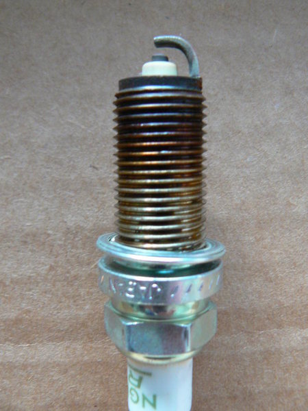

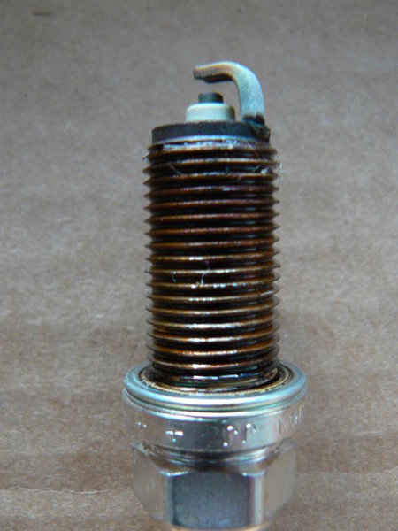

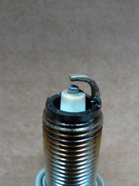

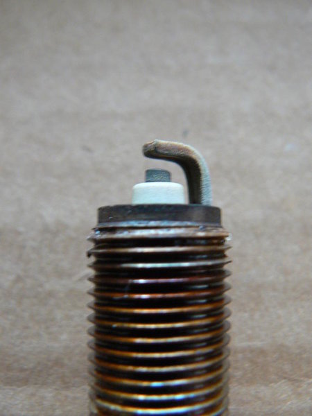

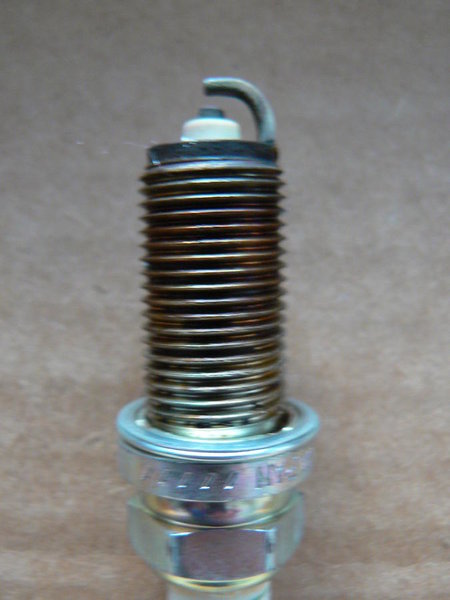

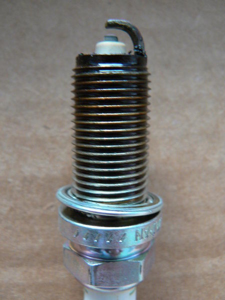

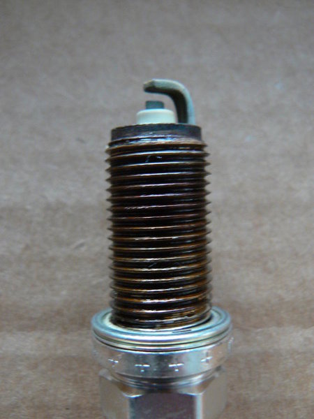

    Just did mine today at 40,000 miles. Took me ~1 1/2 hours and I am not mechanically inclined. The most I do is change my oil. Thanks to this write up, it made the job doable.
    My driver side plugs (NGK) were gapped much worse than the passenger side plugs (Denso).
    Driver's side front - 0.052
    Driver's side middle - 0.053
    Driver's side firewall - 0.053
    Passenger side front - 0.048
    Passenger side middle - 0.047
    Passenger side firewall - 0.047
    Here are some pics. That is not wet oil on the plugs. Should I be worried about the condition of these plugs?

    Plugs look good for 40k miles.
