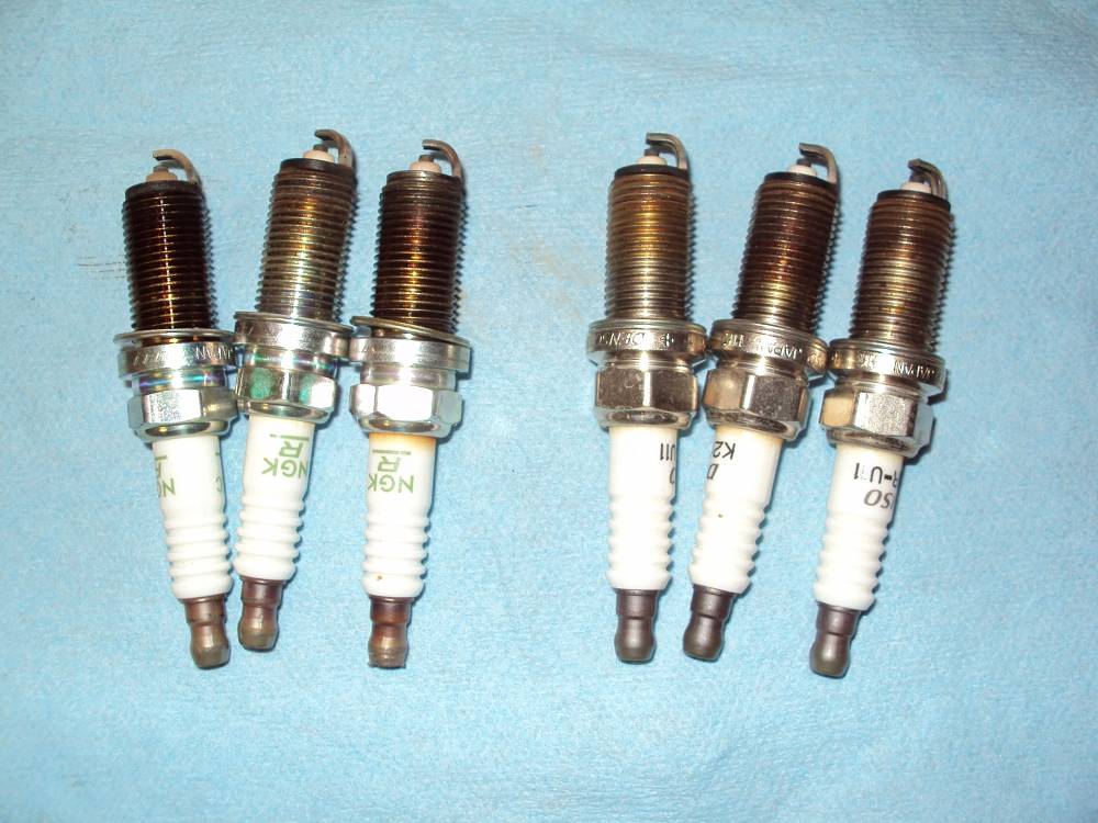

    Did mine today. Took about 90 minutes start to finish working at a relaxed pace.
    A few notes:
    - If running TRD Cold-Air (Old Version), removal of the air intake assembly and engine cover is unnecessary. Nice, saves a little time.
    - Unclipping the VSV connector and its cable bracket isn't technically necessary. There is clearance to work around them if you have sufficiently girly fingers (apparently I do).
    - I feel Toyota may have overtorqued my factory plugs. They took a LOT more force to break loose than to torque the new ones into place, although since Toyota did not appear to use anti-seize from factory either, this simply may have been lack of lube. Before anyone asks: I had my torque wrench calibrated less than a month ago, I know it is accurate. (EDIT: Chris4x4 has since informed me that crush gaskets often do this. Likely nothing to worry about.)
    - All 6 new plugs (Denso, part # in Chris's OP) were gapped at the top end of the tolerance out of the box (.043 to .044). Since plug electrodes corrode with time and therefore widen the gap, I opted to close all the gaps to .040. I note this because the parts guy at the dealership said "These are pre-gapped, you won't need to adjust them or check them or anything". I replied that I always check part tolerances, but thanks for his input.
    Glad I checked. So I don't care what ToMoCo says, check your gaps before install.

    The plugs look excellent. It would seem that my 1GR is very happy and should have a nice long lifespan :)
    Gaps were a little wide (.047 across the board except for a single NGK at .048), but not horrible.

    Technically nothing. But Denso is a Toyota company, for one, and I prefer to give them my money.
    Also, the Densos I pulled out of my engine the other day had better gaps than the NGKs after use, suggesting they hold their spec longer.
