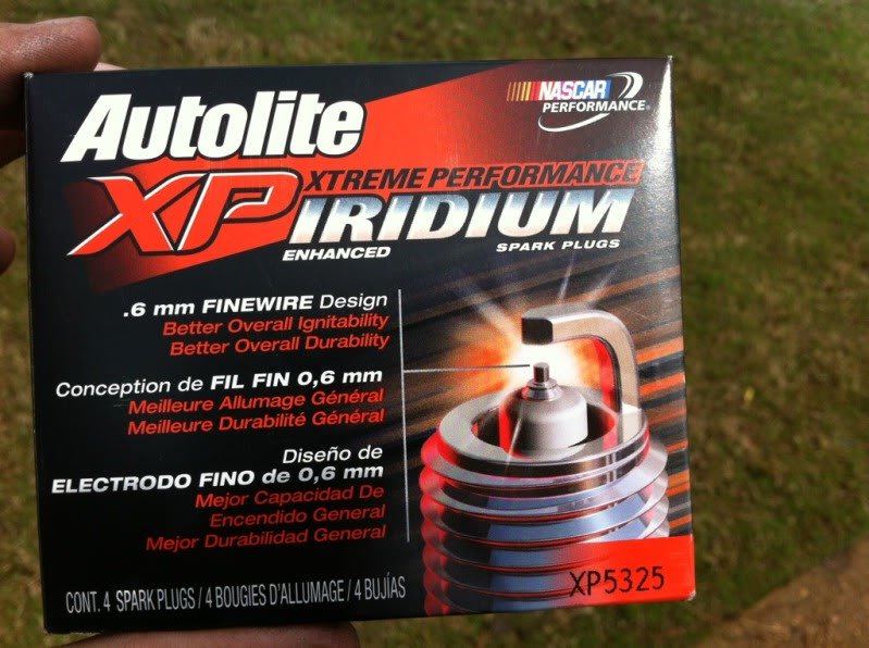

    I'd like to extend a big thanks to Chris 4x4, the guy who started the thread, for taking the time to post up this how-to.
    Your thread definitely made this job go faster and more smoothly for me.
    I only had one 3/8" drive extension (a 2"), so I went and got a 10" extension from Auto Zone ($6.99). The 10" extension worked fine. On the drivers side rear cylinder, I used the 2" in combination with the 10".
    I did loosen the bracket Chris talks about on the drivers side, and I removed the hose. I didn't find it necessary to take the plastic wire bundle stay loose. Since I didn't take it loose, however, I had to be careful not to x-thread that front drivers side plug, since that bundle was in the way a bit.
    I used Autolite Iridium plugs, mainly because that's what Auto Zone had in stock for the truck ($6.99 each), but also because I don't want to have to do it again any time soon:
    The Autolite plugs were pre-gapped (.041").

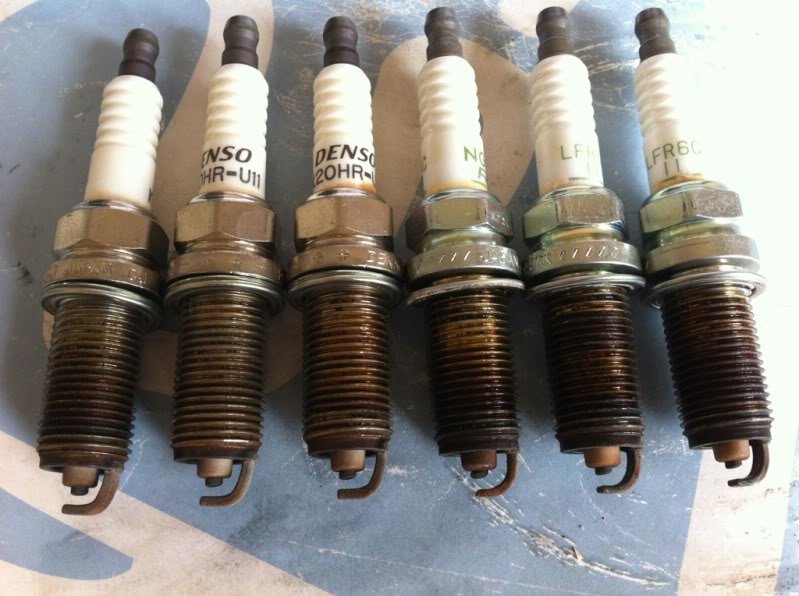

    Here are the stock plugs - 3 Denso on the pass. side and 3 NGK in drivers side, just like Chris said. These were the original factory copper plugs, and they have 92,000 miles on them. Only one of the plugs looked to have any significant erosion (#3 from right, which came out of the driver's side rear cylinder). Anybody have a guess as to why that particular plug was more eroded? Another thing I noticed was that the overall condition of the NGK plugs was worse than that of the Denso plugs. You can tell that just from the photo:
