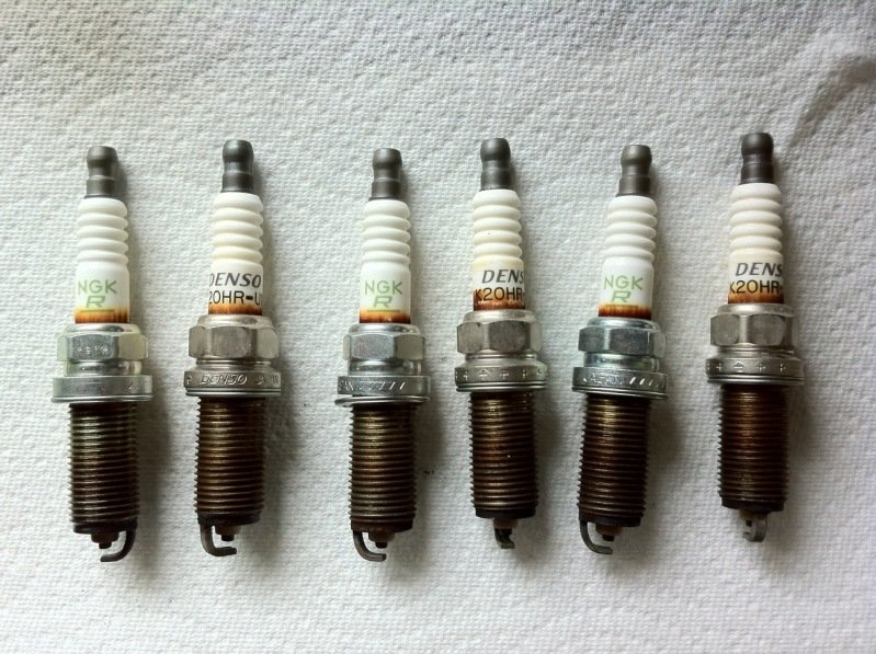

    Just did mine today @ 29,600miles here is what I pulled out. Highly recommend doing it at 30k. My FJ was the same when I did it in terms of half denso half NGK. Replaced with all denso's.
