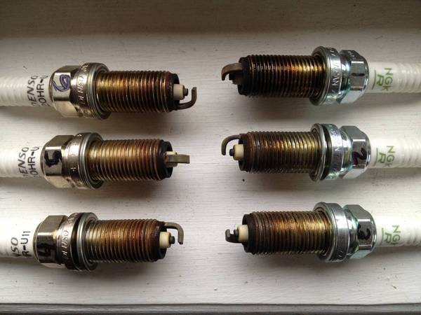

    Thanks for this great write-up Chris!! Me and a buddy of mine both did our trucks at the same time and it took us just over 1 hour to get both trucks done so it was super quick!! :D Here is a few pics of my plugs and I procrastinated and didnt change them at 30K. These plugs have just over 50K miles on them.
    Driver side is on the left. They look to be a little more used and abused.
    Driver side
    Passenger side

    Look like my old ones. :D
