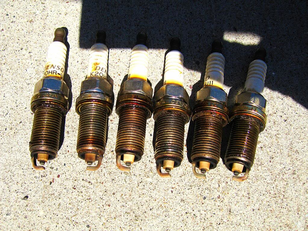

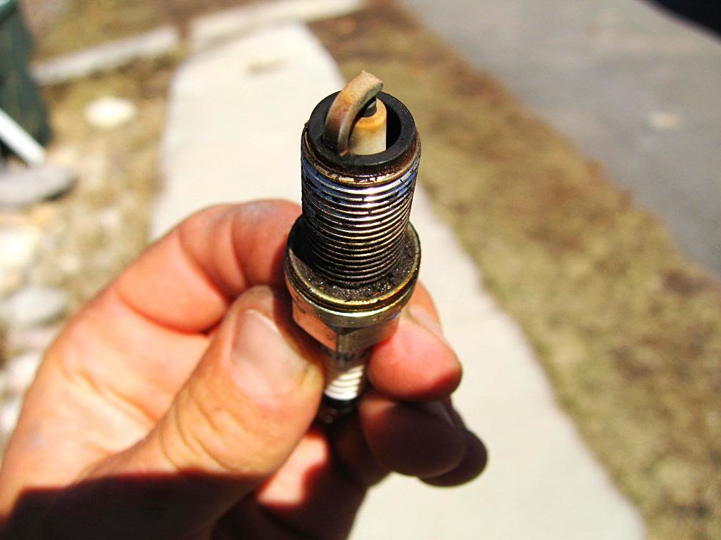

    Did the plugs again today, took a little over an hour. Plugs had 29K on them, 1K early but I had some spare time today...and not much in the near future.
    They looked pretty decent to me, some of them had a little bit of build up around the crush gasket though, and most of them had fairly oily threads. Engine almost to 100K:cool:
    Do they look decent to everyone else? How about the oil on the plugs...normal?
